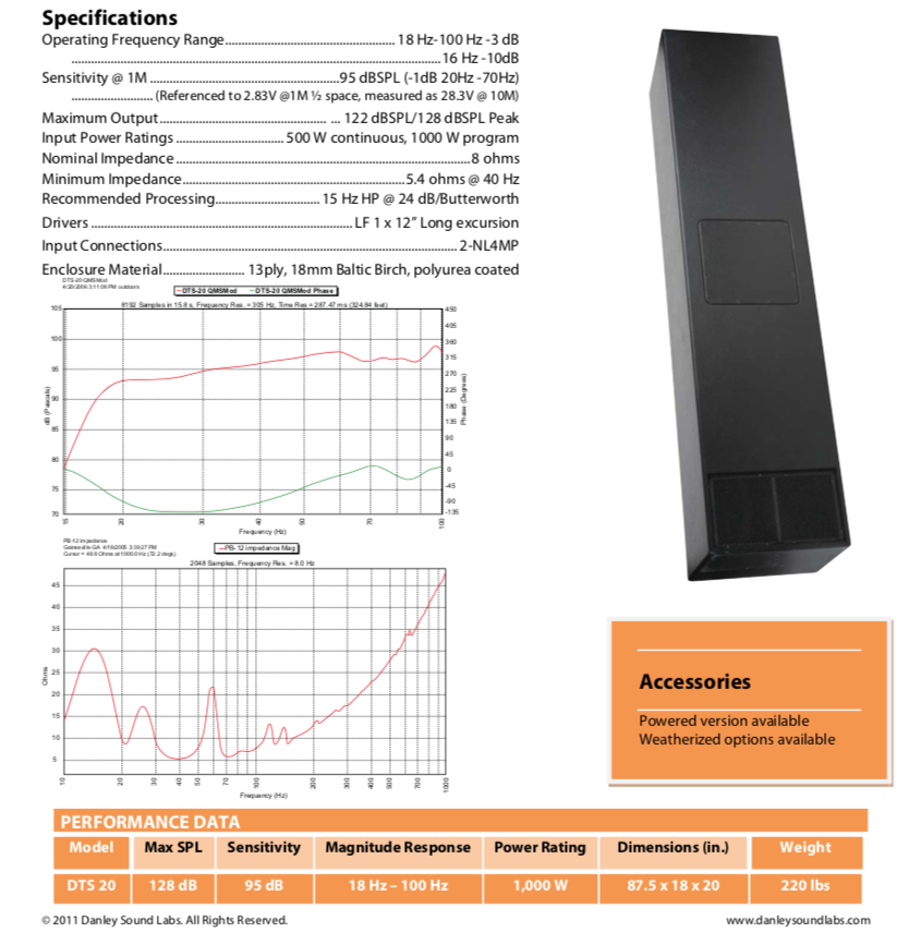

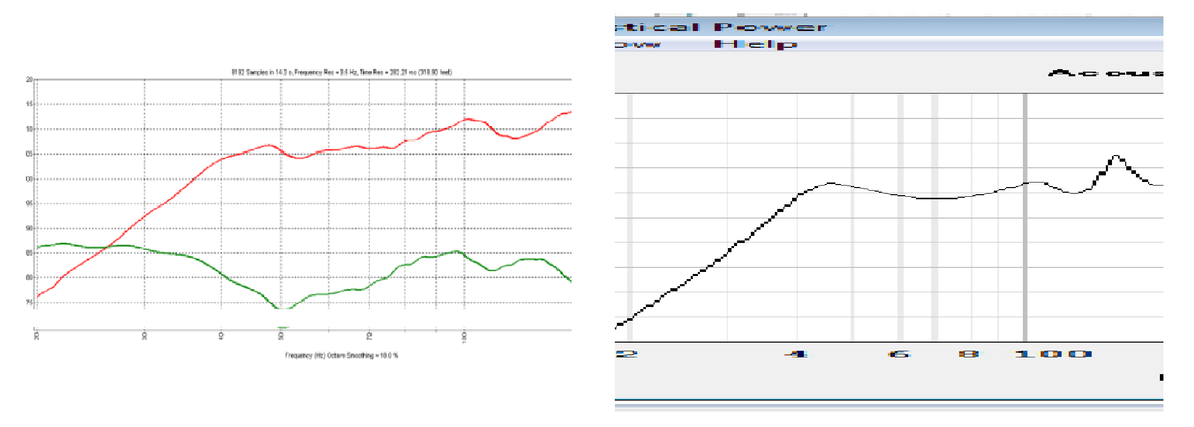

Every Horn resp plot I've seen is similar to mine here; three lumps. One around the tuning frequency, one a bit further up, and then one big jump between about 110 and 150hz.
Whereas the danley graph shows a much more even rising response.
Hornresp does not include the effects of losses in its TH sims. You can simulate the effect of the losses a bit by adding a tiny bit of stuffing to each section in the sim.
Chris,

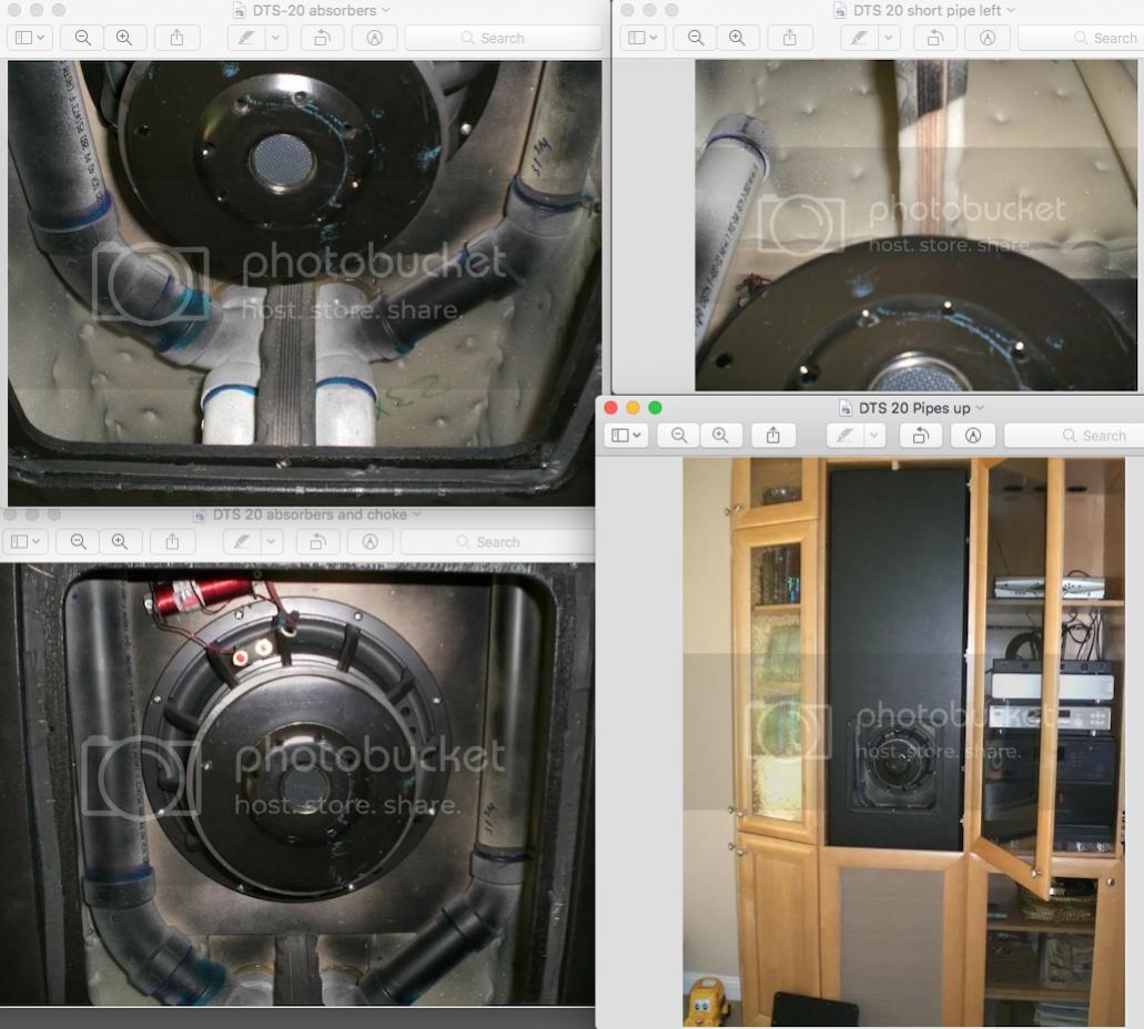

Danley does use absorbers in some of his TH designs, but not in any so far discussed in this thread.
Art
This was a fun and Mind opening experiment where the entire skinnier /shorter stuffed section (as an offset stub) was looked at both as Empty/ bare and then stuffed (and the layout matched the upstream and the folding by a direct proportion so it was kind of unique in the affect and where it created and resolved the issues and before this stuffing for me was just ‘random and to taste’.. but the it was much more fun/intersting like a much more ‘precise’ tuning tool for me?
In this form it has a very poor mud band response and it was canceling its own as you can see the Goofy driver location and distance away from the closed end of the larger area and tap entry to exit after motors.. it is a mess of all that pressure /velocity change that occur all over that zone in freqs.. but in the end it worked out really really nice(but still, thats all wasted space not ever needed to be there originally. Just a way to look at try to …).
