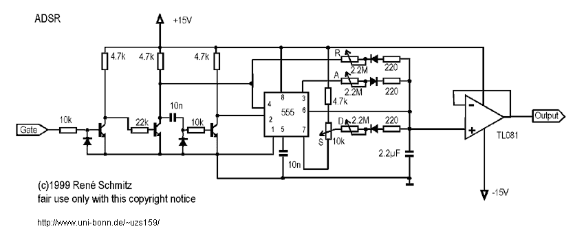

I have wanted to have ADSR filter for some time now but I was wondering if anyone here had advice or experience regarding this subject before I get started.
For those of us who don't know, an overview of function and theory is here: ADSR envelope - Wikipedia, the free encyclopedia
As a gained interest about this, I wondered how hard it might be to make one of these. A google search later and I came up with this site. Synth Schematics --::-- Envelope Generator ADSR
The second schematic has my preference as it looks simpler and is recommended on the above page.
Does anyone know what model transistor should be used in the first part of the circuit, or if it even matters?
Also, I've heard that certain diodes can greatly impact sound characteristics, is it a good idea to make the diode selectable with a rotary switch of some kind or am I reading too far into that?

You want to build something like a Moogerfooger to process guitars and other audio sources? Then you should instead use an envelope follower circuit to translate the audio signal amplitude into a control voltage that will modulate the filter cutoff frequency. An ADSR generates control voltages but it still needs to be triggered externally.
Regarding the sound of diodes, the germanium types are prefered in the old ring modulators. Since an ADSR doesn´t generate or process audio directly, it doesn´t call for any "better" than a common diode such as 1N4148.
You´ll find lots of schematics and good advice at the DIY section of the Electro-music forum.
