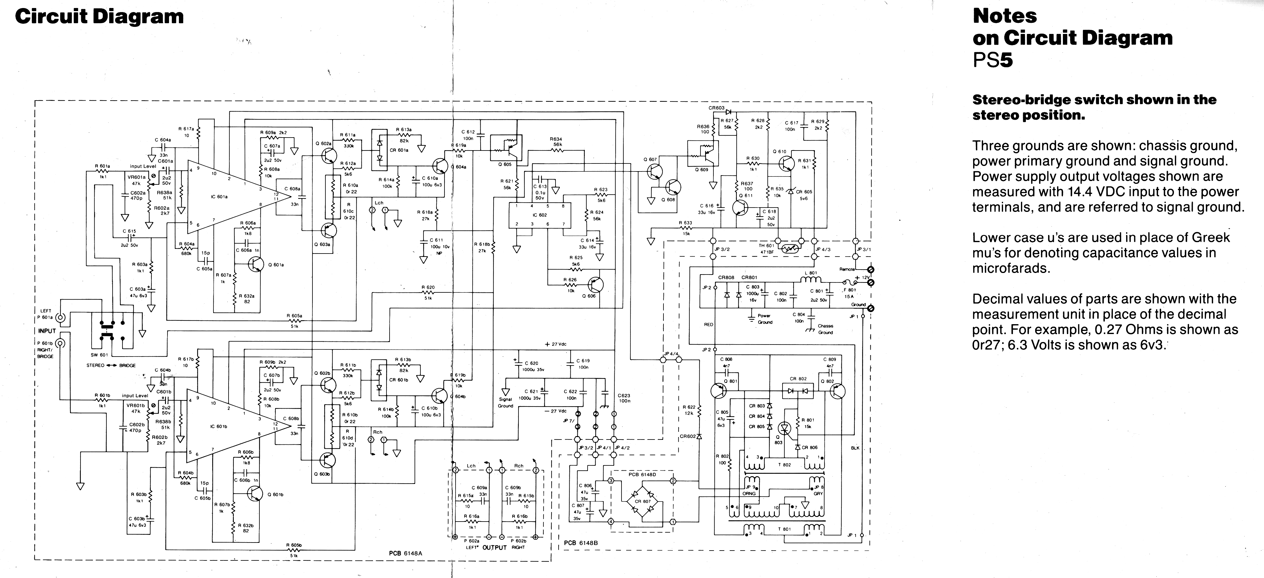

I have an ADS power plate 120 with turn on problems. When turned on the power supply just has like a one second pulse, like burst or spike and the goes to zero volts, voltage does not go to high either. Not sure if the amplifier is in protection or power supply itself is bad. looks like it is a self oscillating power supply. any help greatly appreciated.

I think it is a self oscillating power supply. No i.c driver on the power supply PCB, perhaps maybe i.c is in the output . It is a very simple power supply but not easy to trouble shoot. I'm going to check output tonight, thanks for help.
The attached diagram is from a PS5. Is the power supply similar?

If you're referring to the UPC1237, the following are notes I started on but didn't confirm 100%. Someone should correct them if there is an error. If you find something different in your amp, post what you find.
Pin 1: overload detect (must be below 0.7v -> generally at 0v)
Pin 2: DC offset detect (must be between +0.62 and -0.17 -> generally at 0v)
Pin 3: reset mode (grounded to require that power be cycled to re-engage relay)
Pin 4: AC detect (must be above 0.74v)
Pin 5: ground (measure other voltage with reference to this pin)
Pin 6: ground for relay (near ground to engage relay, near supply voltage for relay during mute/protect)
Pin 7: mute delay (must be above 2.06v)
Pin 8: supply (generally between 3.0 and 3.8v)
thanks, I did, but apparently in the wrong forum as I posted in chip Amps and was directed here. But, finding this schematic, I think I may have been testing rail voltage wrong, so when I get home, I will test it the correct way which I think is one probe on the pad where the two caps join that come from each leg of the rail voltage coming out of the rectifier. Then I can update with some better info and start another thread there.
