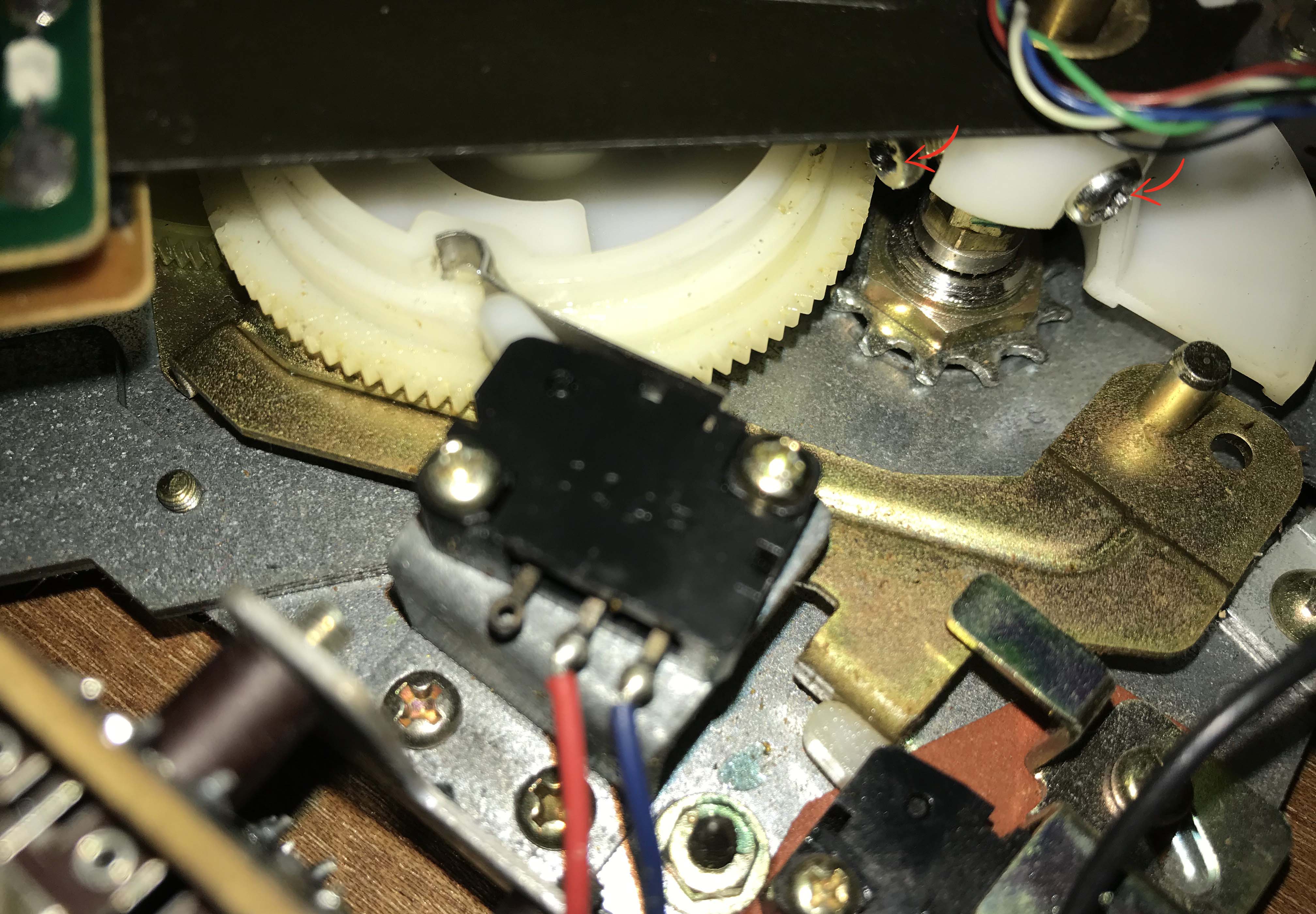

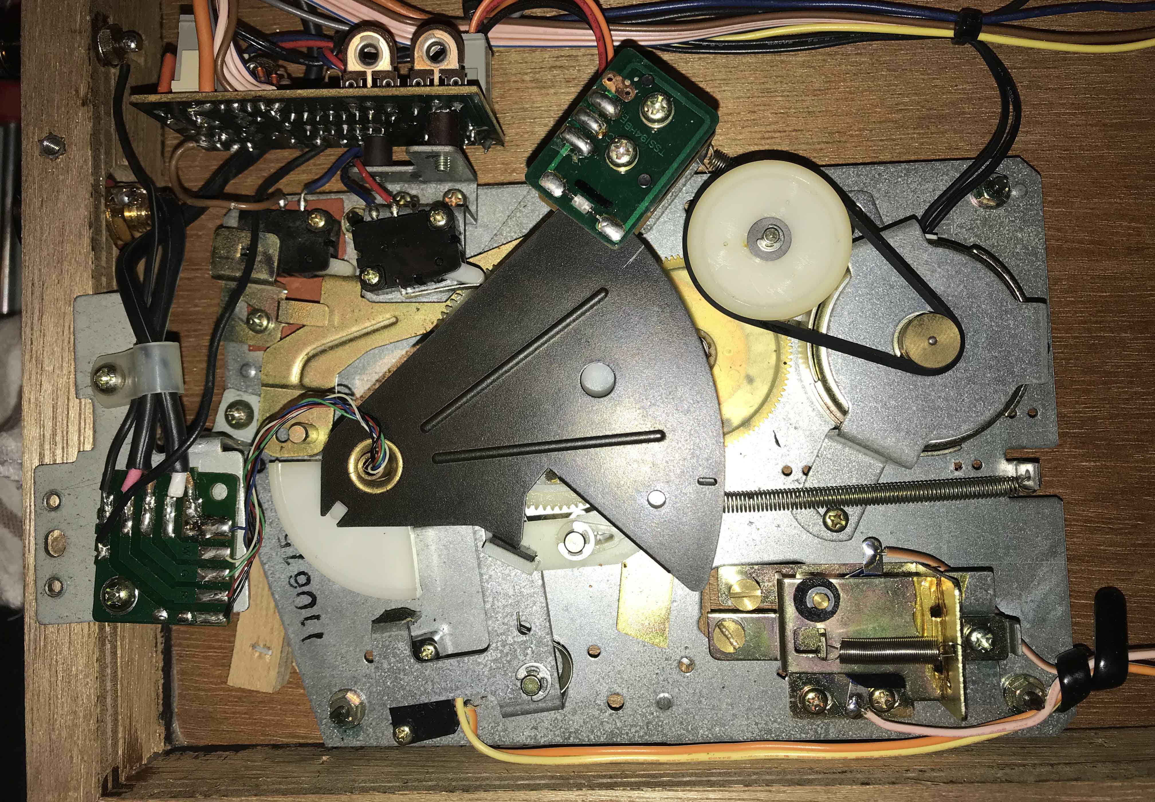

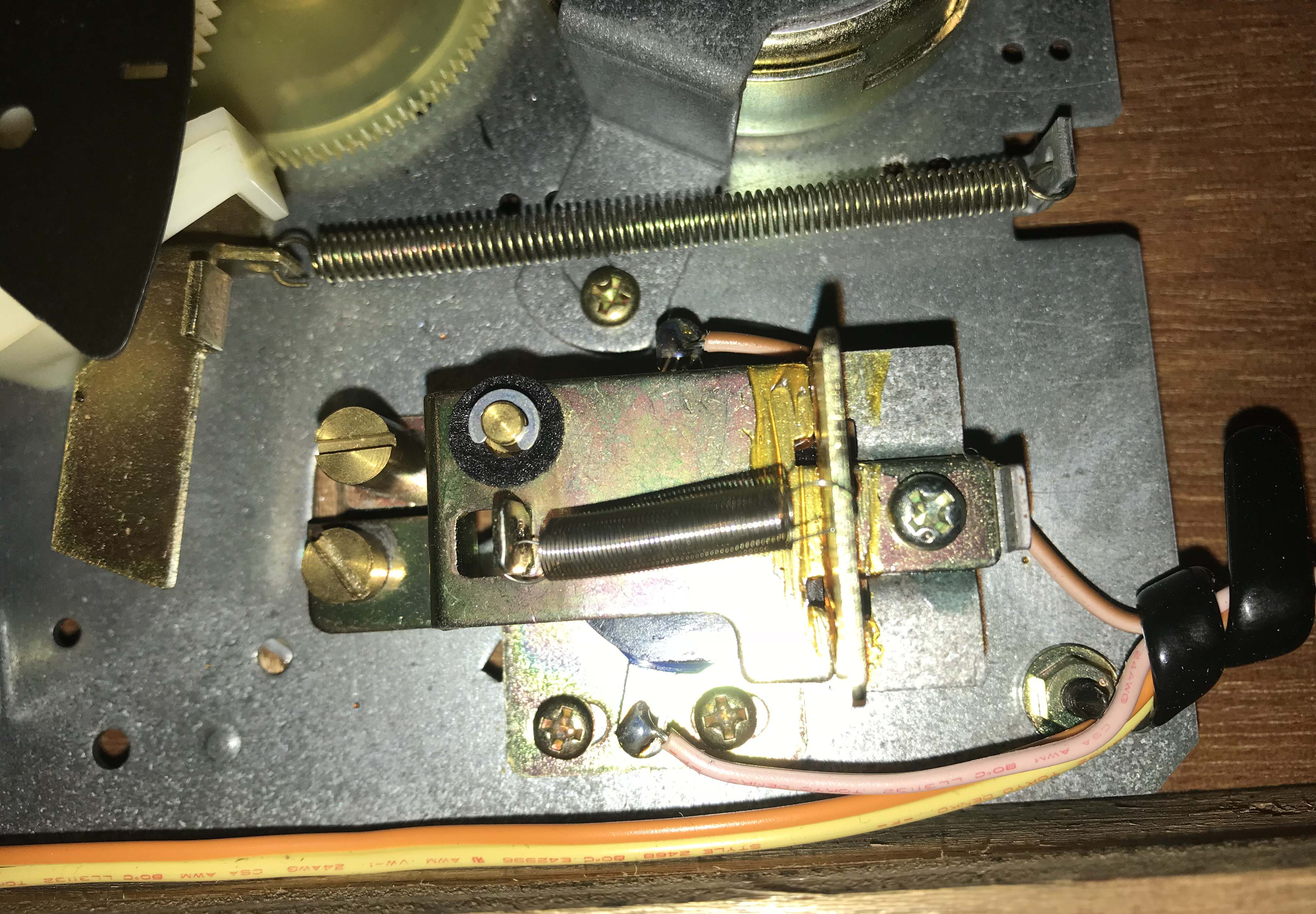

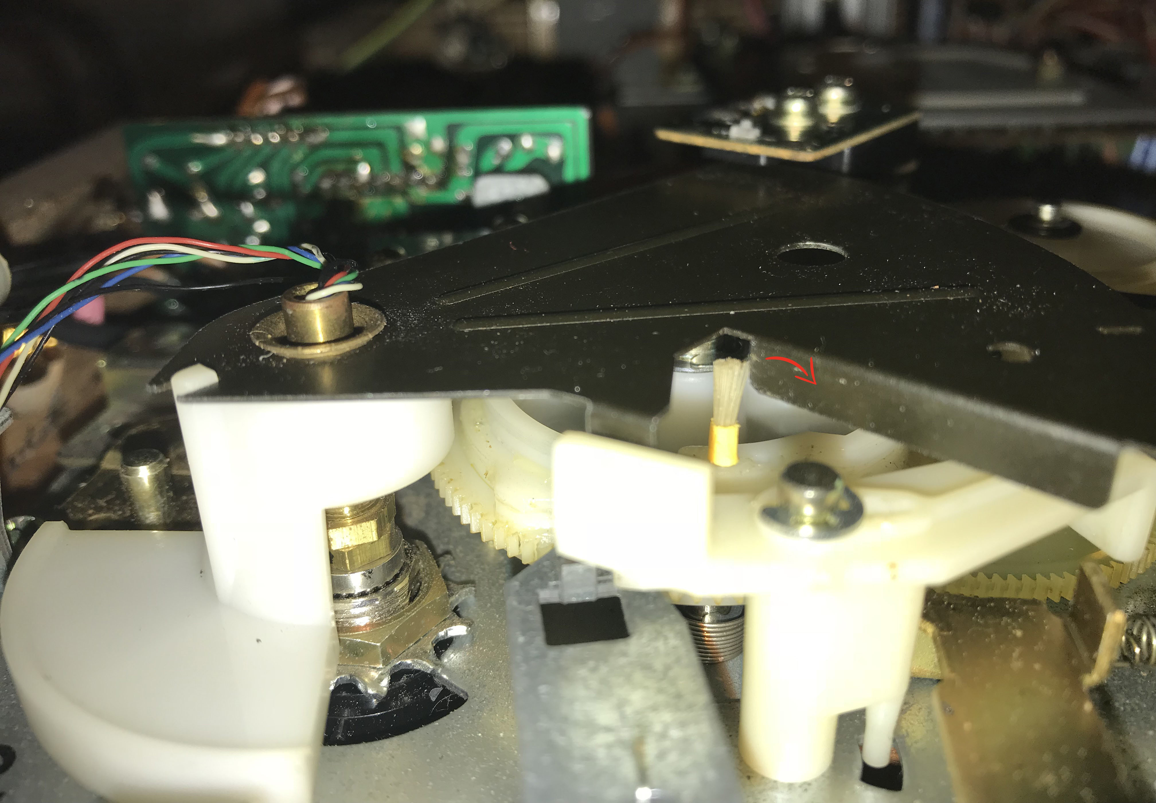

I finally managed to fix both the lead-in and lead-out. Problem was that I had to put the black plate as far back as possible, to make the lead-in come as close to target as possible. This made it so that the optic sensor didnt reach the hole in the plate at the end of the record for the return function to engage.
The eccentric adjustment pins didnt do enough, the closest I got was about 15mm from target. The solution was actually very simple. I took a small rubber wheel and placed it on the lead-in pin that pushes the white plastic quarter circle thing. This made the lead-in reach the target and beyond. So I moved the black plate a little forward again, fixing the return problem, and finally fine adjusted lead-in with the eccentric pins. Everything works perfect now🙂
