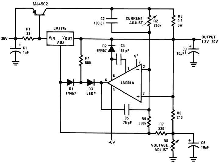

Hello, I have a few newbie questions about adjustable power supply. Shematic is taken from National's LM117 datasheet for 5A constant voltage/constant current regulator.
- They are using LM317K - in TO-3 package. Can I use normal LM317T instead, because K is some 8x more expensive and they are both rated at 1.5A?
- What should be power rating of resistor R1?
- If I want to make it for 3A, could I use BD250C instead?
- Is LM301's V+ connected to +6V since V- is to -6V?
- What's a good replacement for 1N457, 1N4148 maybe?
- If I want to make negative regulator, except using LM337, and MJ802 (or BD249C), what else should I change? Should I reverse some diodes, or switch + and - inputs of op-amp maybe, or something else?
Thank You.

;) The Current LIMIT resistor is 0.33Ohm - makes 2A go into LM317K
0.7v /0.33ohm= 2.12Ampere.
For LM317T (TO220), I would make R= 1.0 ohm
Gives max 0.7V/1.0= 0.7 Ampere in LM317

LM317T is fine.
#2
Halojoy mistakingly it seems thought it was 0.33 Ohms and that all the current would go through the reg. It seems is is 33 Ohms which seems more reasonable. The power rating is (based on the fact that the voltage over it is the forward drop of the transistor) P= U*I = U * U / R = 0.7*0.7/33 = 0,015 W which means take whatever you have but a standard metal film is perfect.
#3
Yes, BD250C would probably be OK.
#4
Don't know...
#5
I think that would be OK.
#6
A bit more complicated. Why not make 2 identical and connect in series?
UrSv is mistaken.
Why On Earth would you Use a TO3 REgulator
for to pass only 0.700/33= 21mA.
If the regulator had been LM317L in TO92, i would have guess on 33 ohms and 20 mA
I beg my pardon or yours....
Hope you can give me an answer....
I do not think you have done your math alright
dear friend UrSv
/halojoy is right! 0.33 not 33 ohm, is what it is in that schematic

I think they the TO-3 because it is an application note and that is the regulator in question. The regulator is NOT used as the main current provider but as a regulator (suprise?). I have downloaded the datasheet again and looked closely and as far as I can see the resistor is 33 Ohms just as clearly as in the picture posted earlier.
As for #6 I would not be the right person to tell you how to do it and if I did then it would take a long time and most likely be incorrect. I do have a basic knowledge of electronics but I have clear limitations...

You must also take care of the opamp power supply, indicated as "-6V" and "V+". Since the output and inputs of the LM301 float up and down with the output voltage, the supply should be referenced to the output voltage I think. Did the app note say anything about that?

I believe halojoy is right about the resistor being 0.33 ohm, this fits in line with the usual "current dumping outboard transistor" attachment to 3-terminal regulators. However, his calculations show that an LM317K should be used, since only this will allow the rather large power dissipation caused by 2A of current. A 33ohm resistor would allow only a small current to flow through the LM317, which would cause the circuit to oscillate if sudden transient loads appear at the output, as the LM317 and the pass transistor try to figure out who's doing what.
There may be one way to settle this: we could mail maybe Bob Pease or someone else at National and hope they have the time to reply.

I believe UrSv is correct.
The LM317 is not meant to supply much output current - it is there only to set a voltage reference to drive the pass transistor. High load currents from it would negatively impact load regulation of both it and the pass transistor's output voltage.
To help show in a simple way that the LM317 is not supply any load current, consider the current sense resistor, R3. Note that it is in series with the pass transistor, but not the LM317. If the LM317 were putting out up to 40% of the current, as Halojoy claims, then none of its up to 2 A current is being monitored by the current sensor. This does not make sense! Since the LM317's output does not flow through the current sensor, the logical conclusion is that it does not supply any significant load current at all.
There are other reasons to show the circuit, as shown, is correct, but I feel this one reason is sufficient to show that the regulator is not intended to supply load current.
Of course, the regulator does not have to be a T0-3 as the current demand is very low. We have to remember that this circuit has been around for some 25 years. Back then, TO-3 packages were nearly as cheap as TO-220's and even TO-39's (remember them?). Even a TO-220 is overkill here, but that is still what I would probably use.
OK, Jeff and UrSv, maybe the regulator does serve as a reference. I've never managed to understand how outboard pass transistors work, could one of you explain? From my understanding, the outboard device works as the second half of a complementary feedback pair. Is this right? My previous post was based on a similar circuit I had seen in a "circuit cookbook".
Shouldn't it also be possible to get the output to go all the way to zero if you connected R8 (adjust pot) to -6V in place of ground? Maybe there should be another resistor b/w the pot and -6V because the lowest voltage at the ADJ terminal is -1.2V to make it output 0V.
Another question: I've not used opamps that require compensation, so what's with D2? C5's function is also a bit of a mystery to me.
Addressing rendisha's question about the opamp's supply voltage, it can be the output voltage only if you use an opamp which tolerates its supply voltage at its inputs. LM301 seems OK (from the datasheet), so you can connect it to the output voltage. Anyway, the opamp's function here is to rob the LM317's ADJ pin of current when an overcurrent condition occurs, through the diode and LED. It's probably best to have an auxilliary +/- 6V supply for the opamp alone.

To understand the outboard pass, assume that initially the pass transitor does not conduct. Now you put on a load, and the 317 starts to supply current to the load to keep the output voltage up. This current flows through the (in)famous R1 (33 Ohms). When the current reaches about 18 mA, the Vbe of the pass transistor gets high enough to cause Ic to flow, starting to add to the load current. If this current is not enough for the set output voltage, the 317 will start to conduct more, which in turn will turn on the pass transistor more etc: the output will be regulated.
BTW, I agree with the analysis that the 317 only suppllies a very small part of the total current. Why it is a K-version, beats me. The small price difference between TO3 and TO220 in those days may indeed have something to do with it.
