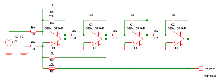

well, one may call it a subtractive filter, since the HP ist generated by taking the difference of Input signal and Lowpass (TFhp=1-TFlo).
On the other hand is the TF of the Lowpass generated by ´analog computing´ or state variable function.
If only there were a 2´nd order HP!?!
The somehow weird thing with this kind of filter is, that all depends on each other. Without the integrators there wouldn´t be any HP function, which -integrated a couple of times- results in the corresponding LP.
So, no HP wo LP and no LP without the HP.....sounds a bit like a dog chasing its tail, eh?

Anyways, i've updated the schematic and pcb, which both can be found on:
ActiveCrossOver - Adjustable active 24db LR crossover
in the eagle 6 format (ltspice files as well!) For convenience, here's the images of both:
What do you think of this pcb design? Any good for this? Comments and Critique *warmly* welcome!
As a sidenote, the R11-R14 are drawn as verticalized resistors because i wanted to use those 2-pin-ic-socket-like-thingies so i could just plug 4 new resistors in to change the crossover frequency ...?
Thank you so much for your help up to here . Regards
- NebuK

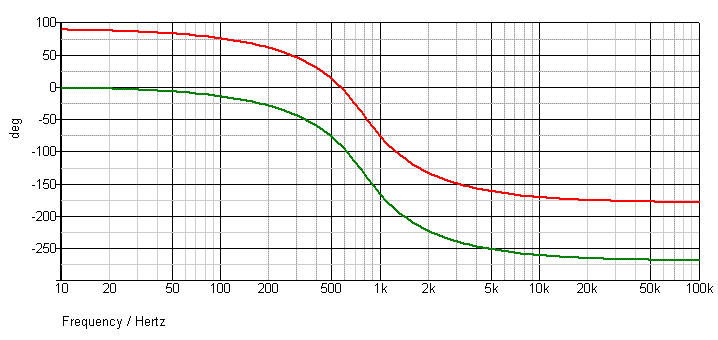

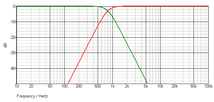

I don't follow the math, but the idea seems to work fine for odd-order filters as well. Here's a nice simple 3'rd order Butterworth.Mathematically they exploit the fact with filters of even order (2nd, 4th, etc.) the denominator of the transfer functions of Highpass and Lowpass are the same. The TFs only differ in the numerator.
On second thoughts, I don't see a reason for low frequency oscillation. Was it high frequency instability or low frequency motorboating? Roughly what was the frequency of oscillation?While the filter worked well at frequencies of a couple of hundreds Hz on, I sometimes got oscillation effects with low crossover-frequnecies.
It's probably a good idea to increase the capacitors then, perhaps to 100nF. IMHO, a good rule of thumb is to keep the resistors between 10K and 100K.I would like to use this circuit as a base for subwoofer crossovers, so crossover frequencies at 50-100Hz should be possible.
