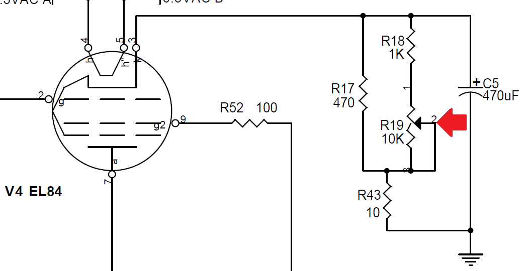

I just want to share a mod of cathode bias, that I have good results on my Dynaco SCA-35. It will be equivalent to "fixed bias" without the need of negative power rail.
You need one this mod for each single tube, so that you can adjust bias point of each single tube.
Q1 needs to be medium power transistor such as DB140 to dissipate the heat.
