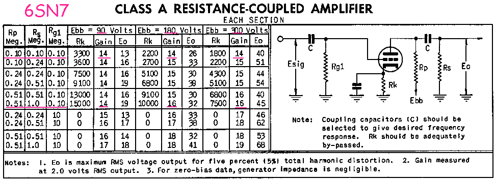

FWIW, Forum member PRR kindly posted:
6sn7-gain-gif.608007
which is datasheet recommendations, but again,yours should still work fine, those are not outrageous values.
