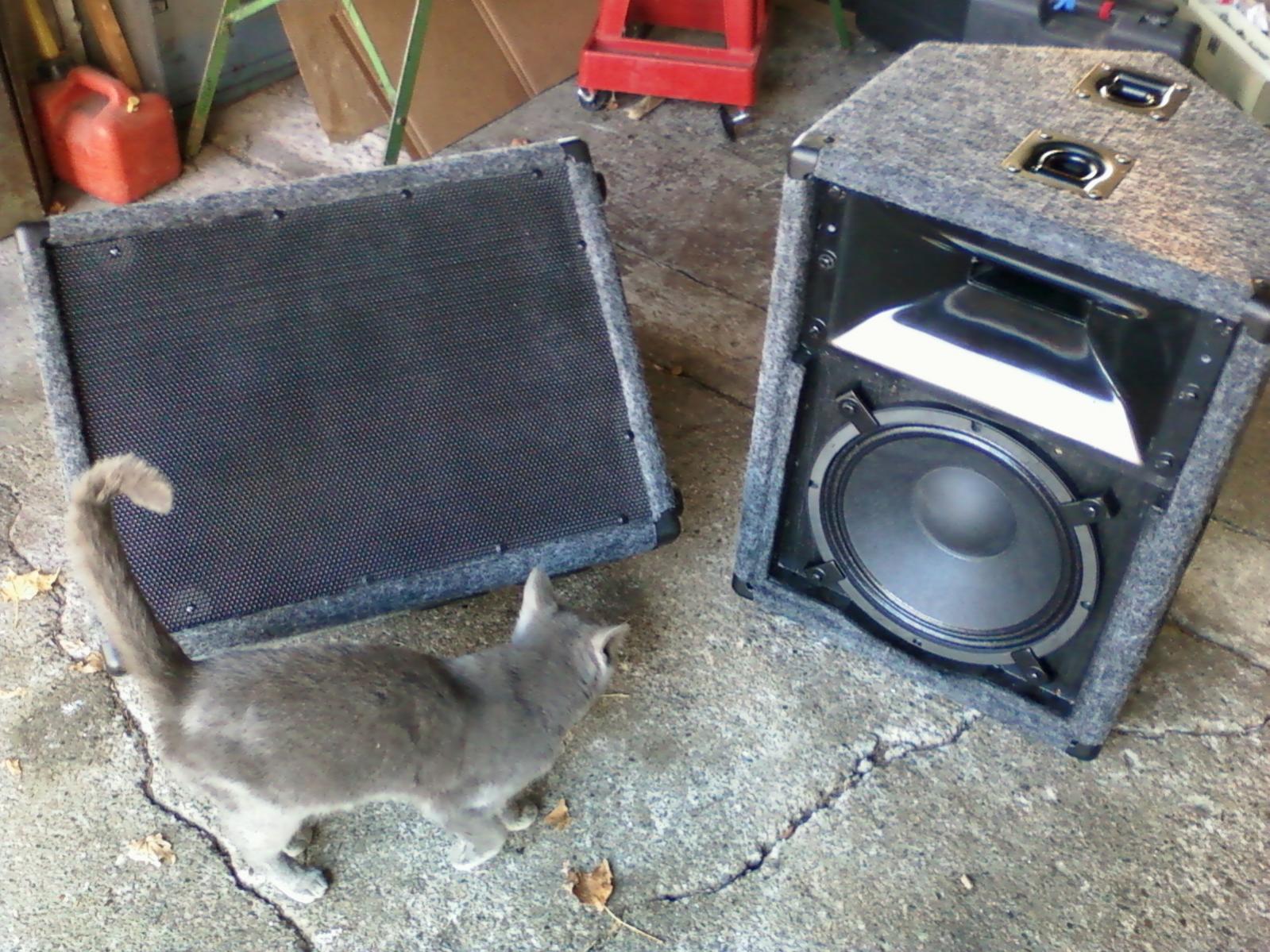

I've covered many cabinets with carpet using brush on contact cement, however the last pair of speakers I just finished I used this
V&S #581 Foam & Fabric Spray Glue Adhesive 12 oz.
and it worked great, it saved a lot of time, bonds fast and strong. You spray it on both surfaces just like you would use contact cement.
Here's the finished project.
Mike, what horn is it? It looks pretty interesting.
Hello
It's a DDS CFD2-65
Attached is the spec sheet.
