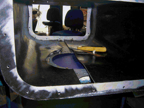

I am in the process (testing at the moment) of building some monitors out of steel.
Have used a layer of rubber inside (see pic, only shows when was being fitted). Seems to be working, not sure if used with something else than steel...
Any thoughts or comments?

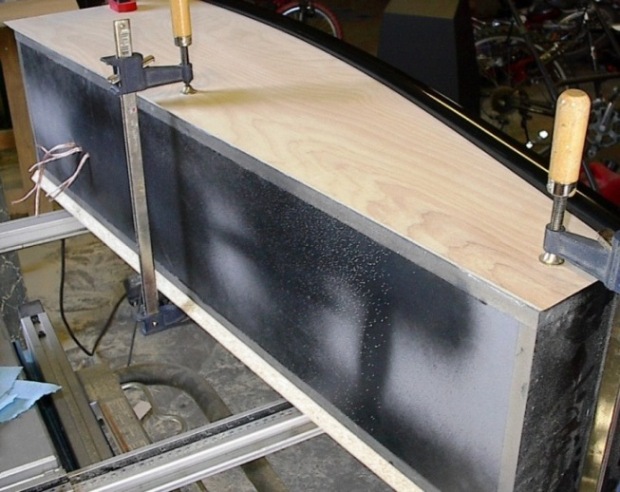

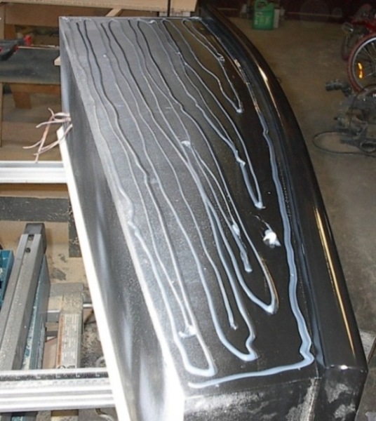

Mine wound up less than 1mm thick. The beauty is that the silicone strongly adheres the panels together, so all you need to do is apply light clamp pressure after you squirt on a few beads of the stuff.
