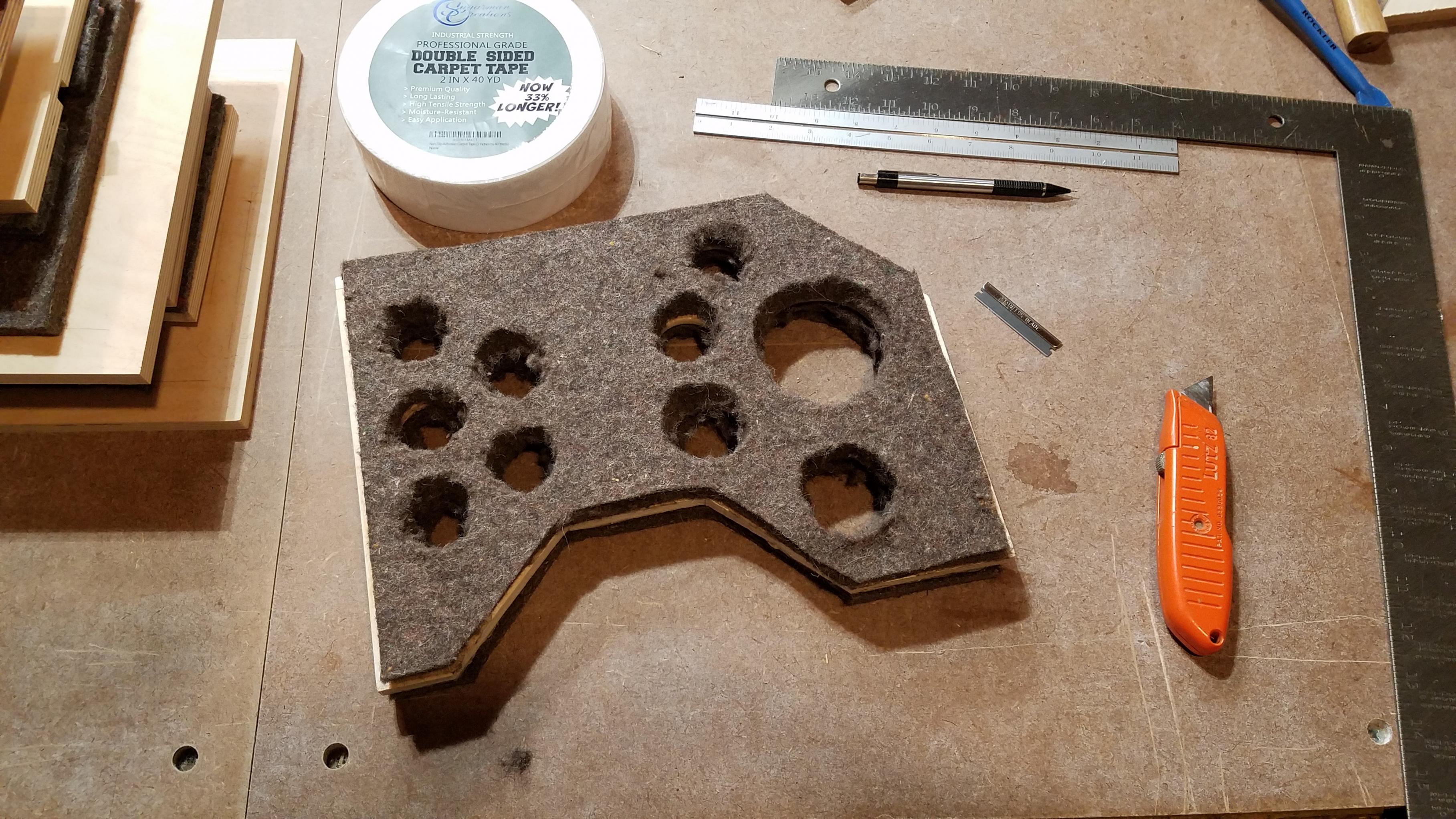

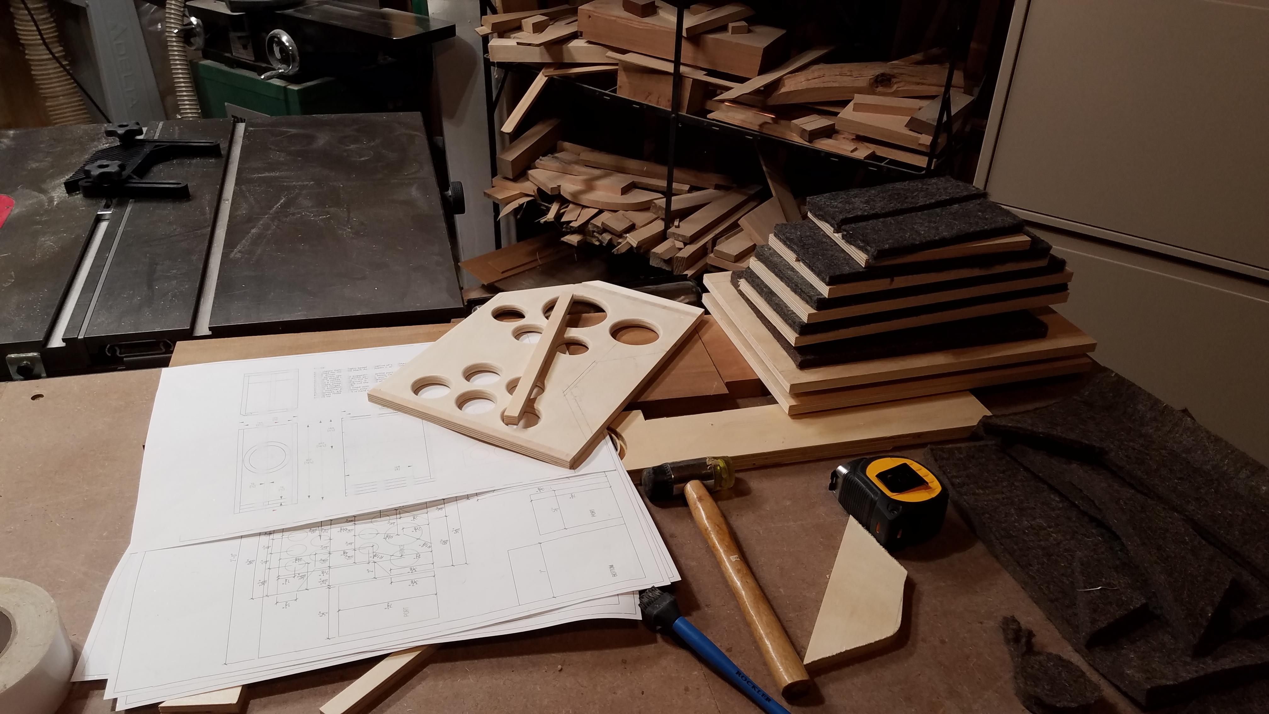

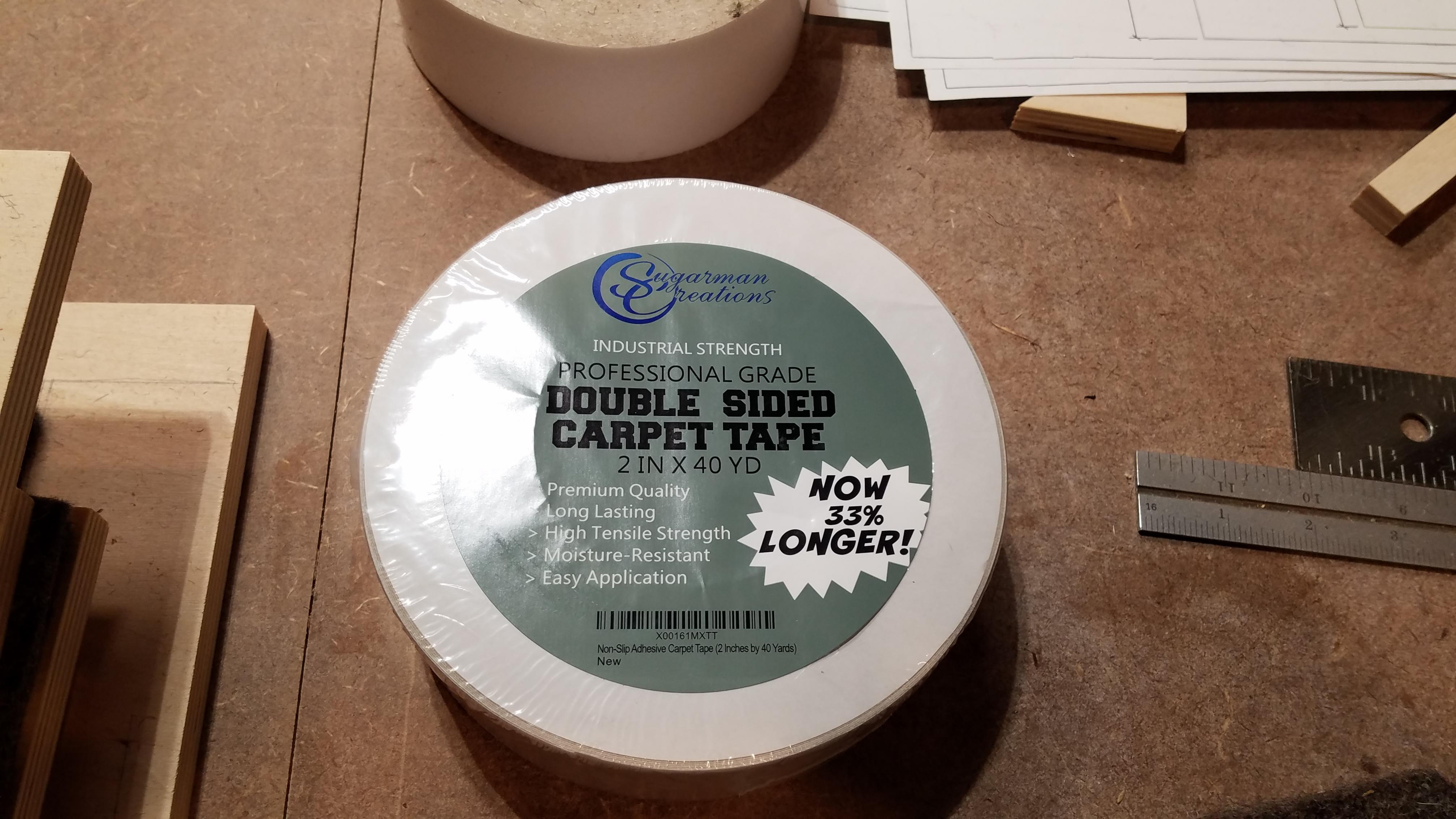

Thanks all for the useful options. I found an industrial strength double sided carpet tape on Amazon. See the pics. Just roll it on, cut & burnish through over the waxed paper cover, remove the paper, set the wool in place, lay a heavy book over the wool for a short time and remove. The wool is very secure. I purchased 1/2"x12"x72" wool from McaMaster Carr for $49.00 & change US. They have different sizes available and cost options depending in wool content, 75%-95% wool content w/ balance of artificial. The 95% is a gray color, the 75" is an almost black color. The density is greater in the 75% but both allow the same amount of air to pass through. You will go through a lot of razor blades cutting through the wool for the baffles so be prepared, It does cut a good straight line though. Circles are a study in patience. now it's just finding the time to put it all together.
Thanks again...
