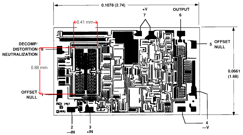

AD797 model
So my home brew model using MAT02 as input devices (see: http://www.diyaudio.com/forums/showthread.php?postid=1814785#post1814785 ) was totally wrong. This (erroneous) choice was only based on the noise figures.
Looking at the sizes of the MAT04 transistors seems to be a better choice. How about that?
Below the (estimated) sizes of the AD797 input trannies and in the next post the sizes of two MAT04 trannies.
Edmond.
scott wurcer said:A major interest is log conformance over many decades of Ie not necessarily audio. An oxide isolated process would help but I doubt if the economics would justify it. The price of the cans is also an unfortunate economic necessity. The input devices on the AD797 are far smaller than this, almost an order of magnitude or more I should see if I can find a pic.
