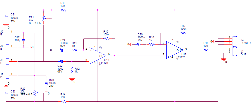

Noise measurements
Here's the noise measurement results.
I choosed a selection of bipolars, 10 each, some of them are well known low noise devices (LN), some are medium power devices with no noise spec in the datasheet (MP), and finally some are general purpose devices (GP). All devices are NPN only; the PNP pairs are still to be measured (I need to build another jig with reversed polarities) but usually PNP devices have lower noise.
I decided to build a small test jig, following the attached schematic. It's very simple, two low noise opamps gain stages, each with a gain of about 101 precise gain was measured using a 0.035% 1:10 MAX5491 resistive attenuator at the input and a HP3457 precision voltmeter. The Ic and Vce are set by the two 25K multiturn resistors.
After playing a little with the jig I somehow arbitrarily decided for a frequency of 5.8KHz. This is low enough to be in the amp bandwidth but high enough to avoid the flicker noise region (in particular for some MP devices). Opamps are LT1128 (AD797 was also successfully tried).
All measurements were done at Ic=1mA and Vce=6V. Noise density was measured by a HP89410 DSA. Before anything else, I measured the jig amp noise by shorting the collector and base terminals. This rendered an output noise of 53.4uV/rtHz, which maps to a 5.2nV/rtHz at the amp input. About 4.4 nV/rtHz are originating from the two 1k feedback resistors, which leaves a residual (opamp plus the rest) contribution of 2.8nV/rtHz.
For each device type, I measured and averaged beta. The resulting output noise Vn0 was also averaged over each 10 devices. Vni was calculated by using the measured opamp stages gains and the transistor stage gain gm*Rs, where gm=Ic/Vt and Rs=1k||9K (9k is the collector multiturn resistor setting Vce, all resistor values were measured accurately).
Rbb was calculated by solving the quadratic equation (assuming Kf=0). Here are the results:
Model Scope Beta Vn0 [uV/rtHz] Vni [nV/rtHz] rbb [ohm]
2N5551 GP 131 470.4 1.41 104.5
2N5210 LN 350 668 2.01 227.9
2SC2909 GP 155 490.8 1.47 115.4
2SC2362 LN 188 518 1.55 130.5
2SC2240 LN 174 322.4 0.96 41.5
MJE15030 MP 88 216.13 0.63 10.1
KSC3503 MP 107 245.7 0.72 17.6
2SC3601 MP 135 178.1 0.51 1.9
2SC2547 LN 274 176.8 0.51 1.7
Comments:
- Some of well known low noise devices are not that great at all; a bitter dissapointment was 2SC2362.
- I can barely understand why 2N5210 is defined as a low noise device. It was in fact the worse of all, worse than the popular 2N5551.
- As expected, the medium power devices are a strong contender; MJE15030 (8A/150V) has a rbb of only 10ohm, but a rather low beta and also the highest 1/f noise corner frequency of about 1KHz.
- Although the average rbb for the cheap MP KSC3503 from Fairchild is much higher than I originally determined, they are still very good in terms of noise. For pennies, you can't do better.
- 2SC3601 qualifies probably as the best discrete bipolar I have ever seen; with Ft=400MHz, Icmax=150mA and now with a equivalent input voltage noise of only 0.51nV/rtHz, this Sanyo device is truly amazing. They are not cheap, though...
- Finally, 2SC2547, the Hitachi device, is the winner. Only 1.7ohm rbb and a beta of 274! (high beta and low rbb are conflicting parameters).
- Iteresting enough, for 2SC3601 and 2SC2547 it is NOT rbb that dominates the noise, but the 1/gm term; increasing the collector current will allow lowering the noise even further (this is what I am planning to measure next).
- I checked the Vni values vs. my old Quantech and got very good concordance.

Thank you Syn for that noise data.
I look forward to the remainder of your real world testing results.
I had already seen many recommendations for the 1085/2547 and 1407/3601 and had bought a few pairs. Yes, they are expensive.
The 2N5210 example does not surprise me much. The part, developed more than 40 years ago, always had fairly high Rbb' of 200 or more ohms. The PNP equivalent would be slightly better, as are virtually all PNP parts. However this device was designed for 20ua -100ua operation for lowest noise figure. This is typically what we used, in those days, for tape recorder reproduce or phono input devices.
