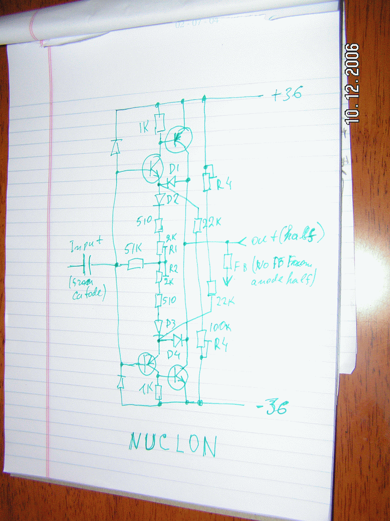

Hi Claude;
I am in love with diodes too.
Here is my unity gain complementary high power opamp (class AB version):
Edit: common point between R1 and R2 trimmers is grounded, of course.
It was an output stage of a hybrid amp, circa 1982
I used diodes because when it goes to self-protection mode (gradually increasing output resistance with decreasing of a load resistance) Vbe breakdown voltage is not enough to survive. Diodes are better.

Lumba Ogir said:Wavebourn,
your circuit was way ahead of its time. Hopefully, all diodes were 1N914B.
I would not say so. People were playing already with complementary opamps. I just simplified one a little bit, to fit in my particular need.
Diodes were KD213 (Russian high frequency rectifiers).
john curl said:What is the point, here? Why show this circuit? What are its merits?
Diodes sometimes are preferable to transistors, even on the places traditionally occupied by transistors. You may see on the picture a very powerful unity gain complementary opamp with diodes instead of transistors for an inverting input.
John, it is nothing to do with personalities. It is about solutions of electronic problems using different ways, please relax.
