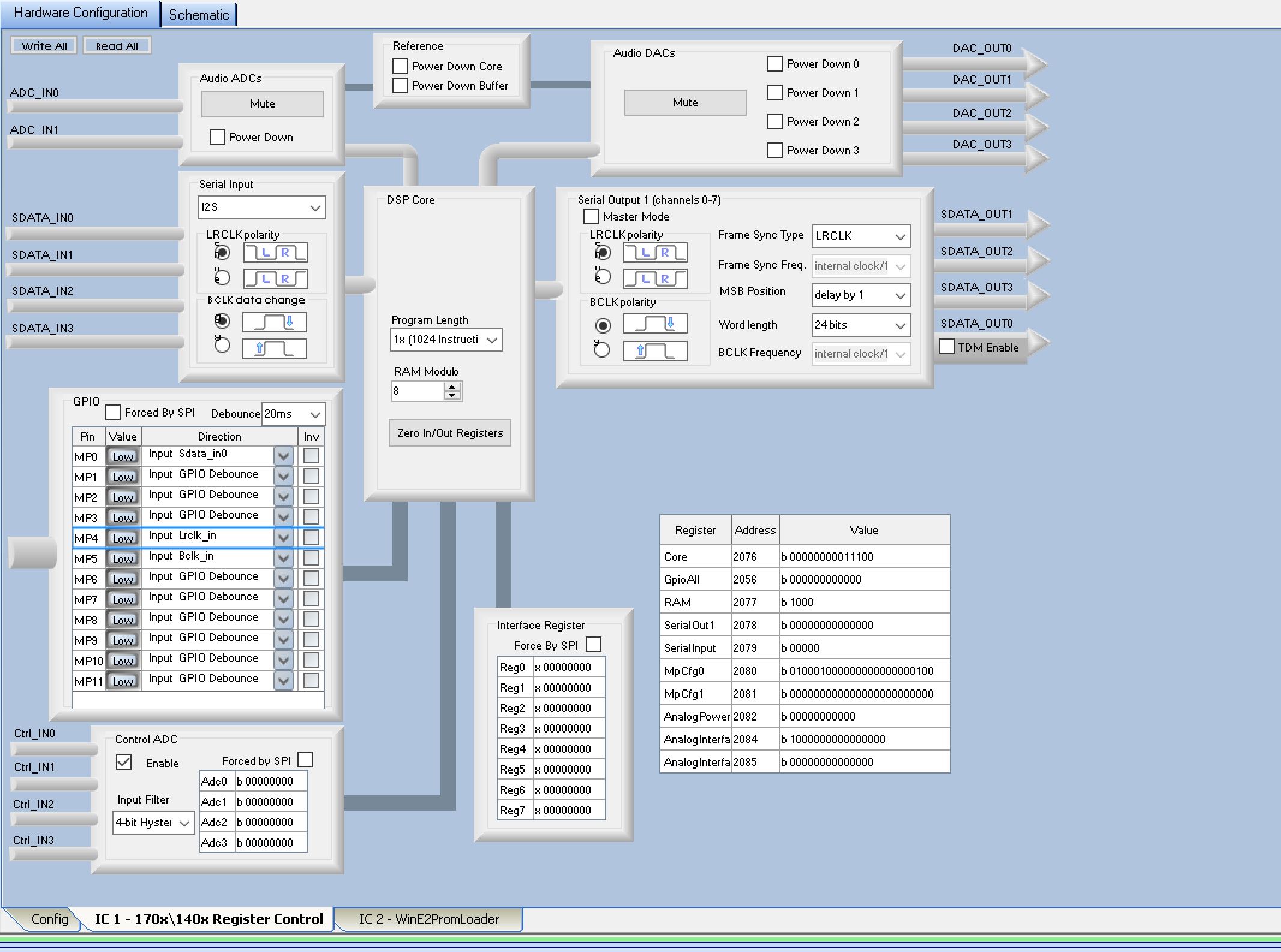

Do you know where to start to use the MP pins for I2S output?
In the register control?
Cheers!
Same point to start as with every device: Datasheet 🙂Awesome.
And yes, you need to enable the digital i2s in/out and define the pins for data and the clocks.

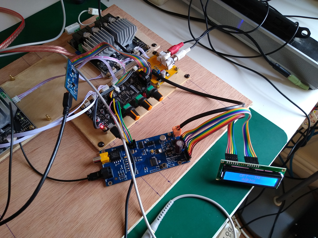

A somewhat less fruitful experiment, I attempted to get SPDIF input working as well using this board:
AK4118数字接收板 同轴光纤AES转I2S 采样率显示 支持I2S输入!超WM8805 - 音响HiFiDiY - 极DIY
which uses the AK4118A:
https://www.akm.com/content/dam/doc...nterface/ak4118aeq/ak4118aeq-en-datasheet.pdf
This board is configured to drive its I2S clock lines so I had to uncheck the DSP master mode. This resulted in audio output when routing channels 2/3 to the added output channels. However there is crackling distortion when high frequency is present (apart from weirdly if the SPDIF is at 44.1 kHz - wheupon there is no obvious distortion but it just didn't seem to sound right). Thinking about using this board I think I have made a mistake as there is no sample rate conversion between the SPDIF and DSP and so rates apart from 48KHz should not work and even with 48kHz there should be synchronization issues as the boards are not sharing a common clock?
ah it may actually be possible by running the 3E DSP from the clock of the AK4118A board as MCLK is 256xFS which is 12.288MHz which is the usual oscillator frequency for the ADAU1701 when FS=48KHz. So as long as 48kHz SPDIF is used it could be possible.
The 3E datasheet also mention that J2/J3 are in place during master mode but as the board is now a slave I should probably work out what they are doing.
J2 connects MP11/BCLK_OUT to MP5/BCLK_IN and J3 connects MP10/LRCLK_OUT to MP4/LRCLK_IN

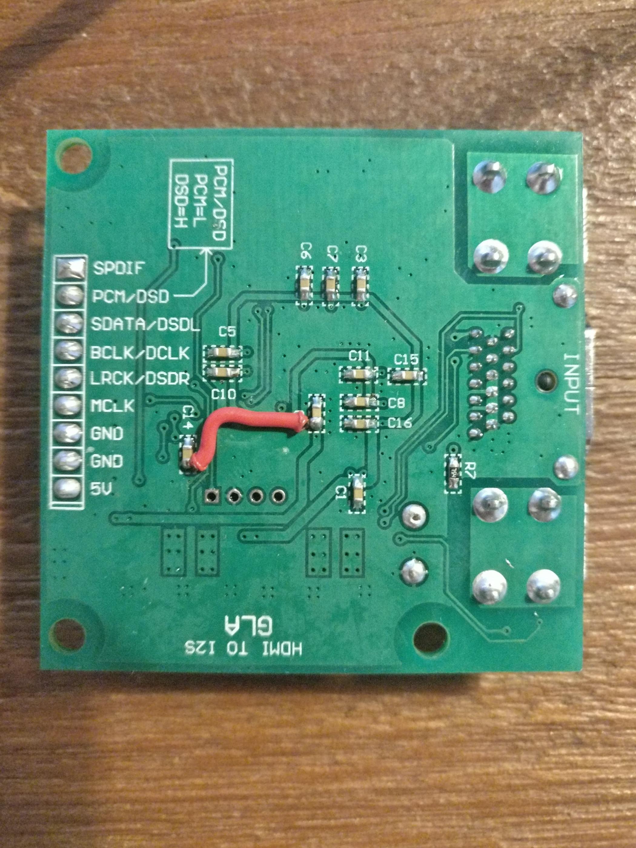

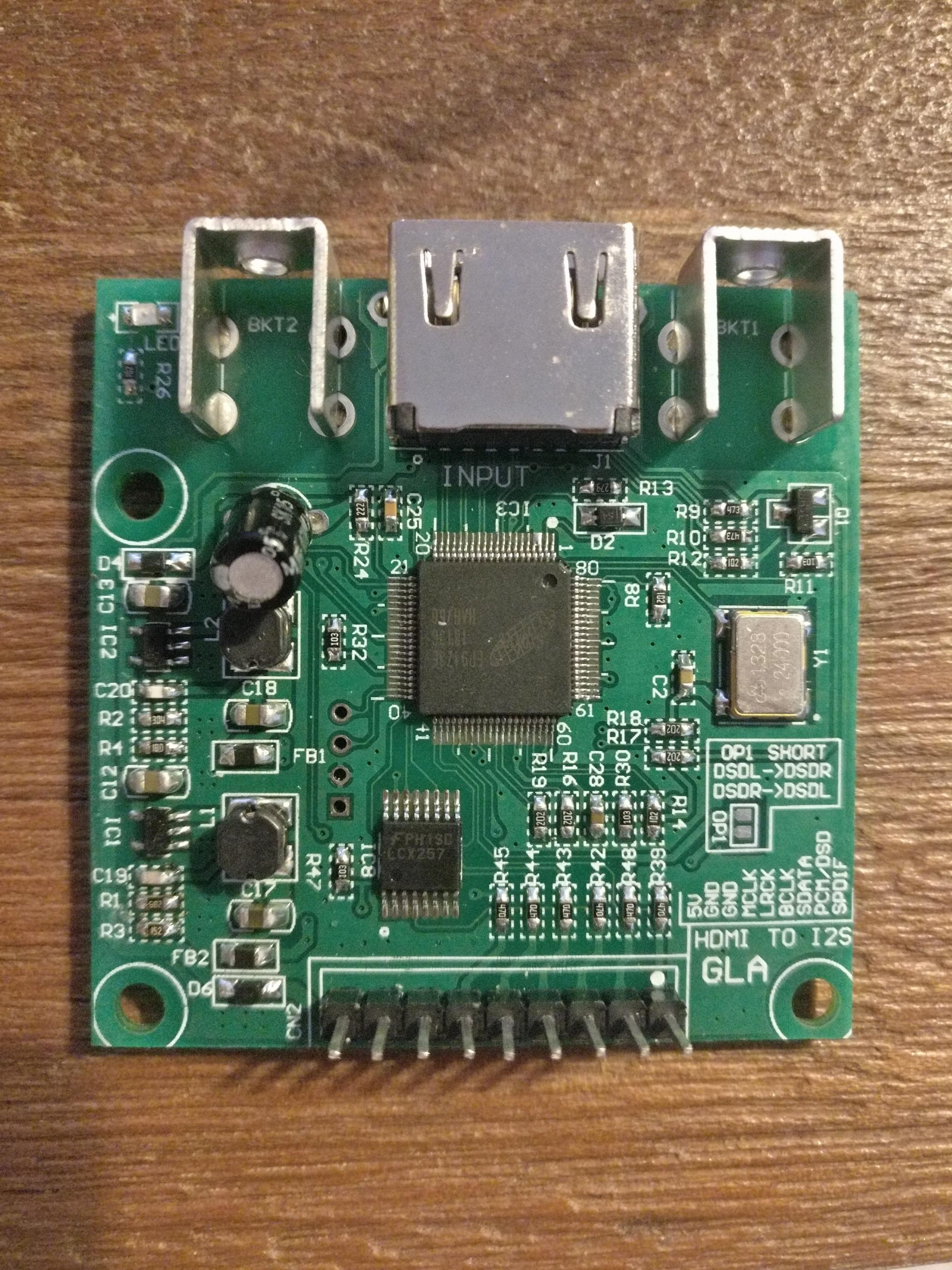

I have an HDMI to I2S board, that I could test as an additional ADC, but it still too advanced for me.
Cheers!
I tried my HDMI to I2S but it did not work. Tons of noise and the signal was hear very very very low.
I connected SDATA/DSDL to DSP MP0, BCLK/DCLK to MP5 and LRCK/DSDR to MP4. Probably I am making something wrong or this board was not meant to extract audio from HDMI.
You configured the dsp to run in slave mode (digital inputs always run in slave mode). Are the clocks synced in the system? Which module is the master?I tried my HDMI to I2S but it did not work. Tons of noise and the signal was hear very very very low.
Easiest way to connect input peripherals to the dsp over i2s is to set the dsp to be the master and loopback the output clocks to the input (see datasheet of adau1701).
Both the ADAU1701 need to to be running from the same clock but the clock on the HDMI inpput board is 24MHz (I think from reading the top). However if you read the ADAU1701 datasheet the only acceptable clocks are: 64*FS, 256*FS, 384*Fs and 512*Fs. So its not posible to run the ADAU1701 from the same clock as the HDMI board unless the HDMI has another clock that is phase locked with its sample clock that is acceptable for the ADAU1701. (assuming you wanted to clock the ADAU1701 from the HDMI board).
