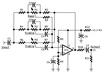

I would love to add bass/treble control, but I'm going to save that for later, unless it's very simple, cheap and quick. 😉

I'm definitely going to add some bass and treble next. The TV puts out very bass heavy sound through my amp and speakers. It sounds tinny through the TV speakers. It would be a nice blend, except that there's a few millisecond delay between them, so everyone sounds like Darth Vader.

I'm thinking of adding bass/mid/treble controls, as someone posted above. Stepped attenuators would be fine for that, right? I figure if I'm adding three more items to the signal path, it might be worth investing in a little quality.
