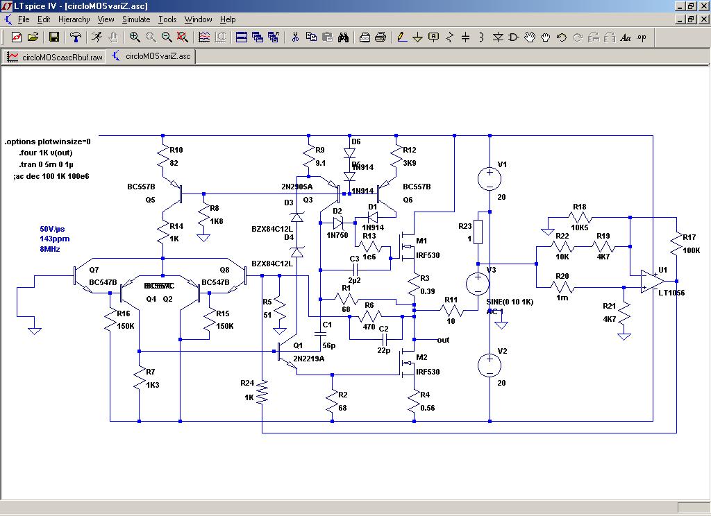

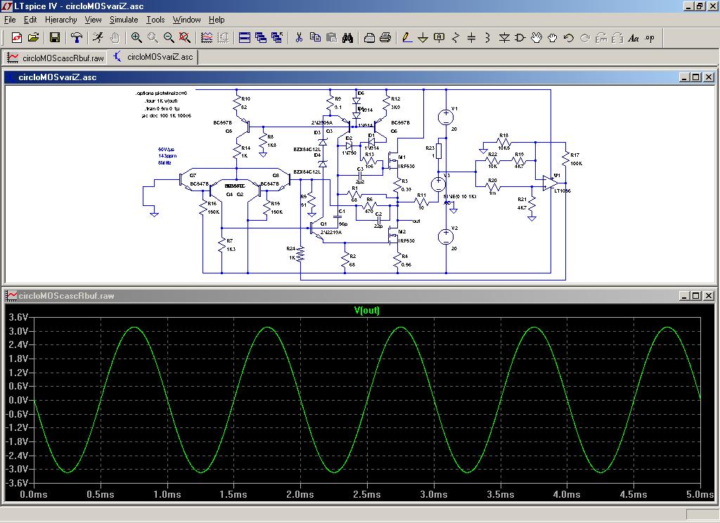

Running a transient analysis on different pot positions – results are quite exciting ! - well, for any effect gear – but no exactly what I was after 🙂
Could you share your schematic - or correct mine ?

can't find settings that fit 🙁

I don't see where the problem is: you just have to connect the circuit to any old conventional amplifier, and it works: look at the example.
If you try it on other architecture, or you cascade multiple stages, or you add a pole in the response with an RC circuit, you might get into problems (you get into problems in fact).
In the example, a positive output impedance is simulated; this can be changed by altering the R20 to R22 ratio.
When the simulated negative impedance is close to the copper resistance of the loudspeaker coil, the output level becomes huge, because it simulates a speaker having an ideal efficiency.what you mean with :
"The most annoying effect (from my perspective) was the variation of apparent gain with the simulated impedance setting."
Conversely, if you simulate a +10ohm output impedance, it's exactly like you insert a 10ohm in the output: the loaded level is reduced accordingly.

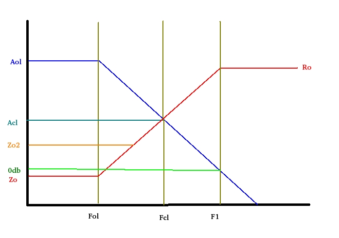

actually if you raise the output impedance of the amp, it's only going to have an effect below the frequency limited response of the amp's feedback (usually about 100hz to 1khz, depending on the amp). above the feedback turnover frequency the output impedance rises until it's equal to the amp's output resistance (at the amp's bandwith limit) as the effective feedback decreases. the raised output impedance will turn over at a higher frequency.
in the chart below, you see the Aol curve (standard Bode plot), and where the closed loop intercept is (Acl). also plotted is the output impedance curve (Zo). beginning at the open loop turnover frequency (Fol), Zo begins rising. if we were to set the output impedance at a higher level, it intercepts the Zo curve at a higher frequency. at the GBW limit of the amplifier (F1) Zo=Ro (the "raw" output resistance of the amplifier).
Acl does have an effect on Zo, because Zo (below Fol) is approximately Ro/(Aol/Acl)...(i'm pretty sure this is a close approximation. if it's in error, let me know)

uncl ejed613;2068813 said:actually if you raise the output impedance of the amp, it's only going to have an effect below the frequency limited response of the amp's feedback (usually about 100hz to 1khz, depending on the amp). ....
Not sure if it counts for "old school" solide state amps.
I mean - they are so low in output impedance that my guess would be that even at the top audio band they do not exceed a few Ohm.
As I want to rise Qts of bass speakers to values that are good for open baffle application, I think I need somewhere around 30 - 80 Ohm output impedance *below* ~ 100Hz to reach my goal with the vast majority of bass drivers available.
Bottom line - I think you are right in theory, but on the other hand I'm not bothered for the application I'm after.
