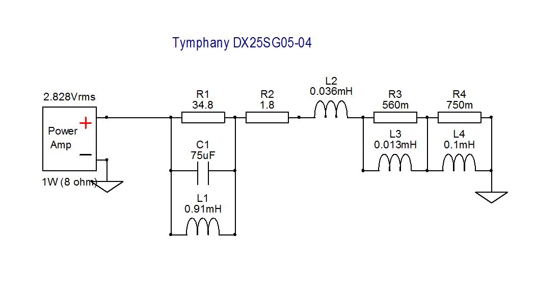

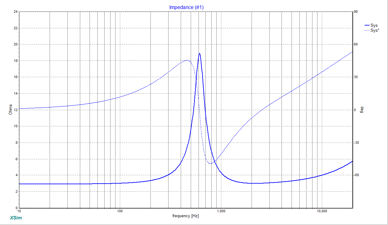

One doesn't know which that tweeter is and if you can provide that information then it might be easier to create a spice model for its impedance.
Its a Tymphany DX25SG05-04 1" Fabric Dome Tweeter 4 Ohm
see https://www.parts-express.com/tymphany-dx25sg05-04-1-fabric-dome-tweeter-4-ohm--279-171
Thank you. Most interesting. I'll use this to run some simulations and post the results.
I'm just wondering, what is the origin of this schematic?
You're welcome. This exact impedance model is used in Visaton Boxsim.

I've run a simulation of the circuit. I placed a 0.1 ohm resistor in series with the tweeter schematic which uses as an indicator of power, voltage and voltage phase changes in the circuit. Then I placed another resistor in series and stepped it from 0 to 6 ohms while at each step using a 2v ac source sweep from 1 hz to 30khz. I used the 0.1 ohm resistor to measure the results (voltage, power and voltage phase) of these iterations
If the circuit in the schematic accurately represents the tweeter then the simulation does show that adding a series resistor does change the power slope and power profile and voltage phase.
