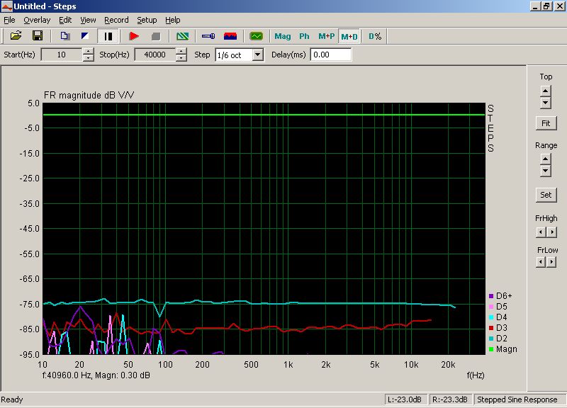

Attached is a harmonic distortion sweep of the VSX-D590S. Not terrible, but not great either.

Distortion is cumulative. You have the output (including distortion) of the AVR as the input to a second power amp which adds a little more distortion.
