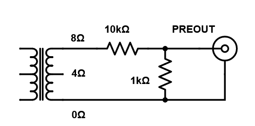

Don't know is the best place or not, put a voltage divider at output transformer secondary can provide a line level output.
But what resistor values to use to make sure the output impedance is pretty low and doesn't change with different connections on it? Or should it have a buffer?

This idea is came from a speaker level to line level converter.what resistor values to use to make sure the output impedance is pretty low and doesn't change with different connections on it?
Put a 10kΩ in series and 1kΩ across the line level output will provide about 10:1 voltage attenuation (-20dB).
