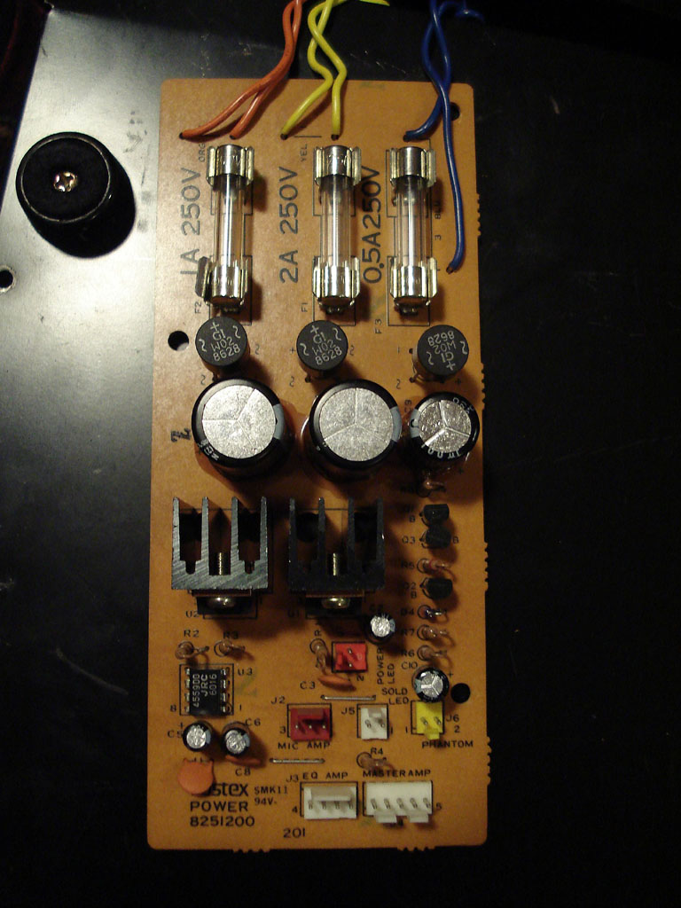

I just picked up an old studio master 16 to 4 board and no phantom. Lots of empty spaces in the chassis.
I also have an old fostex 450 crap board and it has this inside of it.
The yellow connector is 2 pins....... 48v and 0v and is labelled "phantom"
The 3 sets of wires blue, yellow, orange all connect to the transformer. If I were to take the transformer and this board and transplant them into the studio master......would there be a way that I could route phantom power to the xlrs?
If so, would I need any additional parts, or just directly connect the 4bv to the pins 2 and 3 of the xlr inputs?
Any help would be appreciated.

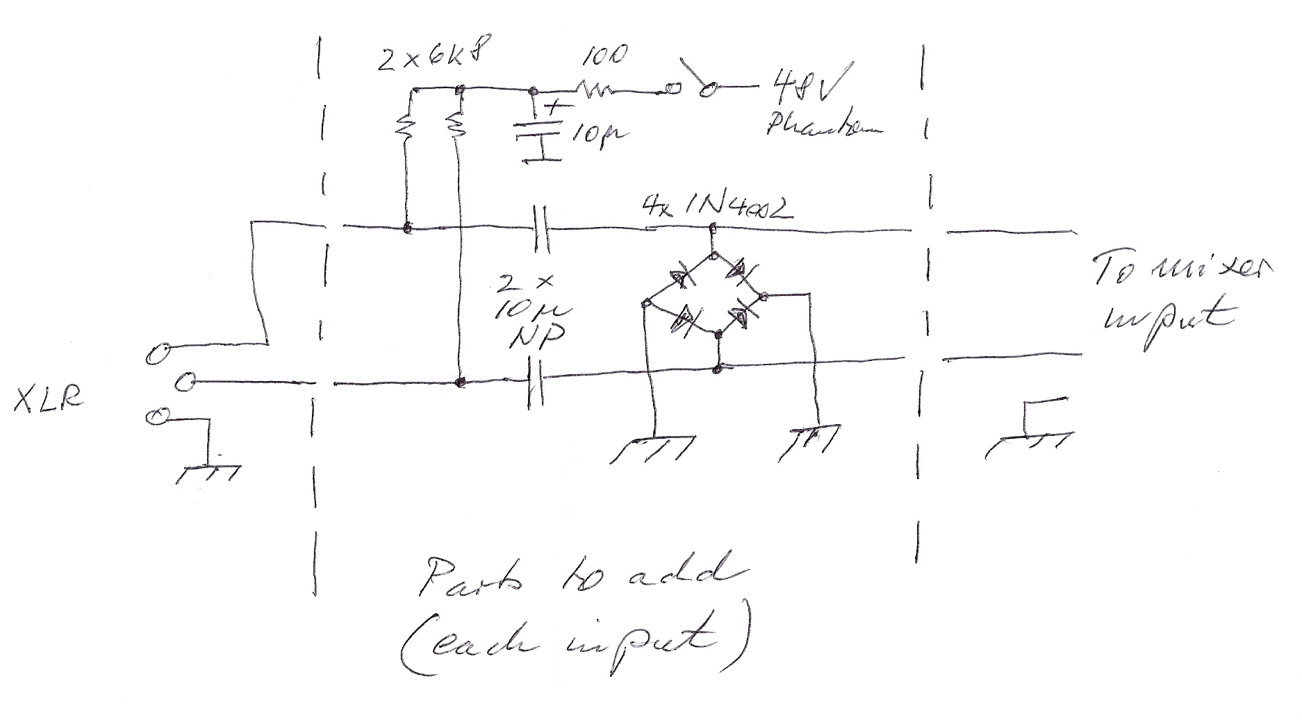

Use 12 volts for the phantom supply and then all you need to do is add the two resistors to each input.
