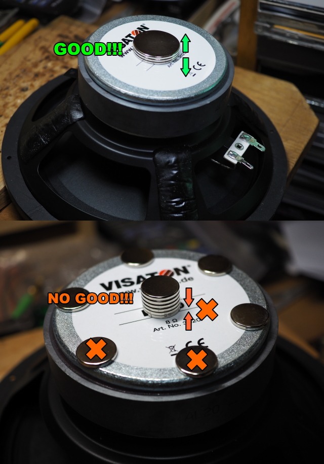

Adding neodymium magnets
Neodymium magnets work best when they are attached in a direction that repels the center of the magnet backing.(Visaton BG20)

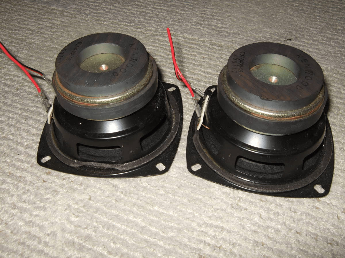

Some production drivers have been equipped with double magnets, primarily to minimize how far the magnetic field spread and avoid CRT picture distortion when speakers were placed too close, but the efficiency often increased as a side-effect. This pair (with ferrite rather than neodymium magnets) is by Trio-Kenwood.

Ive added a large 25mm x 10mm neodymium magnet to a diatone p610 clone. It increases sound output. Higher sensitivity in a linear way.
It sounds best on the side of the magnet, on the ferrite itself though, co planar magnetic fields, stuck to the side of each other with just magnetic force and complementary fields.
Seems like 6 of them would be a very big difference, almost like a neodymium made speaker itself, just WITH the ferrite too.
Why would these see more improvement with magnetic field on the ferrite surface, vs on the back of the magnetic filed collimator thingy..?

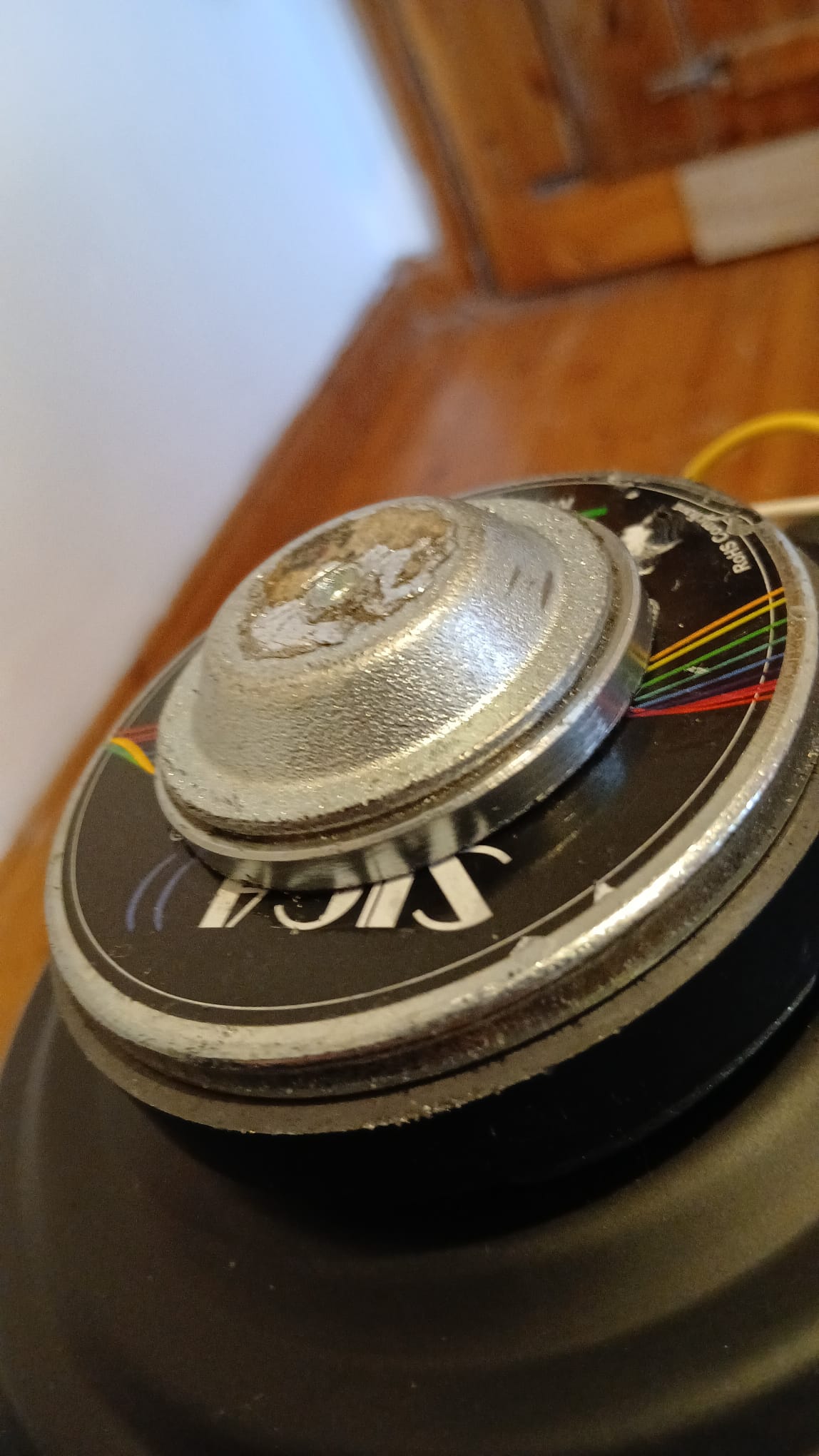

Tried this with Sica 10D1CS using the magnet off a LaVoce FSN 3 inch driver, it repelled first then snapped on very tightly once it got within a cm... its a strong magnet.

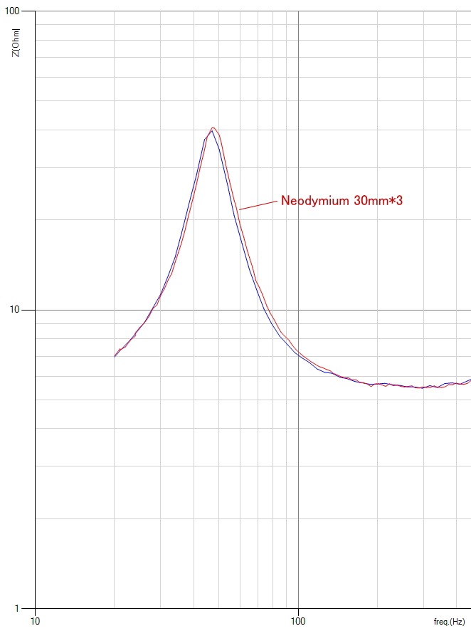

I tried making a basic phone recording, the driver naked lying on table, with and without magnet, there is a fairly significant effect, the bass reduces, due to lower Qts in this baffleless test setup. I think also detect more output in the upper end.
Recording is attached
Will put in a box soon and have an actual listen
