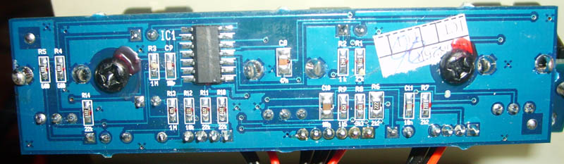

I have finally put my hands on the multimeter and opened the box to makes some measurements.
Well, as you can see on the picture, this is a tiny little piece of electronic, the kind of thing acceptable in a computer but not in a instrument effect. I really thing that it is playing a big role in the fact that it just does not sound rigth.
It is impossible to read the full description of the C.I. All I can see is "074".
Maybe a TL074 but it is so tiny compare to the normal one.

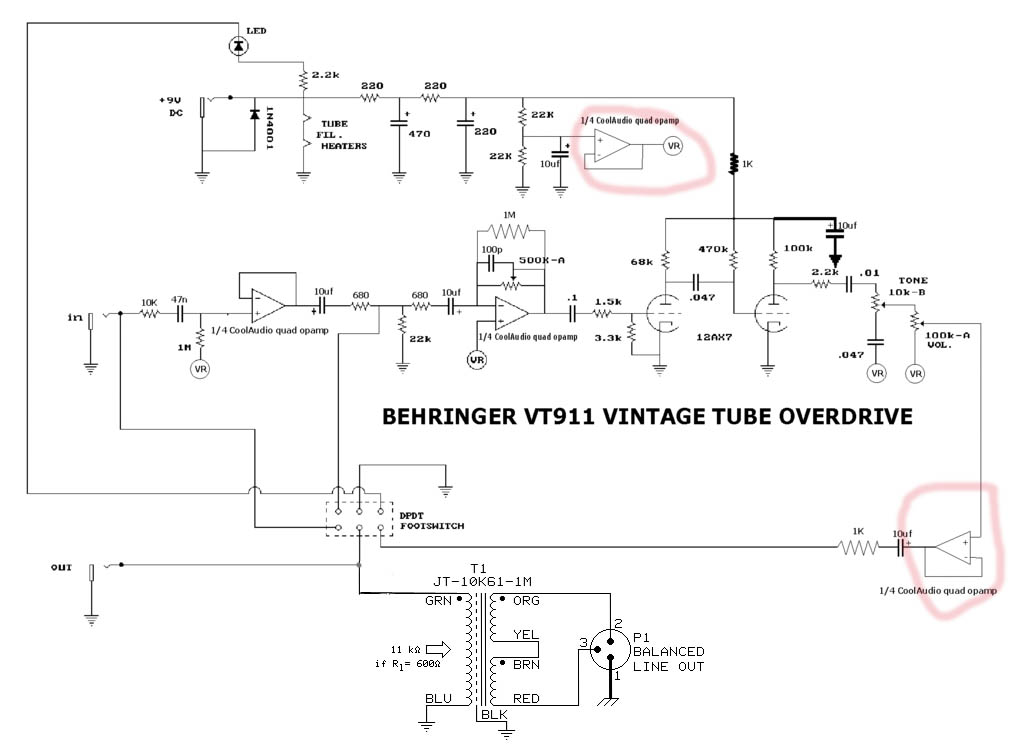

I don't see the reason why it is using a Quad Opamp when a double Opamp would do the job successfully? Do you have an idea on the reason of being of the two opamp marked in red? Could I bypassed them?
Btw, I made another correction to the map (regarding the 10 pf cap on the gain pot), it was originally a 100 pF.
And last but not least, I don't see a high voltage inductor for B+. How could it work w.o. high voltage?
Thanks.

There is nothing wrong with surface-mount circuits.Well, as you can see on the picture, this is a tiny little piece of electronic, the kind of thing acceptable in a computer but not in a instrument effect.
One provides a low impedance reference or 'virtual ground'. That is a GOOD thing.I don't see the reason why it is using a Quad Opamp when a double Opamp would do the job successfully? Do you have an idea on the reason of being of the two opamp marked in red? Could I bypassed them?
The other provides a low impedance output buffer. That is a GOOD thing. Do not bypass them.
All four opamps have a proper purpose, why would you want to bypass them??
There are no high voltages. It works from only 9V. Inductors are not necessary.And last but not least, I don't see a high voltage inductor for B+. How could it work w.o. high voltage?
Tubes can work at low voltages, but they do not usually sound very good- as you have noticed. This is a cheap product, do not expect studio quality.

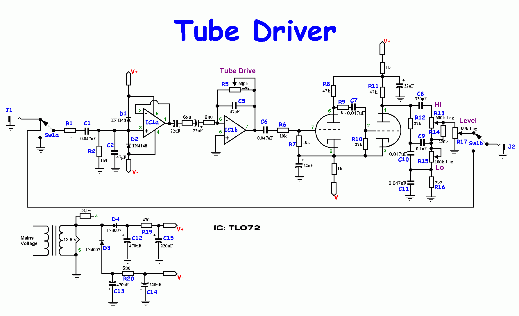

Hello everybody,
I have decided to completely redraw this pedal using the drawing attached.
I have tested it today but unfortunately, it does not work.
I have tested voltage on several points and it is showing 12 Volt (seems ok).
The problem could be the heaters. I have strap the pin 4 and 5 of the tube socket and placed the + from the power supply to pin 9 and the - to pin 4.
The multimeter is showing 12 Volt when testing between pin 9 and 4 (or 5) of the tube socket but the heaters does not come hot (even after 30 minutes) and it is not glowing orange.
I have tested the tube (12AX7) and it seems OK (appr. 0 Ohms between 9 and 4,5).
I cannot understand what's wrong, any idea?
Also, I am wondering why is the 18,1 W resistor used for?
