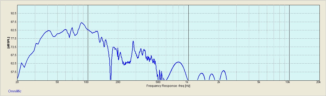

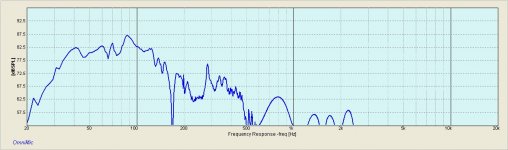

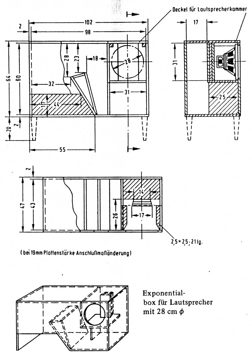

I have recently tested the vintage Klinger 12" horn. With the right driver, in my case Beyma G320, I get a output of 35-130 Hz +/- 3dB measured at the mouth opening using Omnimic. However there is a large peak at 85-90 Hz that I would like to knock down 4-5 dB. Would a internal helmholz resonator do it? How critical is the placement of IHR in the horn path? The ones I have seen have the IHR at the driver or at least pretty close to the start of the pipe.

One article that comes to mind is by E. Jakulis, TQWT Design Example: "...This article on the effects of Helmholtz resonators in TQWT design by E. Jakulis was brought about by an active discussion with Filippo Punzo." You might want to google it.
