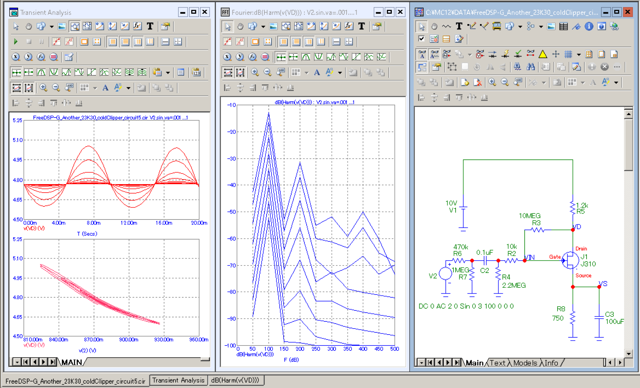

Adding even harmonics to a stereo signal
Almost 10% Distortion!
