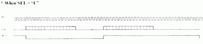

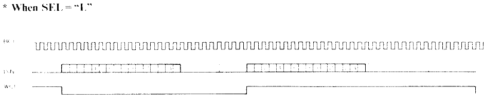

Okay a little experiment...
Used Cooledit to make some 1Khz/10Khz/20Khz sine/square wave files and burned a test cd...
When playing a square wave i could log 4 different 16bit data signals, (0) or (1) bit is last bit when reading data as I2S. when calculating I2S first bit is not used.
1: 0001101111111101(1) = 7165 (14331)
2: 1010010000000010(0) = 41986 (18436)
3: 1001101111111101(1) = 39933 (14331)
4: 0110010000000010(0) = 25602 (51204)
This is not looking as what it takes to make a square signal...
Mirroring the signal....
1: (1)1011111111011000 = 49112 (57324)
2: (0)0100000000100101 = 16421 (8210)
3: (1)1011111111011001 = 49113 (57324)
4: (0)0100000000100110 = 16422 (8211)
This looks more like it, only problem is the offset is not 32768 when Left adjusted. But when using I2S..
57324 - 32768 = 24556
32768 - 8211 = 24557
Does this look correct ?
solution:
49bit Serial data to paralel, latch on LR clock swap the bit's at outputs of latch and into a 49bit P/S... 🙂
Best regards
Kim Olesen

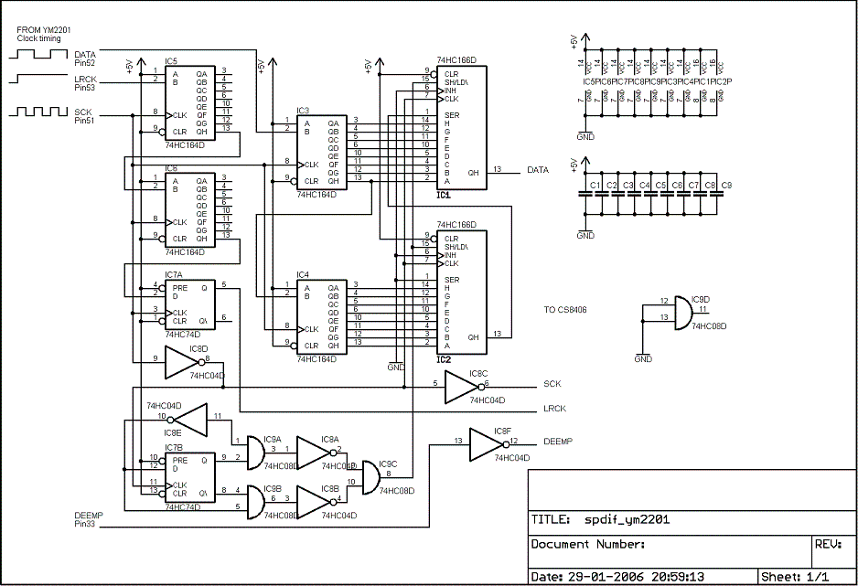

Hi
At last... It works 😀
2 x 74HC166
4 X 74HC164
1 X 74HC74
1 X 74HC08
2 X 74HC04
Schematic will follow soon..

2 x 74HC166
4 X 74HC164
1 X 74HC74
1 X 74HC08
2 X 74HC04
So, nothing to it? huh? 😉
😉 Took some time to figure this one out... a YAMAHA YM2201 datasheet could have been nice...

First shematic of Yamaha YM2201 output to I2S converter, have removed some gates from my test board so this version is not tested yet.
Still working on second schematic of the 8.6436 OSC (LClock2), 11.2896 VCO (modified LClock2), PLL (74HC9046) and CS8406..
😕 What will be the best for low jitter? Cd-players low jitter 8.6436Mhz OSC controlling a low jitter 11.2896Mhz VCO for the SPDIF transmitter or the SPDIF transmitters low jitter 11.2896Mhz OSC controlling a low jitter 8.6436Mhz VCO for the cd-player (i would vote for the last).
