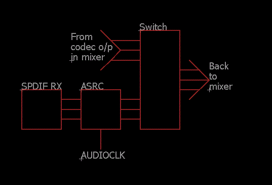

It somewhat depends on whether you want to replace the analogue I/O with digital I/O or add digital I/O to the analogue I/O though in the general scheme of things the difference in effort isn't that great. To replace or add to all the inputs would require at least 16 wires out of the mixer and 15 wires into the mixer. It would also require 5 SPDIF receivers and 5 ASRCs or 5 combined ASRC/SPDIF chips and, if adding to the I/O, a switch would also be required. And someone to layout the PCB. The attached image is for one stereo pair.

Let's say that I would sacrifice just the dedicated Line input on Channel 4 (the leftmost two RCA ports) by disconnecting that particular analog path into the CS4272 (maintaining the switchable Phono/Line input).
I would have to add an IC that takes raw SPDIF signal through the hijacked white RCA connector and converts it into whatever digital signal the CS4272 below can interpret.

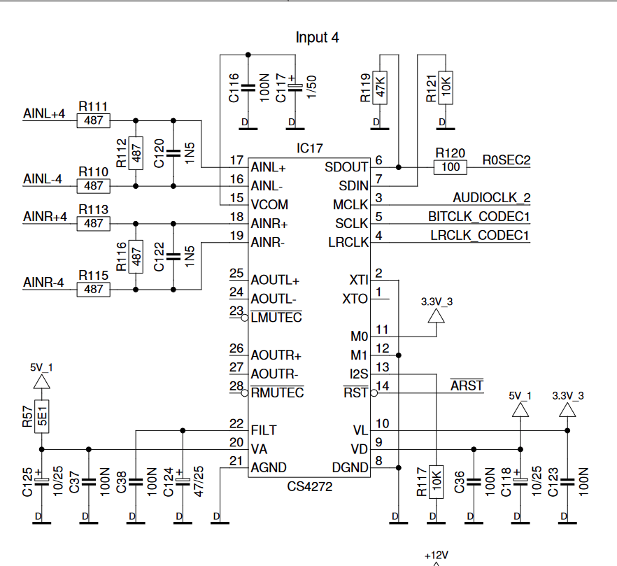

Based on the image below (from the pdf attached to my earlier post) I take it the AINL/AINR+/- are the Line level analog inputs, I take it the AOUT(LR)+- are analog outputs of the processed signal. What confuses me is that there is already circuitry attached to the pins 3-7, which my guess is where I would have to insert a (preprocessed) digital audio signal.
Is it possible/probable this is used for PFL (prefader listening/cueing headphone monitoring)?
And if that were the case, would it still be possible to somehow also inject the SPDIF signal through those pins?

The CS4272 is a codec, a combined ADC and DAC. Pins 3-7 form the shared digital audio interface. Pins 3-5 are the clock signals. SDOUT is the digitized output for balanced analogue inputs AINL and AINR and SDIN is the digital signal for AOUTL and AOUTR. The digitized analogue inputs route straight to the DSP chips and the outputs from the DSP chips route straight back to the dacs and SPDIF transmitter. The two DSP chips do all the audio processing.
When you turn an analogue input into a digital input without any option to switch back to analogue, you won't need the switch in rfbrw's schematic of post #6, but you still need the S/PDIF receiver and the asynchronous sample rate converter, as the incoming digital signal will not be synchronized with the internal clocks of the mixer. There are ICs that are both S/PDIF receiver and asynchronous sample rate converter, for example the Texas Instruments SRC4392. Most of them need a microcontroller to set all of the internal bit settings to whatever you need.

Nothing is being sent to the CS4272. All ADC side does is convert analogue audio into digital audio. If the SPDIF input is replacing the analogue input then the output of the ADC in the CS4272 is out of circuit replaced by the output of the ASRC. If the SPDIF input is an alternative to the analogue then the digital output of the CS4272 is switched out for that of the ASRC when the SPDIF input is selected.
The internals of the CS8422 don't matter. It for the the user to configure the input as required and configure the output as required. The CS4271, CS4272 and the CS4351 digital outputs use the left justified serial audio format so the CS8422 output will be set to that. The input is the SPDIF signal.
As to the latency you would have to compare the group delay figures, where given, for the various devices that meet your need.
