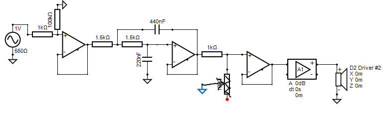

I think probably its fine, you'll want a low resistance pot there - I'd go for 5k (Alps RK27 is available in that value).
Btw the pot's still in the 'signal path' even if its only the shunt element in an attenuator. 😵

I still don't see the point to add another active stage in the signal path:
Instead of your 1k/100k resistor on buffer input ( first opamp) implement your attenuator there ( both opamps ( input buffer and the one added after your filter cell) are non inverting buffer so they are exchangeable).
And i would not implement a pot as you'll never be able to dial up same level between both chanel ( in other words your intended xover could only be expected not achieved in practice). You would face an ergonomy issue too: how are you going to lower volume for your whole loudspeaker?
But please let me go back to your root problem: you talk about noise issue. Ok from dsp? If it is an issue with your dac nothing upstream in the signal path is going to solve it.
If it is related to your gain staging then you need a fixed attenuation not something variable.
Could you make a global schemo of your system (Including source) it'll be easier to spot issue and how to solve them.

The miniDSP produces a fair amount of background noise/hiss when using the analog input, which i have to. I have gain to spare, so the solution is to attenuate after the miniDSP. I need to be able to fine-tune the level of the low section relative to the mid, this has to happen after the input stage, as they are sharing this stage. This fine-tuning will be a set and forget thing. I just want to choose the best way to do this, last time i got it wrong.
My drawing is pretty much complete. The voltage source is the minidsp, and the amplifier comes right after the output stage.

Denon 3700x -> analog input miniDSP 2x4 HD ->custom circuit as shown -> Icepower 200AS2
The denon is controlling volume. I agree its a gain staging issue, thats what im trying to fix.

We are getting off track here. As i said, i have gain to spare, so i can afford to attenuate right before the power amp sufficiently to remove any unwanted noise and still achieve the max spl i need.
All i need is a good solution to attenuate while introducing the least amount of noise and distortion. I can't see any way around using a dedicated opamp for this purpose. But i don't have confidence in my current suggestion on how to arrange resistors and pots in this arrangement.

Yes there are reasons, don't put it there, its detuning the Sallen Key filter (which expects zero source impedance toI still need to attenuate the signal, mainly to lower the noise generated by the minidsp. However, i want as few opamps in the signal path as possible, so i wondered if there are any reasons why i shouldn't add an L-pad between the buffer stage and the crossover-section, as drawn below
achieve its designed response curve).
Basically add another opamp stage specifically to attenuate, and use lowish value resistors, like 1k:1k to keep the noise
down (most opamps can happily drive 2k loads) - there is absolutely no benefit to scrimping on opamp stages, adding
them usually increases performance as here as you need each part of the circuit to do one thing well, not two things
badly. Use as many opamps as it takes - no more, no fewer. An illogical desire to reduce the number of opamps is
going to cause problems, not solve them.
Here you want an input stage with suitable input impedance, you want some attenuation, and you want filtering - that's 3 stages.
(However there might be a way to combine filtering and attenuation, but not with standard Sallen-Key design - you'd be
starting from scratch).
I note the input stage lacks RF filtering - I'd suggest fixing that if the input is via a cable from another box - 330pF to ground on
the input connector at least.
