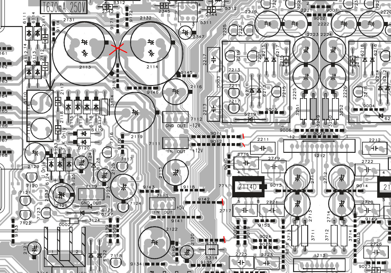

I've added a second transformer with dual secondary (0-12v) put through a LM317/337 AudioWind circuit regulated to +/- 10v, this is then 'fed' back into my Marantz CD5000 to power the analogue circuitry (Cerafines and LM4562 op-amp) which it does and there's a big improvement in SQ. I used the op-amp pin 4 and 8 at the 220uf (2521/2522 capacitor point). I removed one of the original supply capacitors 3300uf (for the -10v feed) as it's not needed and used the ground here to solder a wire back to the new regulator.
However you can hear a hum when then CD is powered on (not playing) at high amplifier volumes. I'm concerned that this might be a grounding issue......thoughts?

I'm afraid I can't really give you any advice on what to try... its complex and you would have to really study the grounding arrangement so as to not introduce a problem. The reason why these issues appear is because of the small but finite resistance of the conductors/wire/print that allows voltage to be developed along their length as current flows. So you need to aim to not introduce anything like reservoir cap charging currents into a critical audio or analogue ground.

Find the point on the PCB that joins the existing filtering capacitors for analog supply. This is where you should connect your "new ground" to.
How you choose the "new ground" point is also important. To start, try to feed the center tap point from new power supply, straight to the point I described in the first paragraph.

See the photo I attached. It shows a big red cross where you should tie the grounds.
The little red lines show where to connect the -10 and +10V DC from your external power supply. NOTE: remove the links 9011 and 9012, and the links 9142 and 9137 first. I trust you are able to figure out where to connect -10, and where to connect +10V...
The schematic is for CD6000 - couldn't find the 5000 one, but they should be similar. If not, you will still get very good picture of what needs to be done

Thanks Nick for the direction, really appreciate it. Luckily the CD5000 has a far simpler PCB with a star ground. I haven't done centre-tap point to the ground, I certainly have a feeling this might be the issue.
