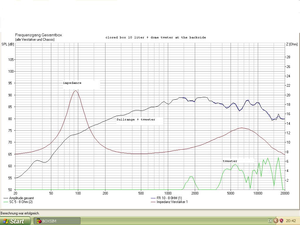

i make some experiments with a fullrange (fr10) and a tiny dome tweeter (sc5).
but this tweeter is built into the backside of the box (aside the midline,not symmetric).this does not enhance the sound volume (on front axis) but gives a better polar diagram and fine details solution ........and the "room" is anyhow different...............
tweeter xover : 1uf mkt - 1ohm res - tweeter 8ohm.
no xover at the fr (blue line in the sim).

Hello mjf,
i used that trick too in my fullrange dipole line arrays.
A (super) tweeter filling the polar dispersion in those
angles wich are neglected by the fullranger solves
the problem at its root.
I would bet, that also your "sweet spot" is wider now and
the speaker does not sound "dull" anymore when you listen
at greater distance ?

it is an experiment............the visaton fr10 sounds a little bit dull above 12khz........and that tweeter makes the high tones sound more transparent but not "louder on front axis or shrill".............i think i like this.

So is it better to have the helper tweeter firing backwards rather than forwards?
Yes, I think you will have more freedom to cross the backfire tweeter without xo on front FR

backward "filler" tweeter in fullrange OB
Yes, that would be the proper way if you want an FR OB with a rear
"filler" tweeter (the term was chosen by a friend of mine, as he
auditioned my OBs and i think it hits ...) .
To have acoustic centers of tweeter and the rear side
of the FR cone in the same plane is preferable and should be easy to
do with an OB.
A fullranger usually has a falling frequency response according to shape
(magnet size) and dimension on the rear side. Typical models drop
above 1..3 Khz. The rear tweeter fills the missing backward radiation.
In fact there will be a crossover frequency where the tweeter
will contribute the same sound pressure as the fullrangers rear side,
even though the electrical low pass filter for the FR is omitted.
This technique is interesting if the fullranger has good presence and
brillance to the front. Btw. there is an early OB design from Wharfdale with
a tweeter firing to the ceiling from the fifties. That variant adresses
the same Problem.
If your fullranger has low brillance to the front, and the rear walls in your
room are highly damped (heavy curtains e.g.) a backward tweeter
may not be a good solution.
If implemented right, the result could be a dipole radiator with
fairly frequency independent directivity and symmetric radiation
between front and rear side.

Hi David,
i think what is basically achieved with a rear filler tweeter is
making "copies" of the direct sound bouncing from the walls
(side, rear) more similar to the direct sound in spectral energy
distribution. IMO in that way the speaker/room system draws
less attention to itself, because things "fit" together and
our hearing system is happy to relax.
Nevertheless i would prefer a solution with phase
issues minimized (rear tweeter in phase with backwave).
As you said before, the goal is to keep the homogeneity of
a good fullrange system. The price to pay for "sonic coherence
by using a fullranger" is normally a lack of acoustic power
radiated towards higher frequencies, since the radiation angle
of the fullranger narrows with frequency.
The rear tweeter compensates that partially, but with good
subjective results IMO. Personally i had good experience with
a "less is more" approach. I did not turn around the speakers
180 degrees and adjustet the tweeter to produce a flat on axis
response ... since the tweeter would then radiate much more power
in the crossover region than the fullranger because of its
wider dispersion.
I rather walked around in the room and asked myself
"does it sound approximately the same everywhere".
That led to a lower voltage level for the tweeter, than
in a conventional 2-Way approach, i found a rising voltage towards
the brillance region preferable: Most tweeters will also start to
beam above some frequency (falling acoustic power radiation),
and what we want is a flat power spectrum in the reverberant
field.
btw i did go so far to mimic the higher backward directivity
of the fullranger in the crossover region by using two dome
tweeters row ciruited, one of them bridged by a capacitor to
have a single tweeter at the top.
Since my line array has pronounced directivity, that seemed
to be a good solution. I cannot hear the backward tweeters as
a distinct sound source, but they help to keep the sonic impression
present and brilliant even at larger listening distances in the
whole room, which is pretty unusual when using fullrangers.
Nevertheless what i hear is the homogeneity of the fullrangers,
it does not sound like multiway.
Like to hear from your experiences, since every environment
(and taste) is different ...
Cheers

I made up my prototype baffles for my mids and tweeters.
First I tried the Supravox 215 on its own, to find that it is way down in the top end, with a baffle peak around 700Hz. I put 1/2" F11 felt around it which helped, but really had to put a broad notch filter in to make it listenable. Even then. it was way too dull.
Next up was the tweeter added from 3KHz rear firing out of phase. This did help a bit, but I found that the rear wave sounded more correct that the front wave that still sounded very dull.
I have now put the tweeter in the front in phase from about 6KHz. This now sounds a lot better balanced, but I suspect that the mid is still slightly hot and may need padding down by a db or 2.
OK, a backward tweeter can only compensate missing backward
radition, this FR candidate seems to need even more help in the highs.
Hope it was worth trying ...
Hi Oliver,
Yes it was, and ultimately the solution may be to have 2 tweeters as well as the full range!
Regards
David
A further update on this:
I ended up padding the FR down with a 1.7 Ohm resistor. The tweeter is front firing, but is brought in 1st order at 10K - anything lower than that, and it ruined the coherence of the FR. I also tried adding a rear firing tweeter, but that just created a mess - I thing the frequency power response may have been more right, but all the magic went out the window.
