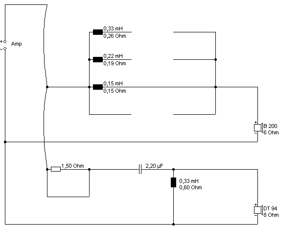

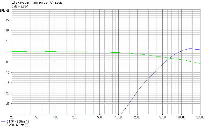

I didn't find the Visaton DTW72-8 in my database so I used the DT94-8 that is similar (for this xover application/simulation, I used it in conjunction with the Visaton B200 fullrange) at about 15 cm from the main driver (top or bottom). You can see that it blends well at about xover freq. 7K, the problem here is phase what the horns mitigate better.
If you use the higher inductor to curve the top of the fullrange at HF, you may need the resistor on the tweeter. With the smaller inductor you may need not.😎
You have some tests & auditions to do now...
The inductors on the fullrange are aircores.
The resistor (if used) is NI type.

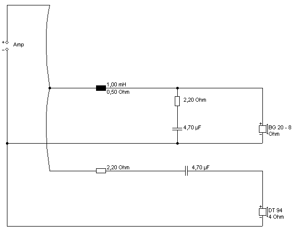

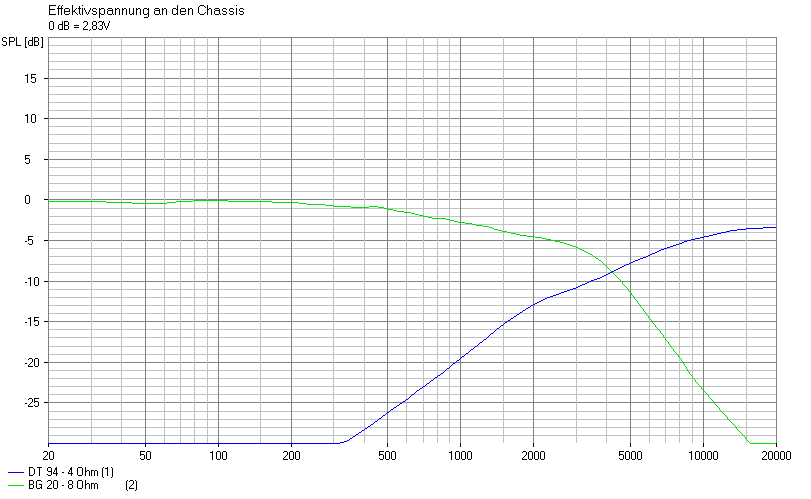

The Vifa DQ25SC16-04 is a dcr=3ohm tweeter. You have to double caps from 8 to 4 ohm, and the inverse for inductors.😎friday I´m initiating tests with a vifa dq25,with just a capacitor in series with the tweeter,I guess this is the easiest way to start things up...
1. Use this filter, with good integration, xover at ~5kHz, as a starting point.
2. The important thing is a good phase between components, this one (xover) it's very ok.
3. Then adjust atten. of the tweeter with resistor, for small alterations.
4. You can also adjust the inductor, on the fullrange, for more or less balance between bass/mid-bass and mid/high-frequency (5kHz).
