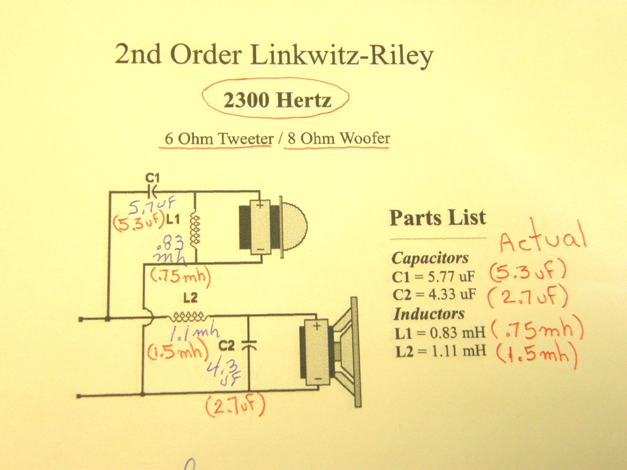

Ok, so now I am listening to the speakers w/o crossovers. Yes, it sounds different, mostly in a good way. The mids are more present, but the treble needs a raise. Now considering a post mentioned here about the crossover needing frequency adjustment or some sort of rebuild starts to look more attractive to me. Also the comment about using an EQ to help determine where the sound in general needs help is also helpful. In short, I need more data to be practical about 'repairing' the crossover for these drivers. I am posting a photo of what I actually found, including closer to what the real frequency that was being used as a crossover point. Not a Butterworth after all. Not 2.5Khz either. Linkwitx-Riley, 2nd order at 2.3 k....

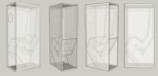

When you say horn loaded, is the woofer front loaded or rear loaded for bass?
If these are just basically direct radiating on a baffle it can be easily designed in sim.
As opposed to wild guessing without some sort of measurement.
Maybe a few system pics would help and tweeter model number.
Padding a tweeter with a L pad is not very hard. With some sort of data
Let me acknowledge that I feel a little embarrassed about something. I decided to go ahead and pull the crossover and listen to just the Mark Audio 12PW by themselves. This made an improvement over the crossover and tweeter being used. Yes, it had to do with the crossover. But it is not over yet. This morning I decided to take a step back disconnect the Black Ice Audio SS-X 'spatial expander' as well, and an additional improvement came about even though the this unit was set a zero. It seems that the tube buffer had given the speakers a fuller sound, which you guessed it more bass too.
I am just sitting back for a few days and listening to recordings unaffected by what was only a short time ago. No, don't get me wrong, due to my hearing and other things like some of the recordings themselves, things don't sound perfect. Something in the middle would be nice. The good news is that I don't have to turn up the music to get things to sing. Let me reflect on this.
FWIW, posts #7 and 9 answer the tweeter question, and this is a rear loaded horn designed by Steve Deckart of Decware Audio, model DNA2.

Headphones are an excellent suggestion for comparison. I haven't been doing enough of it, but the little that I have leads to believe that there is a need for tipping up the treble. That of course was the original reason that this started to take shape. When I did add the tweeter and crossover, I simply didn't realize how change was happening and became convinced that this was all about my hearing, the room, and even recordings, when in fact, they did all have a certain role in what I was hearing but the crossover was as guilty as anything.
Then of course came all of the suggestions/possibilities that can be tried. I even considered making new cabinets. Duh, one of the most important answers was in the box that I was criticizing! I danced around the problem for too long, finally disconnecting the crossover and tweeter, and start again with at least one problem out of the way.
