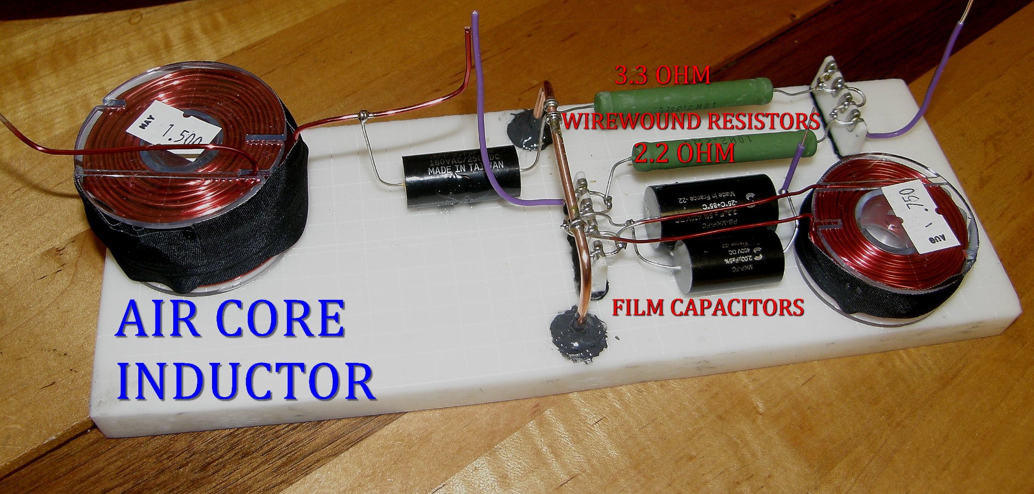

I have this idea of adding either heavy duty pot to a crossover for the adjustment of a tweeter in a crossover or at least a switch that would adjust tweeter level. The tweeter is 10 DB more efficient than the woofer so I am betting that there could be some latitude here. As it sits now, the tweeter is padded down by 10 DB. It is a 2-way crossover with a 2nd order Butterworth slope at 2.5 Khz. The woofer is a Mark Audio 12PW used in a loaded horn design, and the tweeter is a Scan Speak horn loaded tweeter. I will have to look at the model number. I bought it from Madisound for about $42 ea.
I would actually like to tip up the tweeter level just because it might help me and my old ears but then maybe a bad idea. You guys will certainly have valuable advice. Thanks.

Without seeing the crossover schematic, it's hard to give decent advice.
If the crossover currently includes a fixed L-pad that uses standard values and the tweeter is 8 ohm, you should be able to change to an adjustable L-pad with little impact to the crossover. 4 ohm L-pads can be hard to find.
And "padding down" a tweeter isn't always done with a standard L-pad configuration or with typical values. There's lots of latitude in how this can be accomplished.

That is likely to be a Scanspeak H2606/920000 which has a nominal impedance of 6 ohm and a sensitivity of 95 dB/2.83V/1m.
To attenuate a 6 ohm tweeter by 10 dB as you have stated, the L pad should have R series = 3.9 ohm and R parallel = 2.7 ohm.
To tip the tweeter UP by 3 dB, you would need Rs = 3.3 ohm and Rp = 4.7 ohm.
I hope that helps you see how the resistors must change in order to suit the degree of attenuation required.

Assuming that the series resistor in your L pad is the 3.3 ohm one and the parallel (shunt to ground) resistance is the 2.2 ohm one, then you could try this:
Devise a method of switching an additional resistor of 2.2 ohm in series with the existing 2.2 ohm resistor to increase the parallel resistance to 4.4 ohm - which will give you a 3 dB lift.

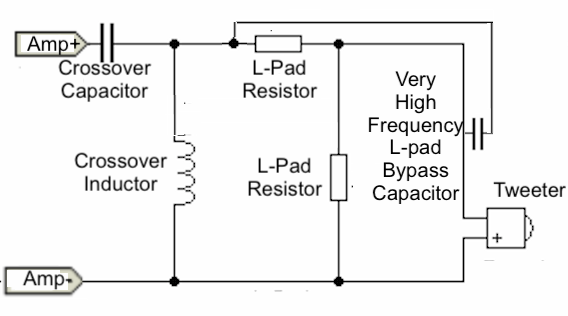

Tipping up the entire tweeter range may not be the best approach.I would actually like to tip up the tweeter level just because it might help me and my old ears but then maybe a bad idea.
Most "old ears" hearing declines above ~2kHz with age, with the very high frequencies (VHF) above 10kHz taking the biggest hit:
Reducing attenuation will raise the level above the crossover point across the entire range, which may "boost" frequencies you still hear fine.
You may want only more VHF, without raising the 2-5kHz range.
Since you are attenuating the HF, there is a potential to raise VHF by as much as that amount.
The Scanspeak H2606/920000 has a fairly flat on-axis response to ~16kHz, you could make it's upper response rise at +6dB per octave by inserting a smaller value capacitor (with the same or greater voltage) to bypass the attenuation.
For a 6ohm driver, using a 7mfd bypass capacitor would put the "lift" starting around 4kHz, a 3mfd bypass cap ~8kHz.
You could install an on/off switch to put response back to normal when younger ears are listening 😉
