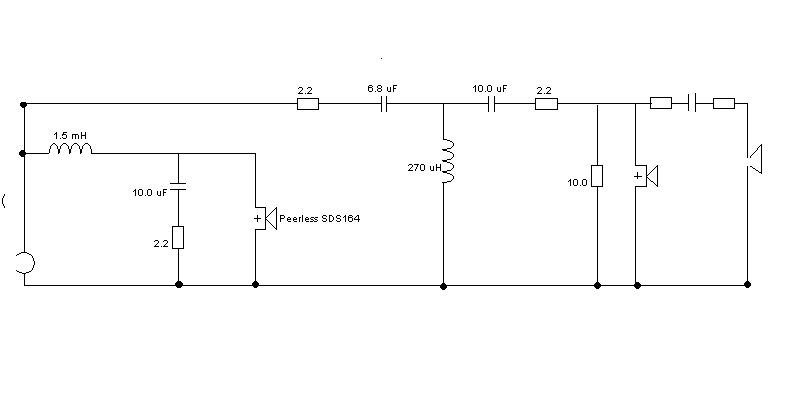

I have this:
A TW consisting of a Peerless SDS-164-THP (830657) and a Hivi research X1-A. Crossover:
I want badly to add a supertweeter. The X-1A is a nice tweeter but it's just not punching up in to that "sparkle zone" I want to hear.
How can I wire this up? Especially with a minimum to no(?) changing the existing x.o. in the box? What's the best (cheap) supertweeter? I intend to mount it in a separate small enclosure sitting on top of the main cabs.

So the cap on the xt19 terminal... series or parallel? I'm guessing it's parallel? then the series resistor between the cap and the tweeter on the pos lead?
What's a good ballpark for resistor value so I know what scale of pot to buy? I'm assuming after I know approx R value I can buy a linear pot to find my fine tuning? This totally bypasses the existing crossover??

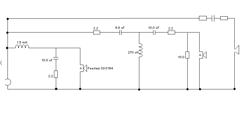

I have doubts about second attached xo

Excellent tinitus, thanks so much. What do you think my starting values for the resistors should be?
Also what about this one?
I would place the tweeter, maybe polarity inverted , after the 6,8 uF cap ,then a 4,7uF in place of the 10uF one ,and then the supertweeter . Put resistors after to find exact gain match ...also the external box has to match with the emissions.
