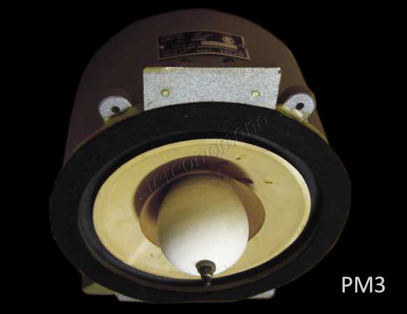

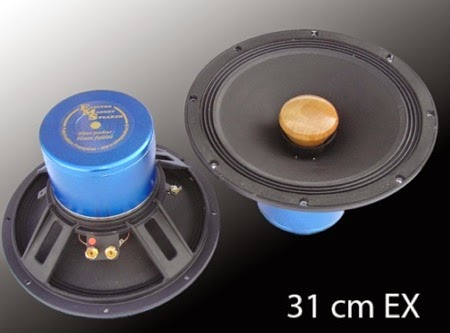

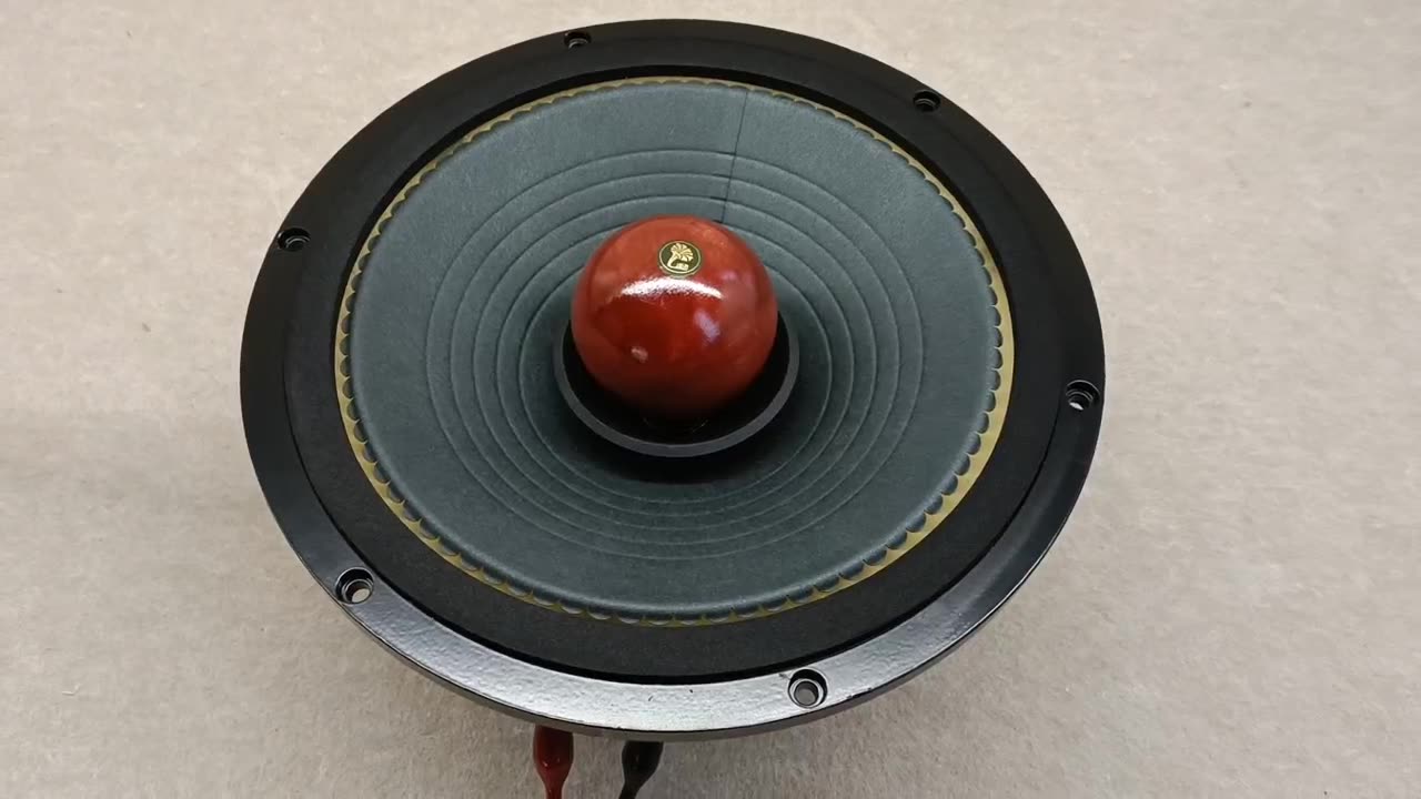

In the FR brands there is quite a lot of shapes for the phase cone that can be found. From really rational Mark Audio stuff as you mentioned to some more esoteric / exotic materials. Wondering if they are all functional or if some of them enter that decorative side of the spectrum even degrading the audio somehow.
Here few pictures / Fertin / Lowther / Lii Audio / Siemens (klangfilm)
Sorry if i am off topic...But this can add to why adding a phase cone i hope.

Oh yes, some are simply aesthetic -especially those fixed to the cone rather than being static. 😉 Profiles -YMMV; depends on the on / off axis FR you're aiming for, and there the design & profile of the cone / cones, surround etc. come into play. And there are sometimes different ways of achieving the same (or similar) ends. Some of the material aspects may be aesthetic or in keeping with a general theme; sometimes they might serve double functions like heat-sinks as alluded to. I remember a polystyrene or some such design that was used for damping a specific frequency -what the driver was I don't recall though. Ditto for a rubberised job that looked like a refugee from a squash court (and might have been for all I know...). The most interesting example I can think of wasn't really a plug at all: it was just a piece of drilled-out dowel rod used to coaxially mount a tiny neodymium tweeter. I think a few tried that with the old Pioneer B20.
