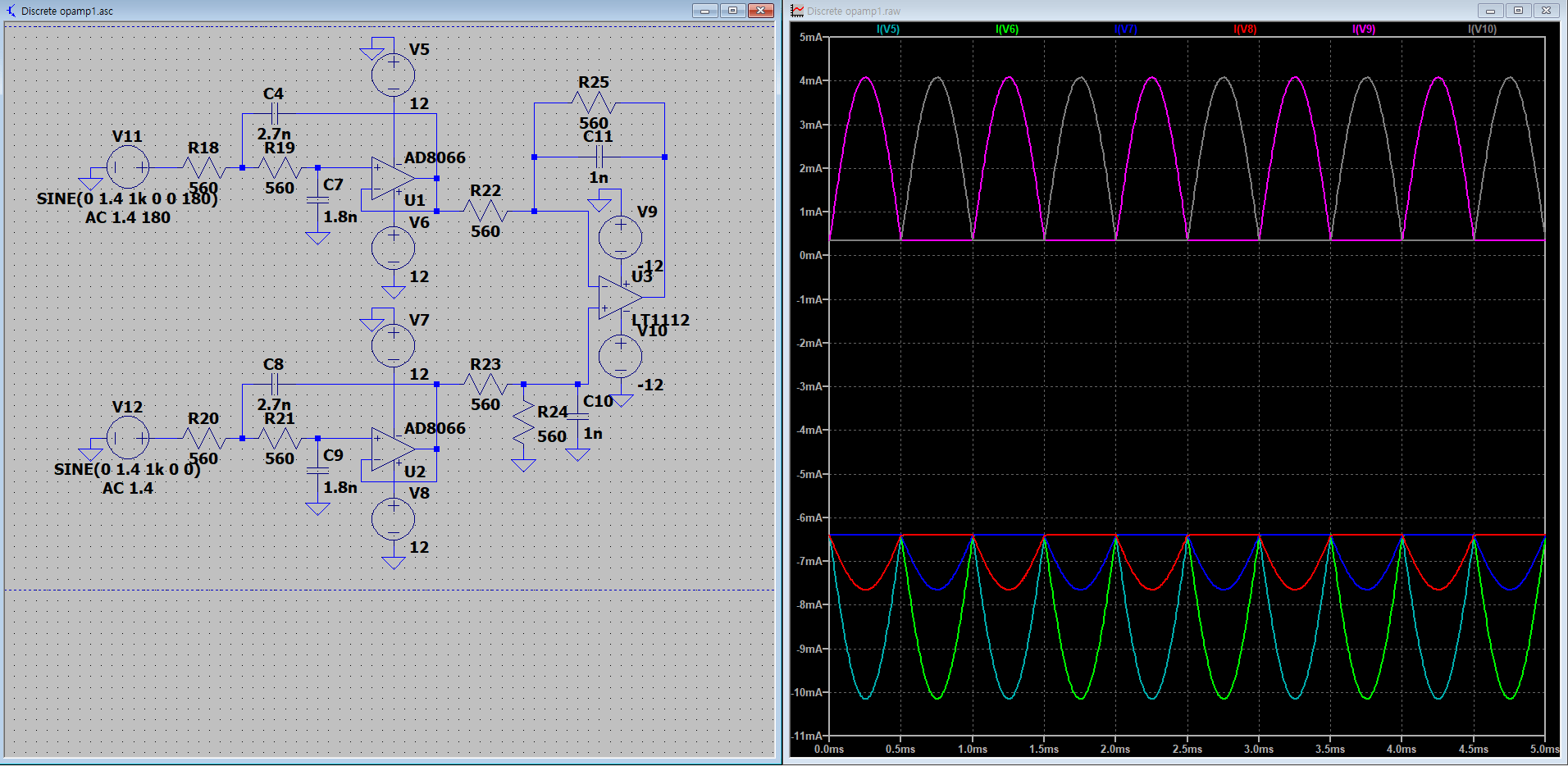

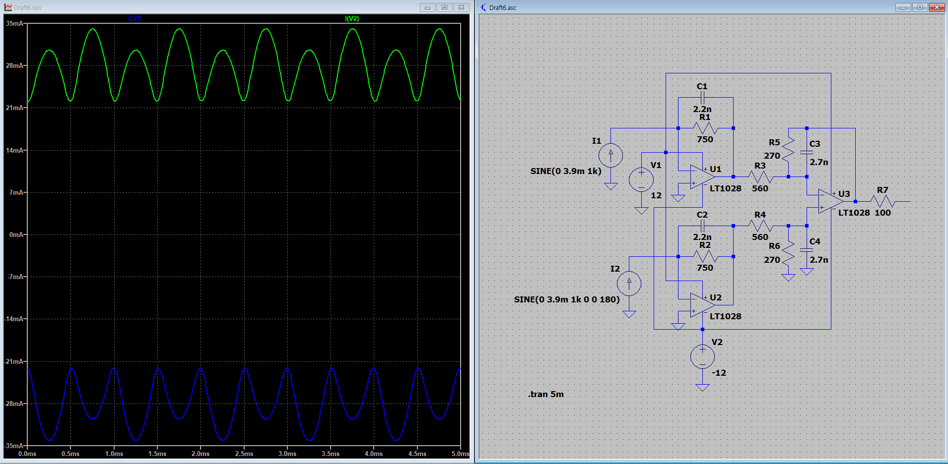

@Mooly I understood. The gain was so great that I completely buffered the opmap (connecting negative and output), and then connected a very large resistance to the +input of the opamp. Now in the simulation, ICC, IEE are back to sine wave as it was. As you said, iem is enough under 100mV. By the way, is it good that the icc and iee are similar to the output waveform like this? Installing a small resistor and bypass cap on the power pin also flatten the current. I wonder if it is better to have a resistor and bypass capacitor between the regulator that supplies power to the opamp or only have a bypass capacitor. Thank you so much

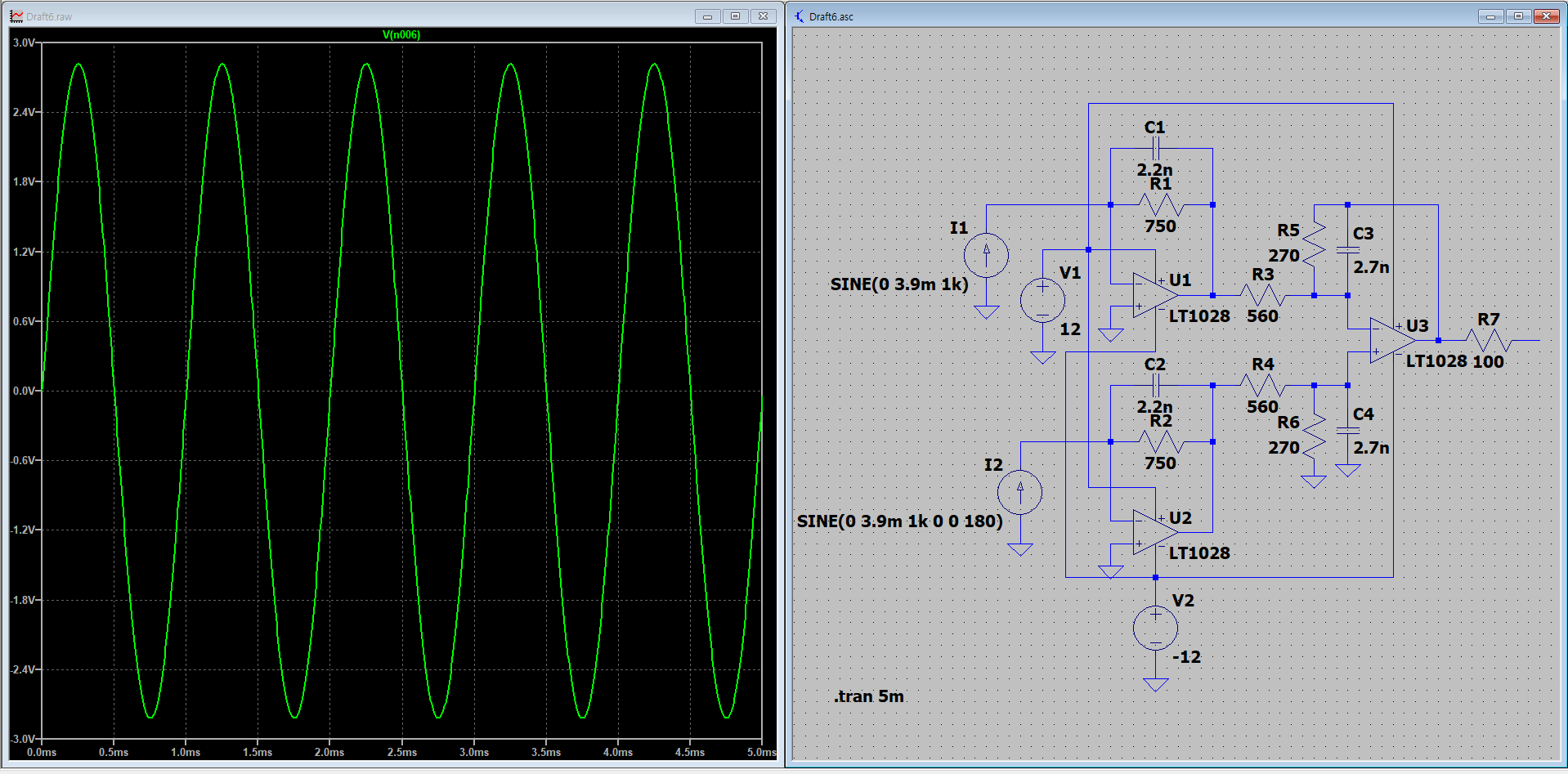

This is the output for a sine wave of 1kHz (2Vrms)
I used the I/V circuit specified in the PCM1794 datasheet.

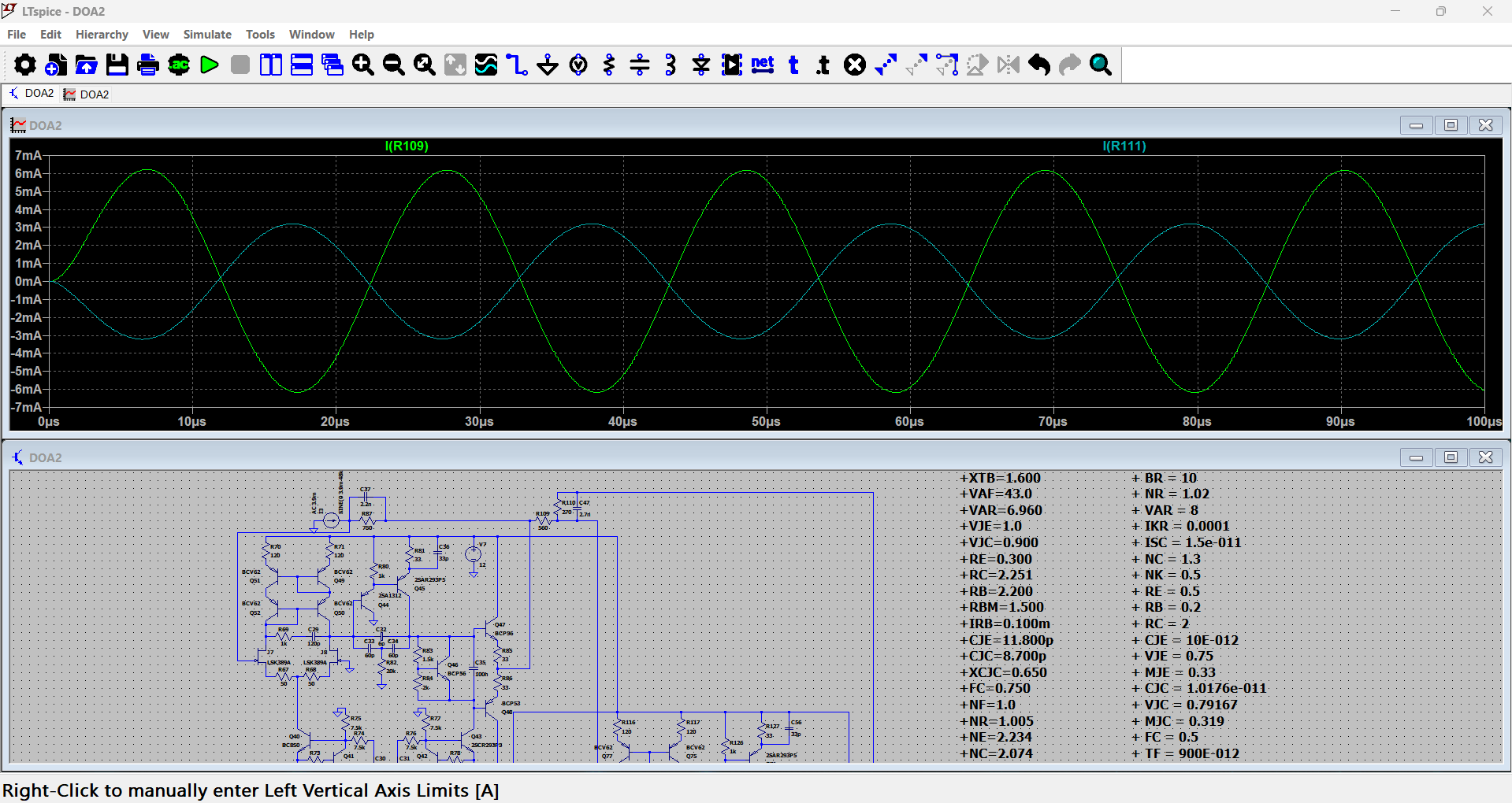

This is the power supply current.
This is another DAC with voltage output type
Some opamps have completely sinusoidal supply currents.

I would say its normal.
Post your .asc and I'll take a closer look tomorrow 🙂 but I think all you are seeing is the supply current in response to the opamps driving the resistive networks. If you look at the currents in R3 and R4 and R5 and R6 they won't be equal.
