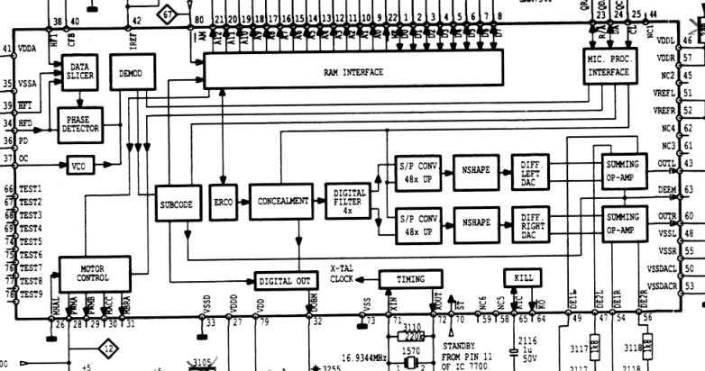

I've been working on a external DAC design, but I'm convinced that a custom DAC and clock upgrade inside of an existing CD player is a better way to go. Avoid all that nasty SPDIF stuff altogether.
I have a Philips CD920, an early 90s unit, that I'd like to use as a test platform. I have the repair manual for it, and it uses a SAA7431 servo/decoder/DAC chip. I don't see any obvious pins for I2C data, only SPDIF out. I attached the schematic that shows this chip. I cannot find the datasheet on the web anywhere, even at Philips.
Any thoughts?

You need to find a I2s line carrying the 44.1/16 audio data and associated clocks and route that to your custom DAC pcb which I assume will contain a suitable oversampling filter and DAC chips.
You may also want to consider placing the clock on your DAC board and sending that back to the player. This should solve any jitter issues.

Pin 32 is the SPDIF output.

There are a number of test connections on the chip (Test1-9, pins 66-78) which I think are worth a look at, but haven't had the time to dig into yet. The chip is on the backside of the main board, so probing is a bit of a challenge.
I did find that the supply lines are TRASH. How about 250mVpp of high frequency hair on the +5V line? AND, the +/-10V lines to the analog output stage are regulated with a zener/resistor only. I don't need to tell you how bad those lines look.
So far, I think my upgrades to this player will be limited to a better clock (making a Kwak Clock board now), and adding more supply regulation.

Reclocking and zero-oversampling are certainly valid things to try, but the SAA7431 in the Philips 920 handles all input conversion, oversampling, D/A, and I/V conversion, so not much I can do there! BTW, your clock circuit works very nicely, and I believe it made the greatest sonic improvement.
csd,
as everything is inside the decoder chip, further effort is pretty much wasted unless you bite the bullet and install an SPDIF receiver and a new DAC. As long as you have a good master clock and use this to clock both decoder and DAC, you don't have to worry about jitter being induced by the receiver chip. If there is a way to run the receiver in slave mode, i.e. without its internal VCO, it will work even better.
I'd check first if the DOUT pin is really active because in most Philips decoder chips, it can be deactivated by software (but this is rarely done).
