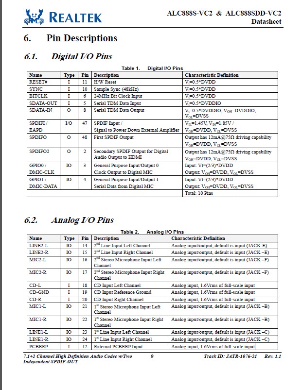

Rrecently I had the idea of eliminating a usb to spdifout dongle that feeds my DAC from the mobo, by accessing the s/pdif out signal, directly from the sound chip an ALC3888s on a small sized mobo, out of an old MSI wind u100 laptop.
My question is, do I have to activate, somehow, the s/pdif out? or I should be able to get a signal as soon as I hook up the wire onto the corresponding pin?

I mean, I have a mobo that utilizes the ALC3888S sound chip, but has no s/pdif output anywhere on the mobo as a header or rca or anything like that, so I thought I might be able to get an s/pdif out tapping directly onto the pin of the chip, it is pin #1 according to its datasheet... and get a ground from around there, and feed that signal to my dac;s s/pdif's input ...
so the question is, if I connect onto the chip's output, will I get a signal, or I would have to activate it somehow with software...

Ok, here is a page off the datasheet, and it is actually pin #48 that I have tapped. Where should I look for GND, if nopt the rail of the chassis?
Also, there is no digital output on the device's driver window, the mobo is out of a wind u100 notepad...
any suggestions? could the spdif be activated by editing the driver? am I making any sense here? it's beyond my knowledge base by far, Thank you all for contributing!!!!

Hmmm, that is sort of useful. It seems that the pin can drive a coax cable directly. The voltage at DVdd is 3.3V and DVss is 0V (ground) according to the datasheet.
Given that info, you just need to AC-couple the output through a capacitor and reduce the voltage while preserving the output impedance. This is very similar to what is shown in figure 6 in the link I posted above - you essentially already have the equivalent of the 74HC04 devices inside the ALC888. If you connect pin 47 to the 100nF cap, and instead of the 360R and 91R shown in figure 6 used 220R and 100R, you should be in business. The junction between the two resistors goes to the coax center wire and the shield should be connected back to the ground near the ALC888 IC, or other convenient ground point that is electrically "close" the the IC.

The problem here though is that his driver does not seems to have support for the SPDIF interface, even though the chip has the hardware support. I know from prior experience that the Realtek chips won't output SPDIF unless it is explicitly set as the output device, and the proper sample rate and bit depth is set.
I would suggest that the OP try using the default Realtek driver from their site (not the mobo manufacturer's driver) and see if they can enable the input before trying any hardware mods... the SMT work is risky and its easy to bridge the connections.
