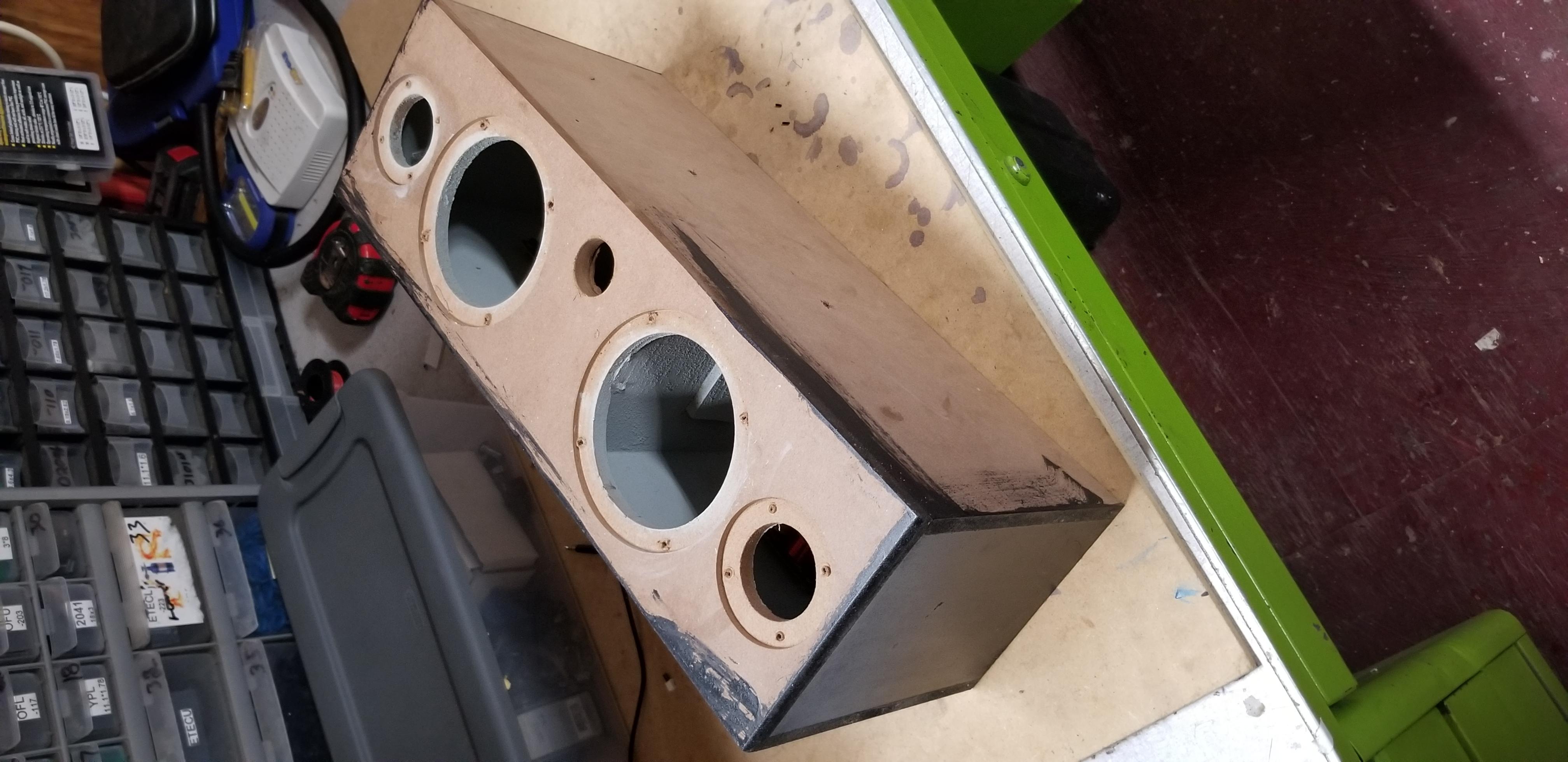

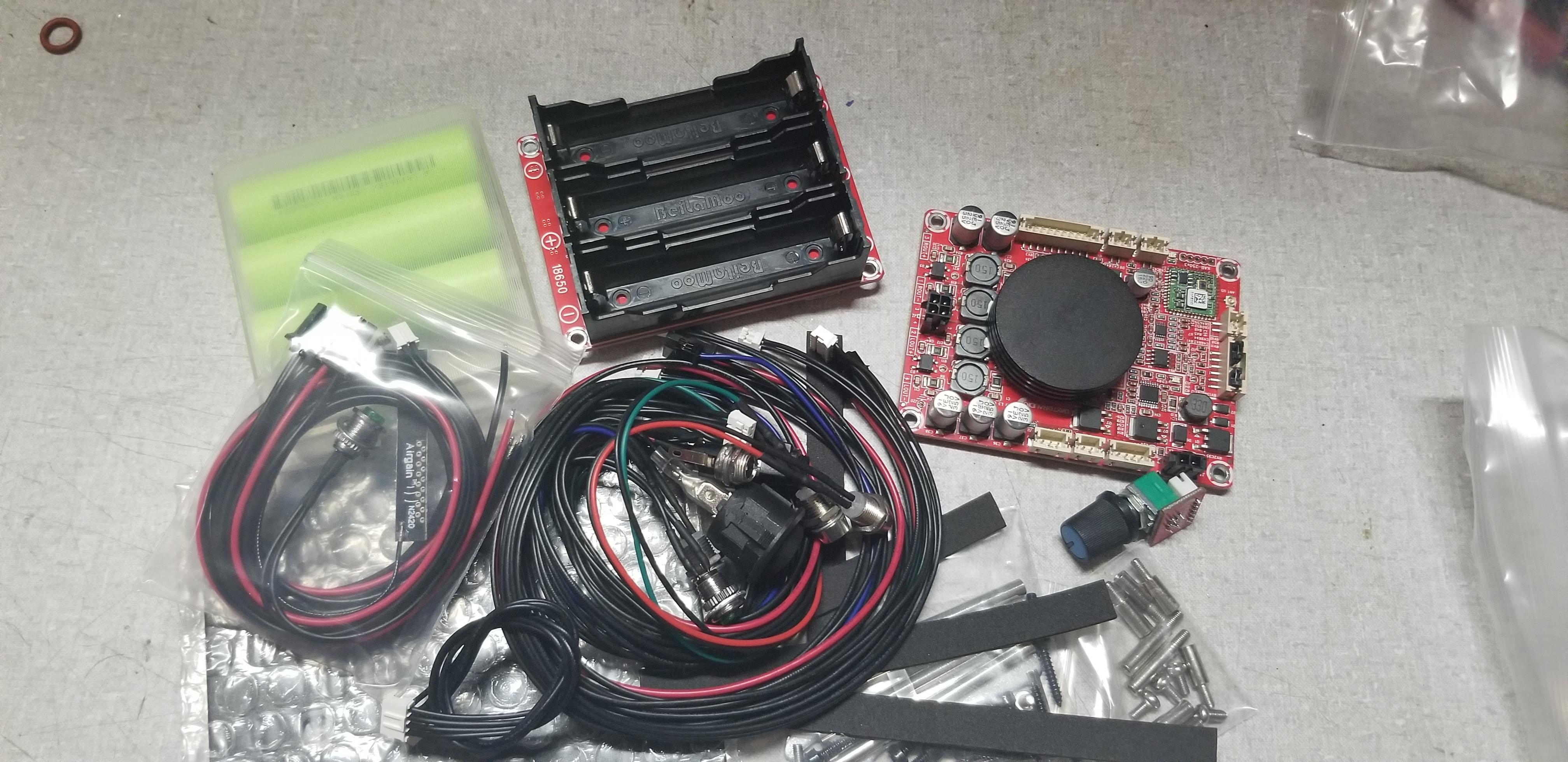

I have the MK Boom setup working. However its rated at 50x2 at I believe 21v. Amp is rated up to 24v.
Comes with battery module of 11.1v. You can add another but only for added play time not increased voltage. Any ideas on how I could fairly easily do it?
