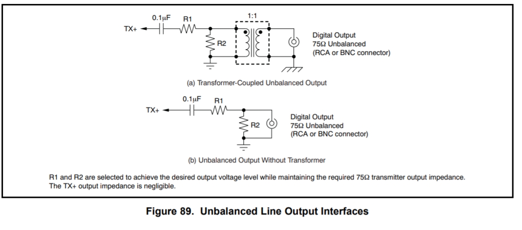

I decided to order a Lattice FPGA development board, and convert direct to SPIDF. The plan is to put the small development board inside the unit. Perhaps an overkill, but it seems the easiest route, and the boards are less than 20€, too. The simulation result...
Still one question. How to convert the output to 0.4-0.6 V peak to peak as required by SPIDF, is it fine to have it between 0-1.2V instead (and not -0.6 - 0.6)?
