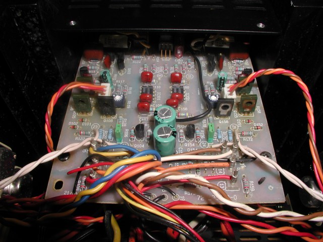

I ran out of opa97's. I am just going to replace them. What do you think of some thing like "damp rid" in a loosely sealed container at 150 degrees f?. toaster oven may be. The funk was so bad by one cap it lifted the copper trace off from the board. I just left the lead long, and soldered it at a connection right next to it(on the same trace of coarse). Santa drop off your package yet? The sleigh left over 3 weeks ago😀
I checked all the caps with my LC meter and everything checks out. Still reading 5vdc on outputs. Also checked most of the resistors too.
I ordered four A1142 transistors (this is the GFA-555 II) from Mouser and they should be here Monday. These are the ones that look a bit burnt. I did not see a short between emitter/collector on existing transistors.....
The owner is quite insistent on changing the transistors to see if it fixes the amp. I am worried that I will do more damage to the amp...
The Adcom "Expert" claims replacing the transistors should fix it...
There are jumpers on the input board - what do they do?
The A11142 are the two T0-126 transistors on the far left and the two on the far right...
Well I did some work on my555 tonight. The output driver transistor is bad on the bad channel. I need to order all new driver to match. Going to go with MJE-15030, and MJE-15031
The thin green electrlytics on each side of the opamp - look to be 4.7uf 50v - I suspect these to be the issue...
I believe they are for the the +v and -v 5v rails to the opamp.

Well I replaced both 4.7uF 50v caps and all is good on one channel. The other still shows 4.8v all the time.
I will check for a bad solder joint later.
When I first turn the amp on, it shoots to 12v and drops to 130mv in about 10 seconds on the "fixed" channel. It eventually evens out at around 60mv. I guess this is normal?

john65b said:Well I replaced both 4.7uF 50v caps and all is good on one channel. The other still shows 4.8v all the time.
The 12v spike is bad. It settles to close to spec, but the spike is bad news for tweeters for sure. I am have headaches with my 555 also. I found a bad driver on the outputs so I replaced both on that channel. When hooked up to the input boards it goes to 34vdc now

I do not have any electrolyte from a blown cap. My input board looks clean albeit a bit dusty.
I will replace the two big 25v 470uf caps next.
These are the only four electrolytic caps on the entire input board.
The last time I was tripped up over a high-ish DC offset it was due to improper grounding of the input. Is this possible? What is the resistance I should see from Input Ground to Chassis Ground?
I get 3Meg ohm from left channel Signal ground to Output Ground on the "working" channel and 146k ohm on the channel with the 5v DC offset.
Should the input grounds be shorted together?
Speaker Output to chassis ground is 0 ohm

Hi John,
There's your problem. 100 ohms to speaker ground from the RCA outer shell. The resistors will appear just fine, but they are open.

OK, now I am getting somewhere. As soon as I short the input signal ground to chassis ground, DC offset goes to 0.
Is this the issue? Do the input grounds need to be grounded to chassis? EDIT - just read your 100 ohm post above
The previous "good channel that went to 12v before dropping to just under 100mv just pops to a couple volts and very quickly returns to zero mv.
What gives? Could this be the magic GFA-555 panacea?

Hi John,
Just replace the 100 ohm metal film resistors on the input board. This is to break the ground loop and also to protect the PCB traces in the event of heavier current. It worked.
What you are seeing is normal.

Well I took out all the output resistor thinking maybe one is stuck. That was a waste of time. I have the input board out now, and ready for cleaning. I have a bunch of 970's, and 2240's. resistance seems in check on the input side, but I still will test. I am at the point in this hobby where I have figured out to double check every thing before slapping it back together. BTW all the small ga wires coming from the output boards have 80vdc
Something is amiss, and it though it was on the output boards.

Hi Ben,
Absolutely no troubles getting the parcel in. Wonderful!
Normally, DC offset without excessive current draw will be in the voltage amplifier stage. There are exceptions and things that can go wrong to change that, but it's a good "rule" to stick to unless there is reason to believe otherwise.

I gave the board a bath in a vibrating pool of simple green😀
I tested ever single resistor, and every single diode. All good🙂
Replace all the 970's, and 2240's. I left the differential pair alone. I did not have the parts anyways.
I pulled the caps without looking at them. All the other boards I worked on had a dot to signify neg. This board has a fat bar, and a skinny bar. I am guessing the fat one is negative?
555
OK
555 done!!!
