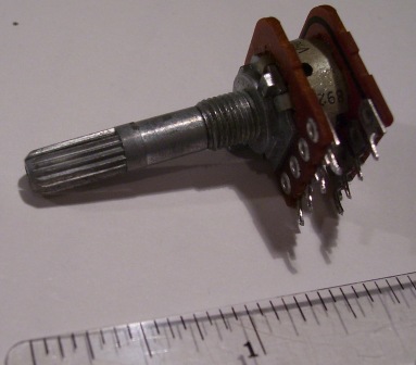

Hi all,
I'm the proud owner of an Adcom GTP-400 preamp-tuner with
a funky volume control pot. I've removed it, but hours of paging through Mouser, Jameco, etc web sites has proven frustrating.
I'd like to get a "drop in" replacement. I know ALPS is much better,
but I don't want to deal with making it fit.
The Adcom part is labeled:
V50KBX2 4TR-2586
Does anyone know where I can find a replacement?
Thanks,
RJ

I thought it was an Alps. If you can't easily get one, try
a 24 position selector switch (make before break) wired with
resistors - they're a pain to make, but very worthwhile for
performance and longevity. I like the Elma and Grayhill switches
the best.

Good questions!
no pic (yet)
dual-gang.
4 solder pins on the bottom.
panel mount, long (1.25") shaft.
Pot cuts out left channel at < 50% volume,
some scratchiness above that level, occassionally
distortion.
Tried massive amounts of TFE on the control.
Helped a little, but not nearly enough.
AFAICT, it's a cheap carbon comp wipe, maybe
plastic, don't know.
-RJ
adcom preamp pot pic
Here's a pic of the pot
adcom part not available
Well, I broke down and called Adcom - I was not happy about the $25 minimum order (for a $3 pot), but figured that I had already exceeded that $$ just in my time searching catalogs and web pages.
No Joy. Adcom cheerfully told the part was not available. Wah!
They DID email a copy of the service manual, but the quality of the scan was so bad, I'll need to trace the circuit just to find out what this puppy is doing with it's 4 connections per channel.
I got a good deal on the preamp - $40 - but it may be wasted $$ if I can't replace the pot successfully. :smash:
Thanks for the help!
-RJ

Yes, loudness tap.
