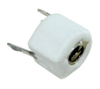

The trim cap you recommend (GKG10015) is no longer manufactured, thus obsolete. However, Mouser does offer part number 594-2222-808-23109. This is also a 3-10pf trim cap. I just now ordered one for my Adcom. I hope it works! No reason it shouldn't.

I tried many links within this post and so far none of them worked. I visited Mouser.com and they no longer have the recommended part for my tuner (it is marked obsolete), CT104 part # 659-GKG10015 so I ordered 2447-GKG10015-ND from DigiKey Electronics because it seems to have the same characteristics.
https://www.digikey.com/en/products/detail/ew-electronics/gkg10015/11689286
Can someone knowledgeable about this issue let me know if this looks like it might fix my problem?
At this point I am not even sure if it even looks like the correct part.

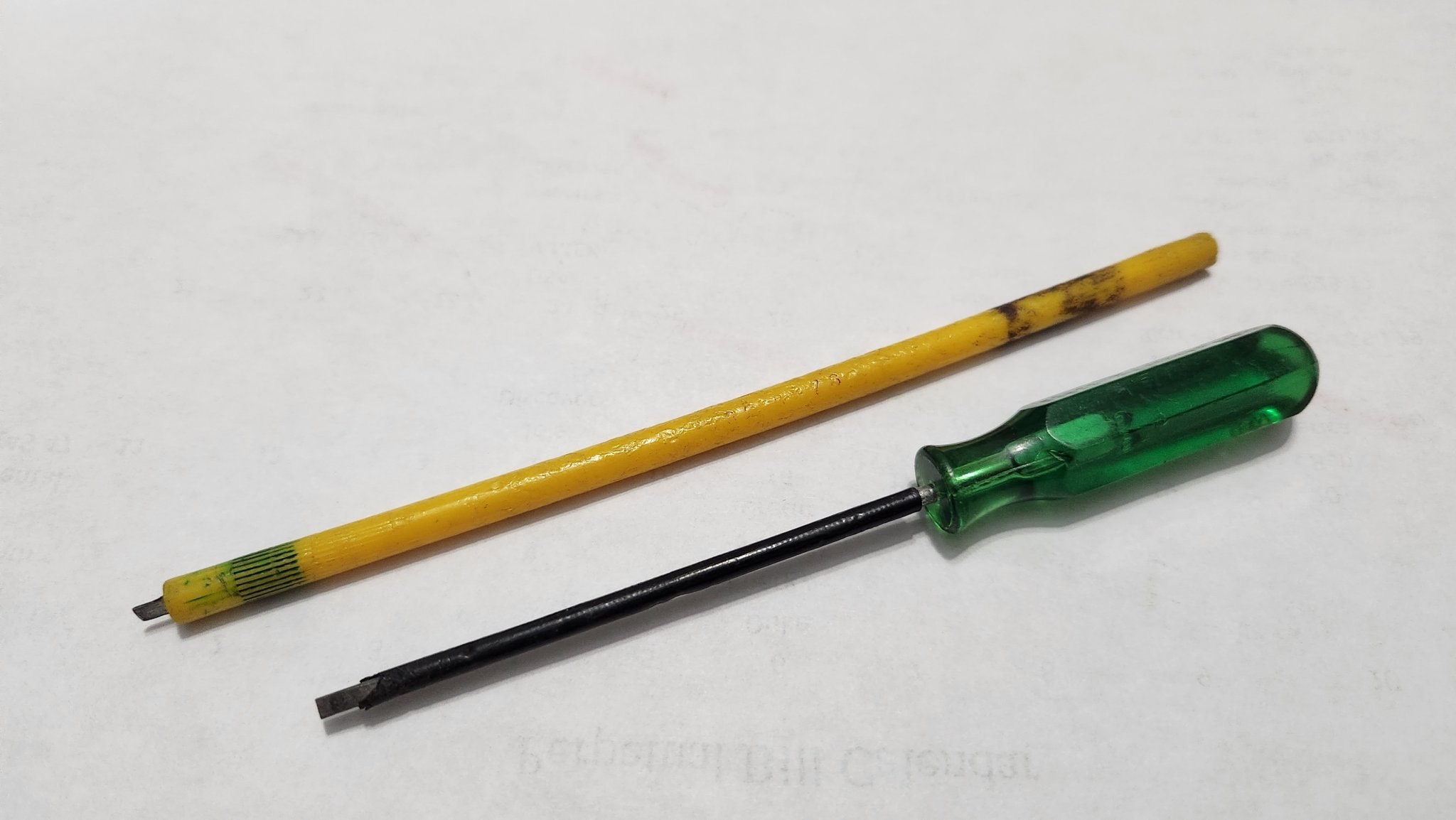

Besides a couple of odd bits/tools I’d picked up over the years, like a Bournes trim pot adjustment tool (H90, although H91 is good to have on hand), I bought this set off Amazon a handful of years ago:
The point to using “non-metallic” alignment tools is you want something which doesn’t conduct RF or static such that you become part of the circuit you’re working on.

Many of the tools have a bit of metal at the end as some of the trimmers (like small rheostats) can be a bear to turn and have metal screws themselves with chew up the plastic part of the tool. This doesn’t affect the alignment procedure.The point to using “non-metallic” alignment tools is you want something which doesn’t conduct RF or static such that you become part of the circuit you’re working on.

Let me say that I'm not cheap but I am frugal. OK, I'm cheap. Now that you explained what the reason is for the plastic alignment tool it brought back a piece of my memory. I found the alignment tool I had from many years ago and also found one I made when I was in a bind at a customer's site.
My yellow alignment tool was too big so I took a smaller common head screwdriver and melted some heat shrink onto the shaft to insulate me. That tool has been in my tool-case for about 4 decades. I included a picture of my alignment tools.
The Trimmer Cap is supposed to be here tomorrow so I'll know whether they do the job or not. I can see where the screwdriver can still have an antenna effect so I hope the yellow one fits. If not, I will buy the tweaker you suggested. Thanks again.

OK, now I'm into it. I received the part and wow the leads are short. In the old days the components would come with long leads and you would put them through the holes, solder them, and then clip off the excess. No "excess" here!
Anyway, on to more important stuff. My unit failed intermittently so it is actually still working now. I wanted to see what the readings were between TP3 and TP4 before taking out the original CT104 expecting the reading to be approximately 3V when tuned to 87.5MHz and approximately 23V when tuned to 108MHz but it was not the case.
My unit measured 5V when tuned to 87.5MHz and 21.4V when tuned to 108MHz with the original components.
So, this question is for an expert if there are any out there. Do I insert the Trim Cap and follow the directions in the service manual or do I adjust it to the readings I got from the working unit before removing the original? I realize that the intermittent component MAY be affecting the readings, and the new component may put different characteristics into the circuit. Then again, maybe they are better for my unit IF that is what it came out to be when it was set up at the factory with all their equipment. I only have a Digital DVM.

Things are looking really good.
The part arrived and it physically looked like a good replacement for my component.
I opened the pre-amp this morning and (since my problem is intermittent) I took readings from the test point under the range of frequencies they recommend in the service manual. They were off but fairly close. They may have been off because the component was failing and out of spec. Anyway it is supposed to read ~3V @87.5MHz an 23V @ 108MHz. They read 5V and 21.4V respectively.
After replacing the Trim Cap (CT104) I measured the 108MHz voltage first since that is the one that calls for the Cap to be adjusted and it measured 33V. I tweaked the Cap until the reading came down to 23V and then checked the voltage at 87.5MHz. It was right on at 3V without touching it. So, as soon as the new Cap adjustment brought the high end down to 23V, the low end came into alignment automatically for me.
I put it all back together and tuned all the FM presets and it is working like an amp! (play on words for “working like a champ” pun). Rock on!
