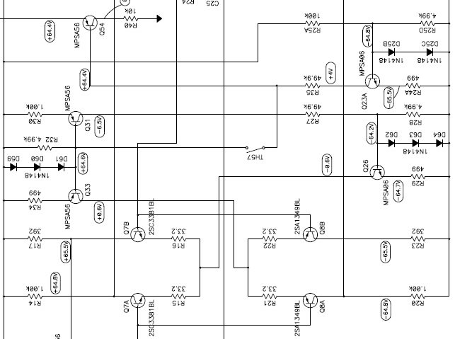

I have checked resistors around the input pair transistors - R14 (1.0k), R15 (33.2r), R16 (33.2r), R17 (392r) as well as R20 (1.0k), R21 (33.2r), R22 (33.2r), R23 (392r)
One anomaly, likely just me not understanding the annotation on schematics:
Both schematics I have located, show R17 and R23 as 392, which seems to be value code for a 3.9k resistor. However, checking resistors on the this channel and other channels, and the resistor color bands confirm 392r, with Orange - White - Red - Black - Brown (392r 1% color band code)
Would there be any other culprit of a high, unstable DC offset outside of the NPN, 2SC3381 (BL) and PNP, 2SA1349 (BL) dual BJT package transistors? Would the DC being negative point more towards the NPN transistor being faulty?

Hi bullittstang,
The clarity of the jpg is much better than the pdf. Any chance of a zoom-out spanning R6 through R9 from the jpg source?
I would first capture some bias voltages. With black meter lead at ground, what are voltages at R6, the feedback node (junction of R9 and R24), voltage at C25-R24 node, and amp output at R9 ? Any DC voltage across R24 is evidence of leakage through C25; any voltage across R24 will contribute output offset amplified by ratio R6/R24 = ~28. You might be able to observe transient voltage across R24 if C25 leakage is the culprit.
Other defects are possibilities, but these measurements may suggest where to look next.

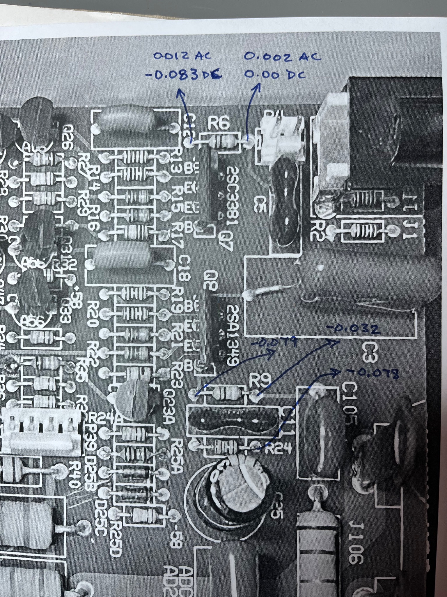

Took some measurements at the points you mentioned.
R9 - left side, -0.083dc and 0.012ac. Right side, -0.00dc and 0.002ac.
R9/R24 node, -0.079dc
R9/output node, -0.032dc
R24/C25 node, -0.078dc
Included pic of PCB with voltages written.

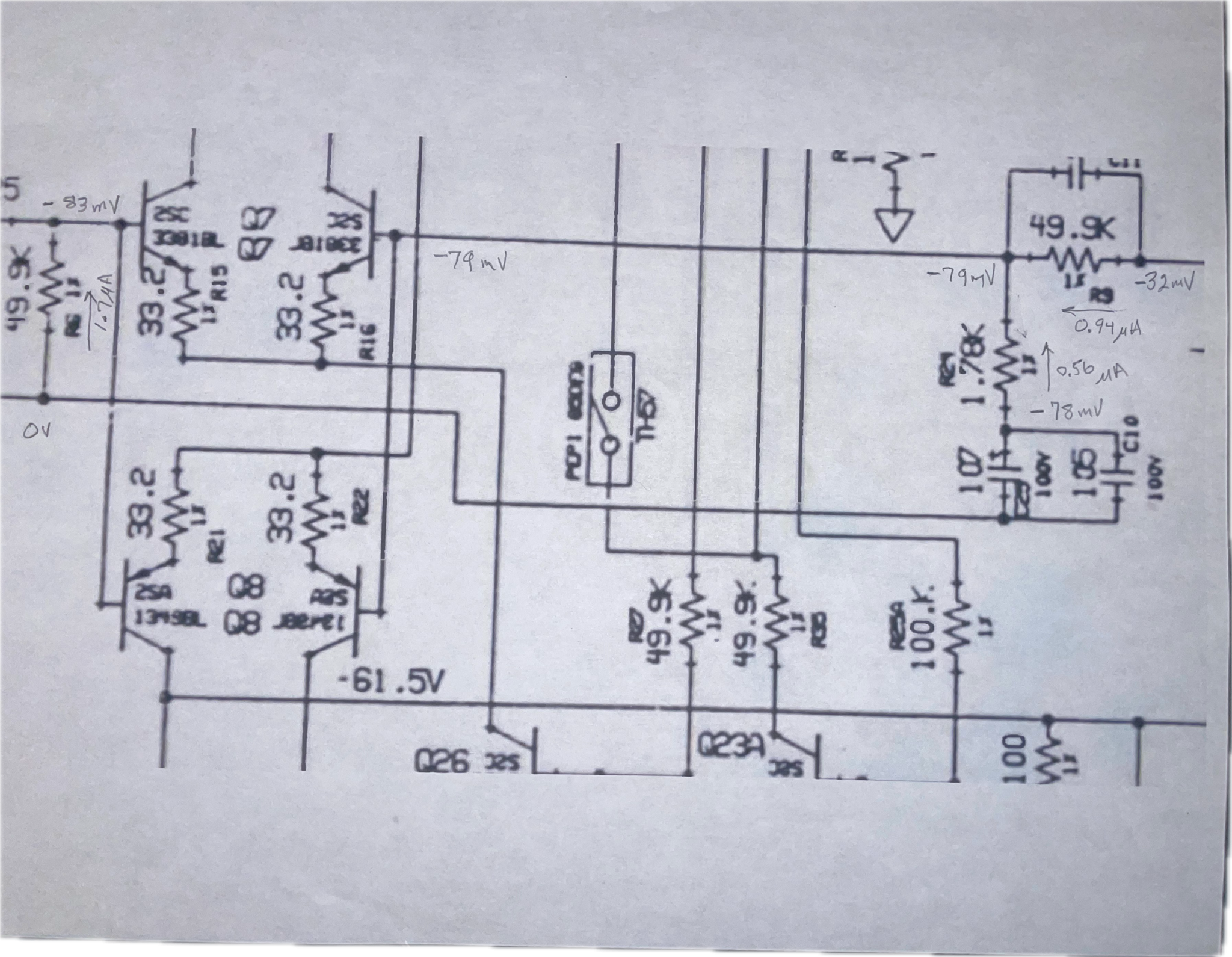

With the bias measurements I mentioned, we should be able to estimate bias currents and gain insight to where the problem lies. 30mV offset isn't bad, but the settling behavior is suspicious. Maybe you can catch initial transient when behavior is most aberrant. input transistors are chief suspects. Bias current can often point the way.
Cold shot is a good exploratory tool. With a bit of practice, you can drip coolant almost drop-by-drop onto each suspect transistor. Compare with the good channel to develop a sense of what's normal behavior.
Sorry for my poor technique below. I've noted measured voltages and derived bias currents.
The results look reasonable, so you may have to investigate these same measurement points during the turn-on transient while the misbehavior is more evident.
Note that there appears to be about 1mV across R24, but the accuracy may be questionable since you may be limited by the resolution of your DVM. Try measuring directly across R24, testing with both meter polarities to try confirming that the voltage drop is actually present, and not an artifact of subtracting two resolution-limited readings. If there were actually 0.56uA flowing, it would account for about 27mV of the offset seen at the output. But this error isn't very significant anyway.
But the 500mV to 800mV power-on offset is irksome, especially if it settles slowly in comparison with the other channel.
There are lots of possible culprits, including any of the four input transistors, C25, and other less probable defects. Because it's an easy test, I would try removing C25. Presence of C10 will keep the amp stable. If C25 is at fault, the amp will settle very quickly with good stability when it's removed. Of course you have to restore C25 for good low frequency performance.
Let us know what you experience. We can devise other troubleshooting experiments.
Good luck!
