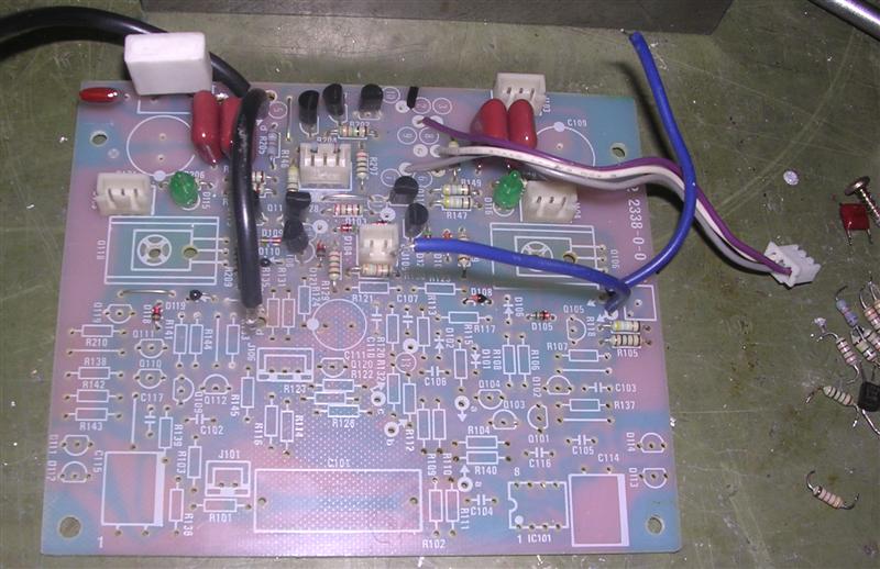

Hi Glenn,
The op amps are fine for that amp. The capacitors used should be fine of course.
Now for the fun stuff. You can always tell how a servo is working by checking the voltage on the output. If it's railed the proper way to correct an offset, the problem is not the DC servo. If, on the other hand, the output is not the correct polarity to fix the offset - you do have a problem in the DC servo somewhere. You could always pull the op amp out to see where the output will sit - uncorrected (by servo action). Some Adcom amps will have a substantial DC offset with no servo action because they were designed to use the servo correction. A good look at the schematic to see what the diff pair looks like will tell you the answer to that question.
You can always check the voltages on the input pins of the servo and then check to see if the output voltage makes any sense as well.
It does appear that this amplifier has been repaired before, so the next (and obvious question) becomes "was the repair done properly?". I have had to redo repair work often enough so that the first place I check is where the earlier work was done. Saves a lot of my time. The fact that you have DC offset wandering around seems to point to an incomplete cleaning job. Perhaps they forgot to clean the parts?
I would start from scratch and assume nothing was done. Make sure you clean everything. I'm going to bet you have assumed that a proper job was done, when in fact something has been missed.
Now, have a look at how far I've had to go on this one so far. All I have done so far is to remove the components in the areas where there was fluid confirmed, then quickly wiped the PCB surface. Next on the hit parade will be flux on the traces and pads, followed by solder wick to remove all excess solder. After that, flux remover with tooth brush and inspection. Only after I do these things will I begin to really clean the PCB. Testing the components for damage follows a wash cycle for these parts. Only after I am sure that all this evil stuff is gone will I begin to reassemble these boards. I will also take this opportunity to match the differential pair and any other pairs that might benefit from matching.
I practice what I preach, no matter how much it hurts some times.
Good luck on this one, Chris

Hi Glenn,
If you heat up the solder on a component, you can hear a hiss sometimes, but the odor is the real clue. Then, remove parts a little past that to be sure. This one is bad, but it looked all original. If the bottoms of the capacitors are pretty wet, you can be sure the fluid has gone traveling. The caps on this one were soaked with drips on them. 🙁
You're right, a lot of work. But, the best thing to do is not to over think it, just do what you know needs to be done. If you think on it too much, you will either not clean back far enough, or you'll never start. Just nut up and do the work.
The ultrasonic cleaner is great for knobs, screws and any mechanical parts that need cleaning. As I've said before, your wife will love it, it cleans jewelry extremely well.
-Chris
-Chris
