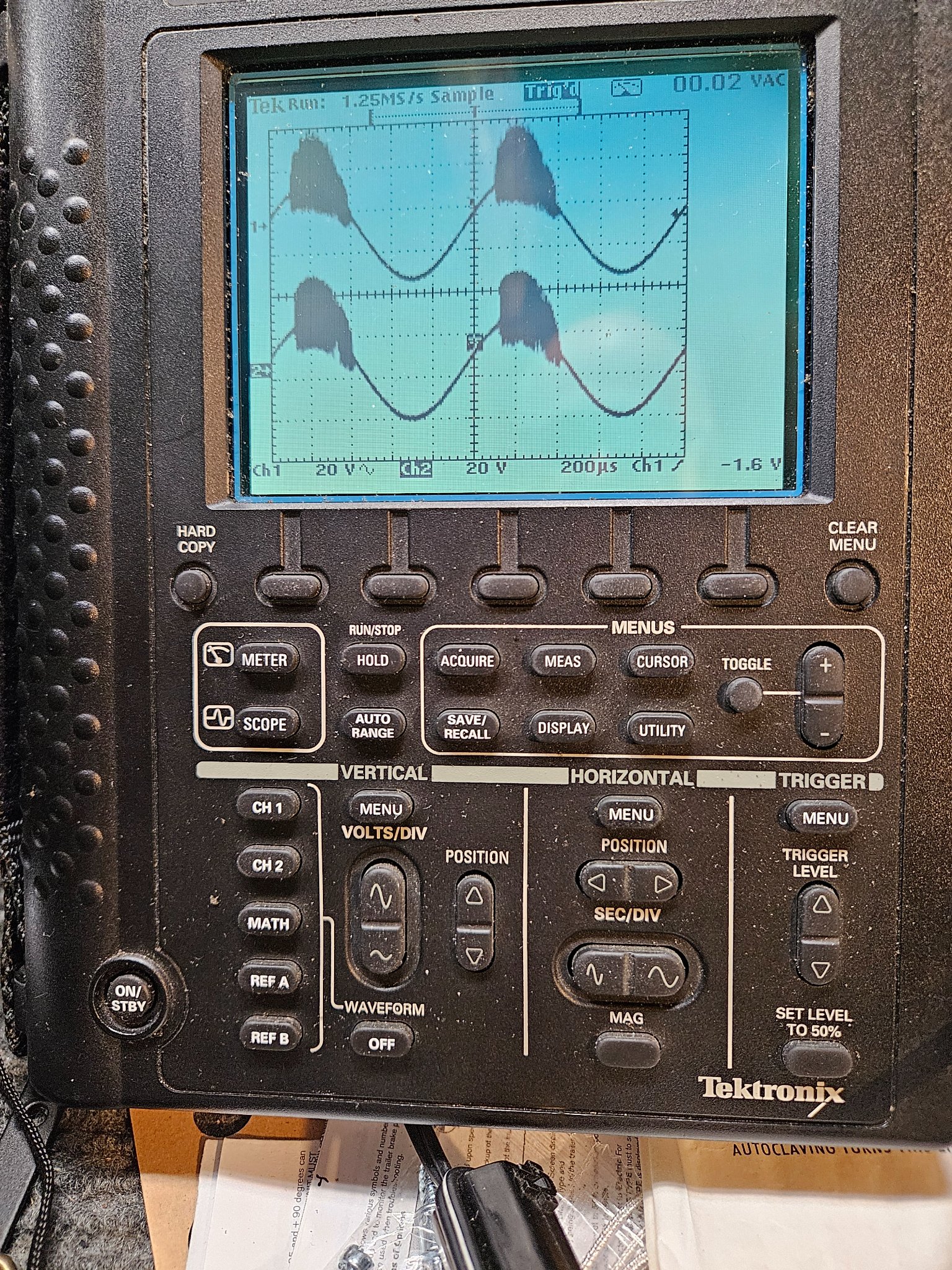

Last week I bought a 5800 amp. During the demo in the seller's home the unit sounded good and I had no suspicions so I paid him and lugged it home.
I had read that bias & offset can be an issue with these so my test bench was it's first stop.
I noticed an oscillation on only the positive-going half of each sinewave, but only when turned up to 10 watts or more.
The amp is capable of full output from both channels, but the oscillation makes my load resistors whine.
What would cause this audible ringing at high output, only on the positive half of the signal?
The rail voltages were right on spec.
Bias & offset were adjusted to spec after a LONG heat soak. I can verify what others have written that this amp drifts until it's good & hot.
The fan speed is proportional to the temperature, and bias is very sensitive to temp. It's a delicate balancing act.

Does it do it without the current meters connected? The long wires might cause that.
You nailed it!
I made the wires special to do the bias & offset in both channels at the same time. Since I have 2 meters this saves time. I kept the wires short & fat but never imagined it would still affect the signal.
Signal is clean at any level up to clipping at >300wpc.
