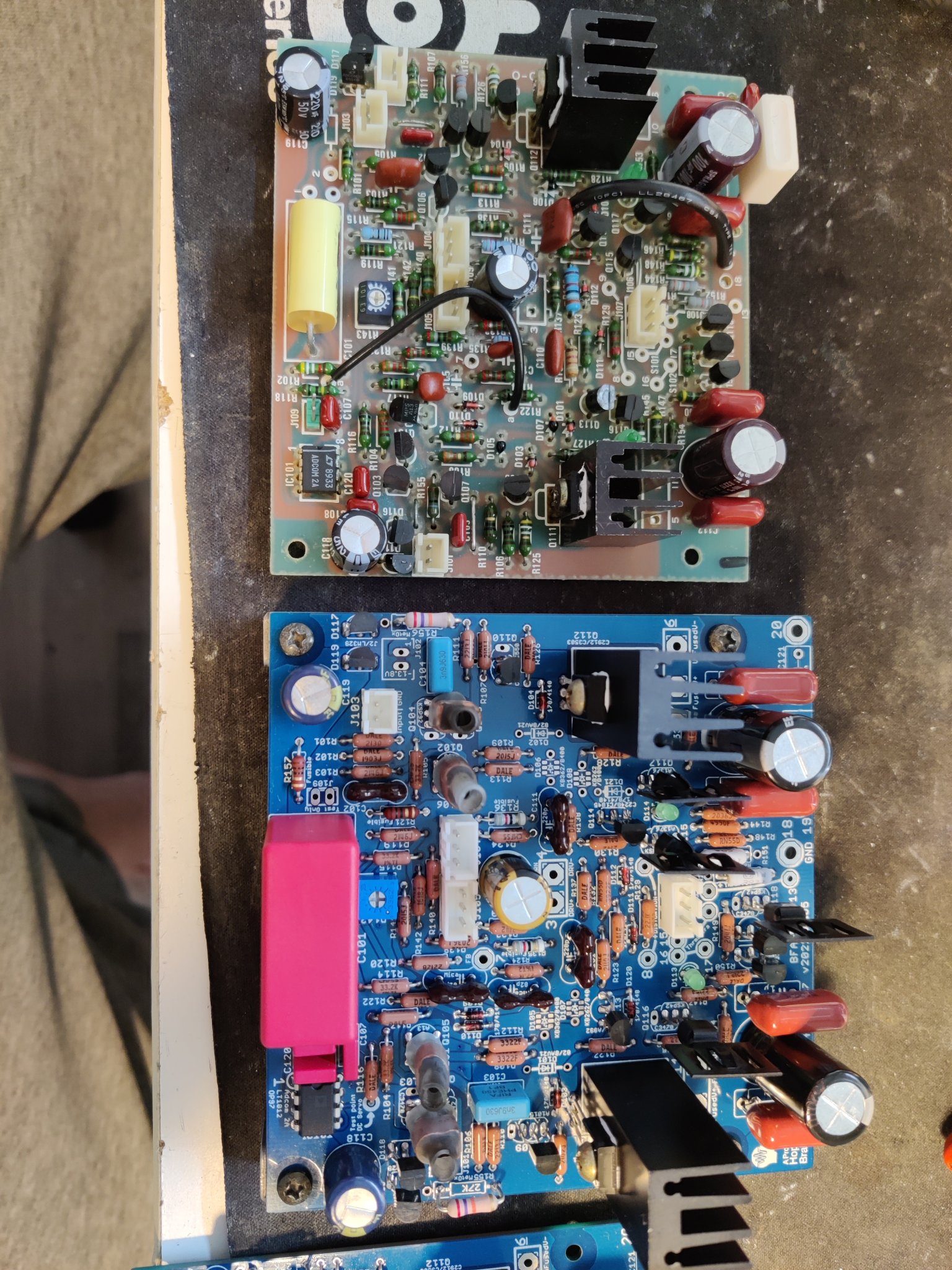

Got a pair of monoblocks from Advom that had issues when i bought them , and after some research i found that the main reason they fail is due to leaky capacitors on input board.
I opted to order new boards fom Hoppes with matched transistors , and then built / populated the rest on my own.
First amp had an offset of - 166mv , and after some reading on hoppes brain notification notes i found that the input board i built was working as intended.
Dc servo was well within specs along with pin 3 and 4 , so the issue was likely to be downstream.
Took out the output assembly where i checked all components , and only found 2 resistors to be drifted slightly....one that was 8.5 ohm (should be 7.5ohm) , and one that was 66 ohm (should be 68 ohm).
Changed the 2 resistors , cleaned it up and put it together...worked perfectly now with dc offset around single digits millivolts 🧐.
Did not really feel i found the issue on that 🤷
On the next monoblock i powered up slowly with dimbulb / variac (did same on first monoblock) , and had dmm on testpins looking for bias current and dc offset as i increased.
Seeing bias current but also alot more dc offset than the first amp.
Tried with full current on dimbulb to see how mutch offset , and it was - 3.2v.
Pin 3 and pin 4 on input board show correct voltages along with dc servo current.
Took apart the output assembly on this amp aswell ,.and found 2 resistors (same as first amp) to be slightly off and changed them.
Seem one or more of the output transistors is weaker than specs suggest (2sd424) , having hfe in the thirtys (hfe 34).
Could some weaker transistors be the reason of the offset i am seeing?
Datasheet say minimum hfe of 40

The Hopps boards are rebuilds, so the attached service is an accurate reference?
It's unlikely low beta would be responsible for output error of a few Volts. Is the -3.2V voltage you mention above in the first post the servo output voltage, or output voltage of the power amp?
If -3.2V at PA output, on IC101, would you measure supply rail voltages, and IC101 pin 6, base Q101, base Q105, and output voltage.
Update:
Both amps is now working. Sub 5 mv offset on both amps.
Culprit of negative dc voltage on second amp was a faulty capacitor that has been added in the positive terminal by someone before me.
Now the last issue is speaker pop while power on and power off , and i belive the main reason is due to mismatched outputs.
Any pointers to speaker relay circuit i could add here?
Tried to change capacitance on soft start circuit to see if it would change anything , and yes it sure did.
C504 220uf and tried 470uf...way softer pop , but still strong.
Also bypassed powerswitch without any improvement.
Now i am out of ideas.
