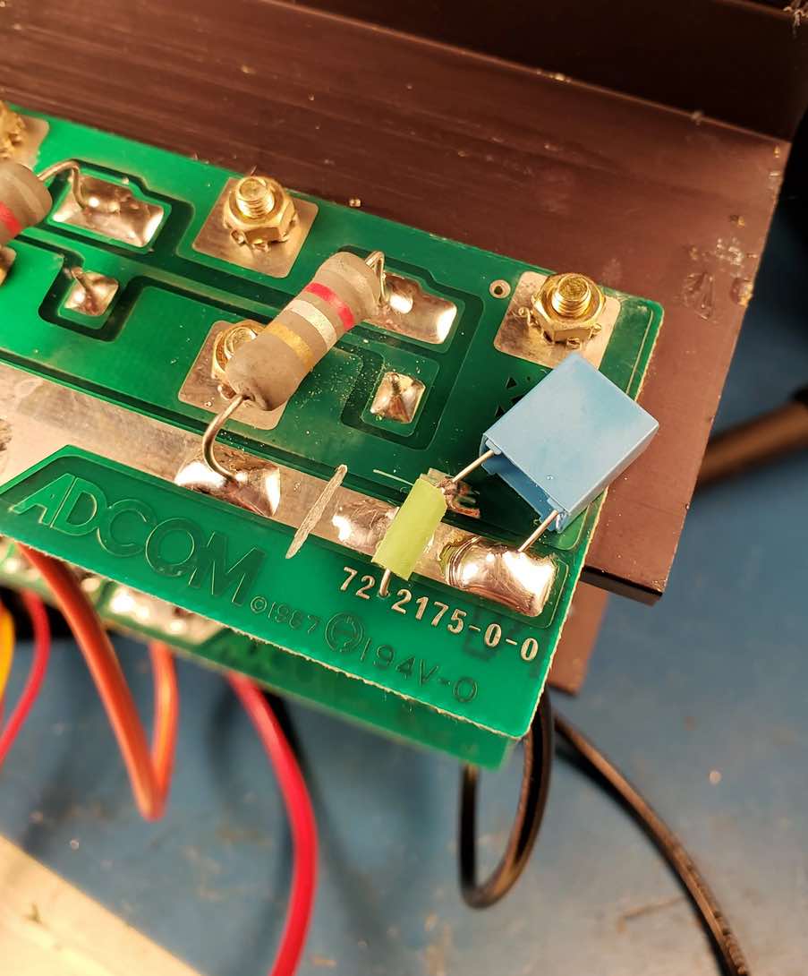

adcom Bypass cap installation on output PCB
Someone commented on this photo by Hoppes' Brain a while ago about a way to install bypass caps on the Adcom GFA-555 output PCB. They wanted to know what the connections looked like on the other side of the board. Does anyone have a picture , I'm curious myself , thanks

Here's more detail on that bypass capacitor connection. There is a little extra PCB trace on the end of the trace that connects all the emitter resistors. I make a cut to isolate it, and then use it as a ground connection for the capacitors and the wire that connects them back to star. I put a piece of insulation over on of the capacitor legs so it can reach across the trace without shorting. Just make sure you get those polarities right. The picture shows the PNP (negative) side, so the negative lead of the capacitor connects to the negative trace where the collectors connect, and the positive lead goes to the new ground connection.
