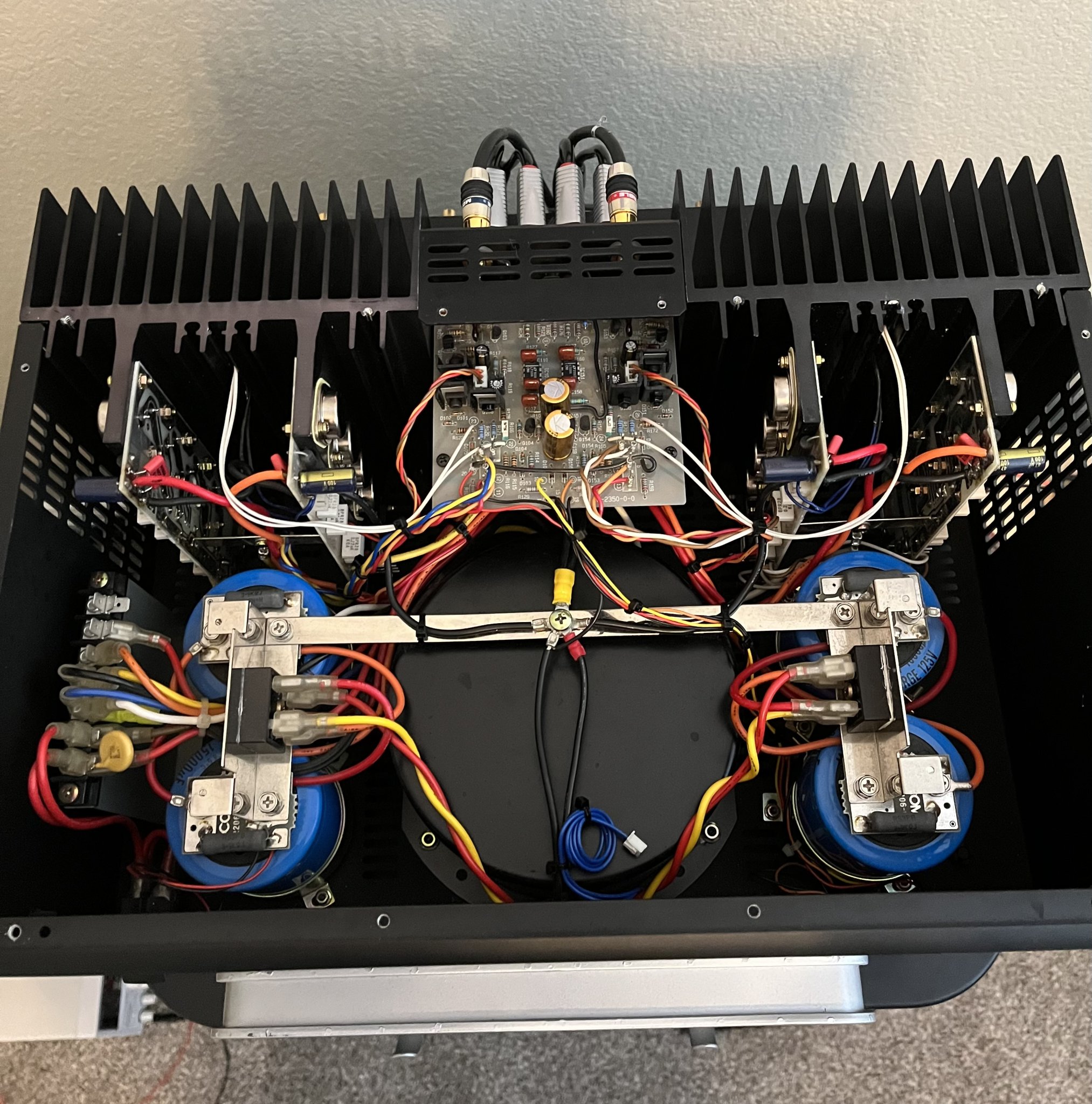

DC offset progression:
Start-up = -4V (maybe 1/2 sec), Drops to ~50mV immediately (1-2secs later), Steady drop to ~20mV (30-45secs later) and finally drops to ~1mV (~10-12 mins from turn-on). All of these are lower, and drop faster with less fluctuation than it did before changing the input pair.
This seems normal, I think you got it!

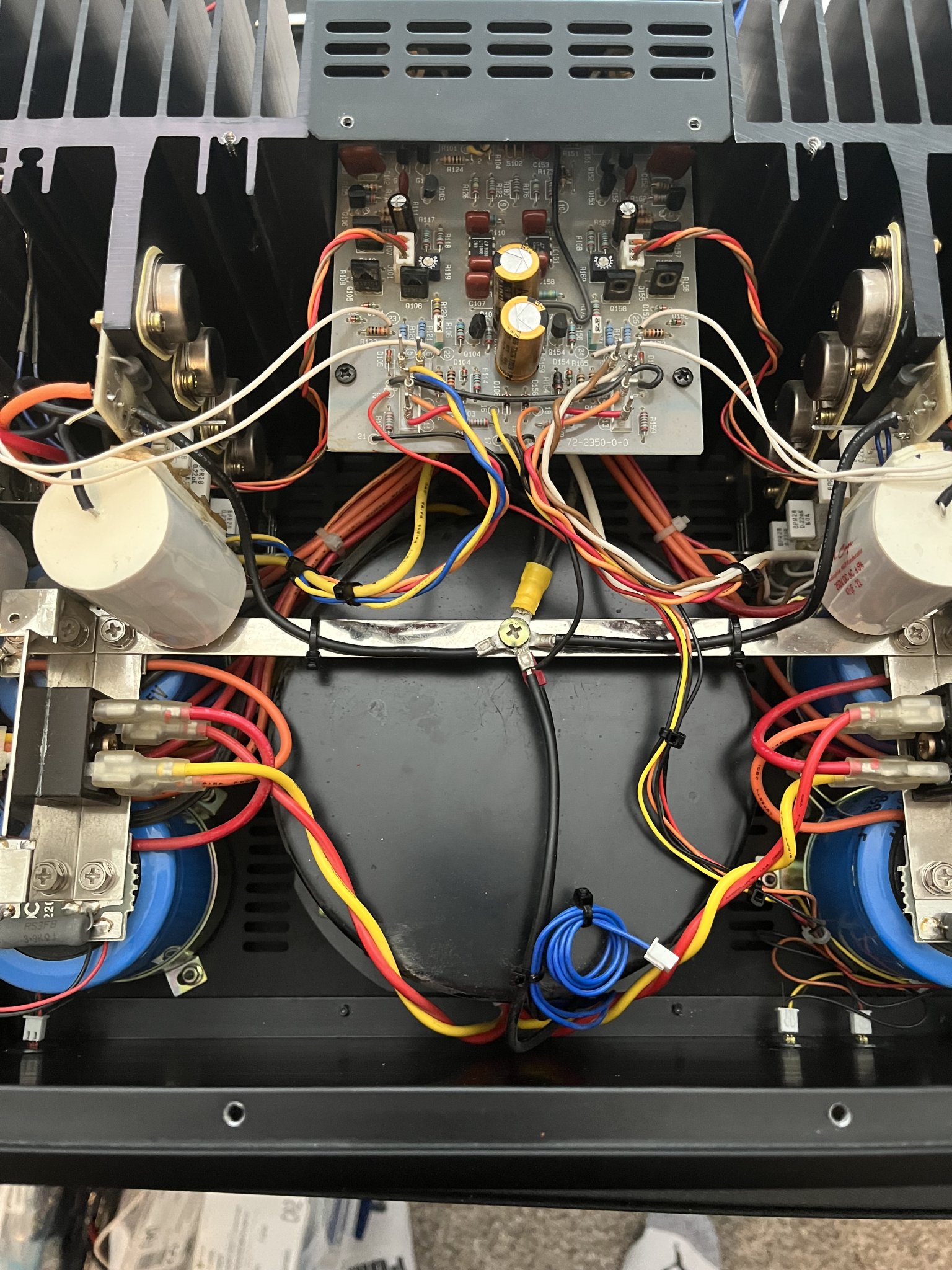

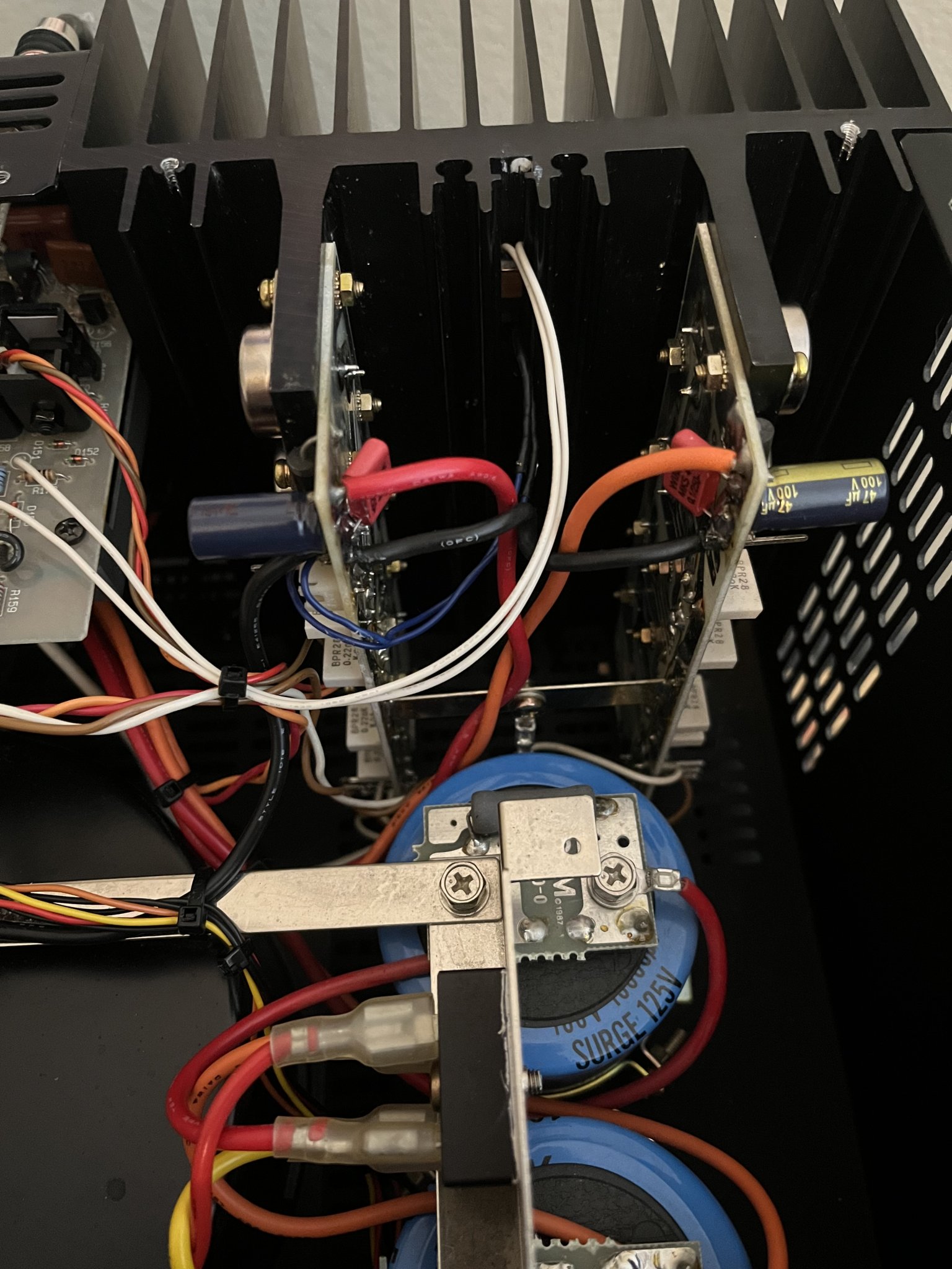

A couple things I recommend while you're in there... The to-126 transistors on these run pretty hot, and sometimes the solder joints crack from the stress. Re-flow the solder joints. You can attach small heatsinks to them and they won't ever be a problem. The heatsinks should be small and light so they don't stress the component leads. They only need a little more cooling.
The electrolytic supply bypass caps on the output modules are under a fair bit of stress. If you have the mini-marshmallow-sized 47/100V caps, they may be blown by now. Sometimes there are physically larger Panasonic 47/160V caps here and they're fine.
Check your bias-compensation cable headers and plugs for corrosion. When these go bad, the bias-spreader circuit goes haywire. Replace with any good 0.1" header/pin system. If you want to go fancy, Molex Nano-Fit, but it's tricky to solder the pins to the wires.

Thanks guys @anatech @Phloodpants and @bigskyaudio you have all provided insight, guidance and specific parts to get this beast back in running order. At this point, I think I might keep this amp for a while, so fixing/replacing everything on both channels seems worth the effort and expense.
Here's some pics, two as it was originally and three showing it's current state.
