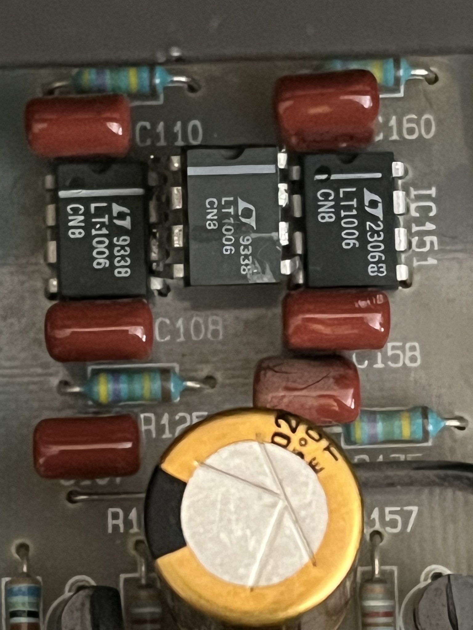

Current Issue - on Left Channel (originally working channel)
I am getting high DC offset at startup, and servo circuit seems to have trouble getting back to 0.0mV. Spikes high DC at turn on, I've seen as much as 5V but immediately goes down to 30-50mV for a couple mins, then it levels out at 1-2mV and seems to work fine after that.
After repairs/upgrades both channels started-up and bias easily. Followed the service manual process of setting bias and it all went without a hitch.
Is it possible that IC101 for the Left Channel is also bad? I didn't replace it, because I wanted to save $6, and didn't seem to be faulty when I first tested the amp with a faulty Right channel. Are there other resistors or diodes I should check? (thought I checked everything on the pre-amp board)

I'm using this link to view schematic: http://akdatabase.org/AKview/albums/userpics/10004/Adcom GFA-555II Service.pdf
IMHO, the servo design is inadequate. Check voltage at pin 6 of IC101 and compare with IC with IC151. I predict both outputs will be near ground but with IC101 stuck on the ground. I further predict that if you wait until the bias settles to 1-2 mV as you described above, the IC101 will unstick from ground but still be just above 0V.
It would be better if the ICs were provided with bipolar supplies. If you confirm my suspicion, we can try a relatively easy remedy.
Here are the voltages - using speaker ground.
IC101 (bad channel) - spikes to 6V, then immediately comes down to 4.6V and slowly decreases over 5 mins to 3.960V
IC151 (good channel) - spikes to 6V, then immediately comes down to 4.4V and slowly decreases over 5 mins to 4.089V
I checked these voltages previously and couldn't see anything conclusive - hopefully it means something to you

Well, that puts a bullet in my servo deficiency accusation. The bias resistances into the input pair (R104 and R124) are dramatically different and would yield a negative amp offset error if not for the servo correction; so I retract my previous assertion. The servos should force amp offset errors to a few mV immediately and remain there; there shouldn't be any 5 minute stabilization period required. Drift of the opamp output is normal as the servo accommodates PA drift.
However, the opamp offset errors (difference between pins 2 & 3) seems unusually large, so I am suspicious of the opamps. I suggest measuring differentially between pins 2 & 3 for a more direct measurement of opamp offset error. Any voltage larger than 10mV would be excessive.
Rather than buy replacement opamps from Adcom, I'd get a couple of TL071. Replace IC101 first, and then IC151 if you're pleased with results.

Unsure what you mean by "I suggest measuring differentially between pins 2 & 3 for a more direct measurement of opamp offset error."
Do you mean use DMM probes on pins 2 and 3? Once I confirm the specific measurement, I can check this and see if it sheds light on the problem.
I did go back and measure every resistor and diode again, comparing to the schematic and to the other channel - nothing is out of spec.

Well, that was anti-climactic - I measured both ICs across Pin 2 and 3, not sure if this tells us anything, because both channel look to be working.
IC101 - spikes to 180mV then within 7 secs settles at 0mV
IC151 - spikes to 175mV then within 7 secs settles at 0mV

2) What part number were the original servo ICs? They should have been ADCOM 3A or sometimes LT1006. I believe your servos are working but there is a possible imbalance somewhere.
- they were both LT1006 ICs, but the left channel looked like a fake (laser etched not printed), so I replaced it. (See pic below - middle is possible fake I removed so you can see all three)

The original servo IC was probably fine. It does not have to be a fast high speed opamp for the job it has. I wonder why someone would counterfeit an LT1006 as it is not exactly a high profit part.

Do you have any thoughts on BSST saying I could use a TL071P as an IC substitute (since I have those on hand)? I would probably put in a socket, if it doesn't work well though.

@BSST thanks for the education on the circuit and the inner workings, still over my head to do all of that just looking at the schematic..
I may still replace IC101 - because I still can't understand why the right channel (IC151) is straight line, no fluctuation from start-up spike to <10mV in 5-10secs and then very linear down to 1mV within 1-2 mins. Bothers me that the left has much higher DC and fluctuates for a few minutes before settling and then takes 10 times longer to finally get to 1mV.
I have been listening for a little while and it does sound great - no issues with the sound. Probably more my OCD than a real problem, IDK.

It's hard to imagine anything other than IC101 as the culprit, but there's one last test you could try for confirmation.
Note that R175 and R177 sense ground and the amp output, respectively. Use your voltmeter to probe directly on the resistor leads. You should see exactly the same behavior on the resistor leads as you observe across the speaker terminals; it's another way of saying there should be no voltage drops between the resistor leads and their respective ground and output connections. If you see any differences, it's an indication of a marginal connection or unfortunate PCB trace routing.
If you ultimately try a TL071, a socket seems like a good idea. Also, confirm about 20VDC on pin 7 of the IC. R179 provides very light supply current. You could tack in an additional 33K in parallel or other remedy. The C159, R179 time constant seems lengthy, an unimportant curiosity.
